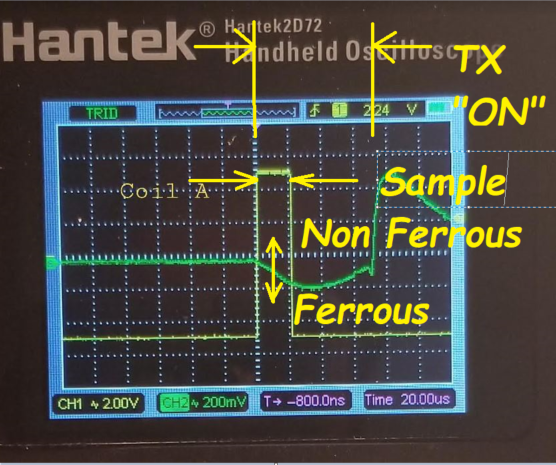

      Hi GeoMax,
      I will try to explain how works the discriminator from idea from Sascho from year 2008. First, this schematic haves only DISK channel. Also the sample from RX coil is taken during TX pulse like DFBowers suggests. Also DFbowers suggests for duration of RX sample to be in range 20us-30us as starting point ( see post #10). In this schematic both condition are satisficed. The duration of RX sample is appr. 25us and the RX sample is taken during TX pulse. Because as RX pulse is used the TX pulse - the duration of TX pulse is also 25us. Further, R13 and C10 works as first integrator. R18 and C13 works as second integrator. As attached picture from DFBowers, for ferrous targets the signal of the output of the second integrator will be more negative and for non-ferrous targets will be more positive. Here is very important to set working point (output voltage of CA3130) by P2 and P4. Without target the level of the volume of the sound (700Hz) have to be set at middle level. At ferrous target the level of the sound will decrease and for non-ferrous target this level will increase. This schematic is far from perfection - but this is very early attempt to use IB coil in amateur developed PI MD for discriminate of targets.

                Hi GeoMax,
                Thanks for the explanations... This helps to undestand how it works.
