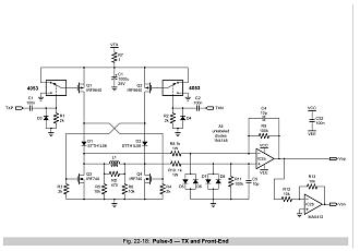

      • #78
Name:	BiPolar PI a.jpg
ID:	433306 If Carl's bi-polar TX were added to the scheme, it would be even better.

          • #80
            Hi algan,
            Using of bipolar TX pulses in this idea will need for very big changes in the project.
            • #81
              Hi Algan,
              Carl's bi-polar TX is nice, but way too complex for this circuit. As Detectoris#1 already wrote, quite a lot of changes to the circuit are needed. Carl's bi-polar TX circuit is probably better used with a microcontroller board.​
              • #82
                All you need to do is run the TX without a 4053 with some kind of mosfet driver, you only need two input pulses. Carl will tell you what parameters they are, can it be programmed further with a simple microchip, why does the circuit need to be changed further?
                  With a little modification it could work.​
                  • #84
                    Hi nejdet,
                    The modification of DFBowers' "MPS-pi-iron-discriminating-metal-detector" schematic for use of bipolar TX pulses is not only concerned with generating of these pulses - this will need modification of the DISK channel.
