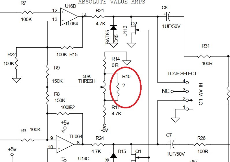

                    Hello, colleagues, first I will build the sound part to test it on a surf master, but what value do you think this resistor is? Thanks Click image for larger version

                      That resistor was not soldered on the pcb when I drew the schematic. Just use the 50K pot.

                        Thanks Altra. I also want to ask about the LM385, how many volts should it be? And one more question, the TX pulse of the TDI high is 100 uS, and how much is the low?
                          The LM385 is adjustable, when V-adj is connected to the anode the voltage would be 1.24v at the cathode. See the datasheet. The Tx off time is adjustable based on the Tx frequency. With a frequency of 3khz a full cycle is 333us, so the off time is about 233uS.

                              Hello, colleagues, first I will build the sound part to test it on a surf master, but what value do you think this resistor is? Thanks Click image for larger version  Name:	zzzzzzzzzzz.jpg Views:	210 Size:	74.2 KB ID:	441733
                              This resistor is designed to reduce the value of the potentiometer to bring the threshold within normal limits. Its value is established experimentally.​
