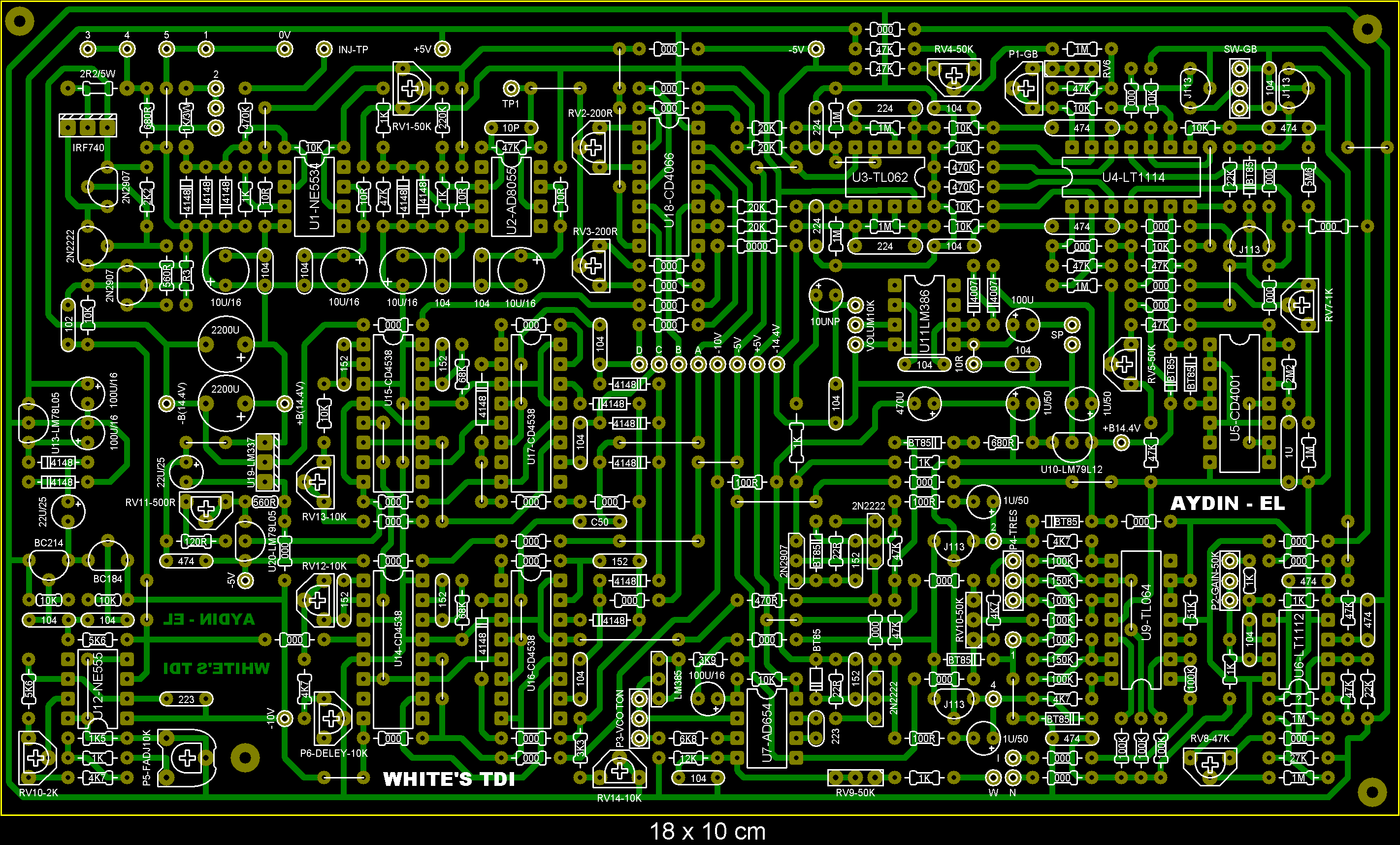

        TDI PCB with Proteus
          Like I mentioned above the schematic has some mistakes still. A major error I discovered a few days ago is D18 in the voltage doubler. The way it is connect in the schematic and on your pcb the whole circuit will not function. It will not generate the +5 volts. Google diode voltage doubler and compare to the schematic

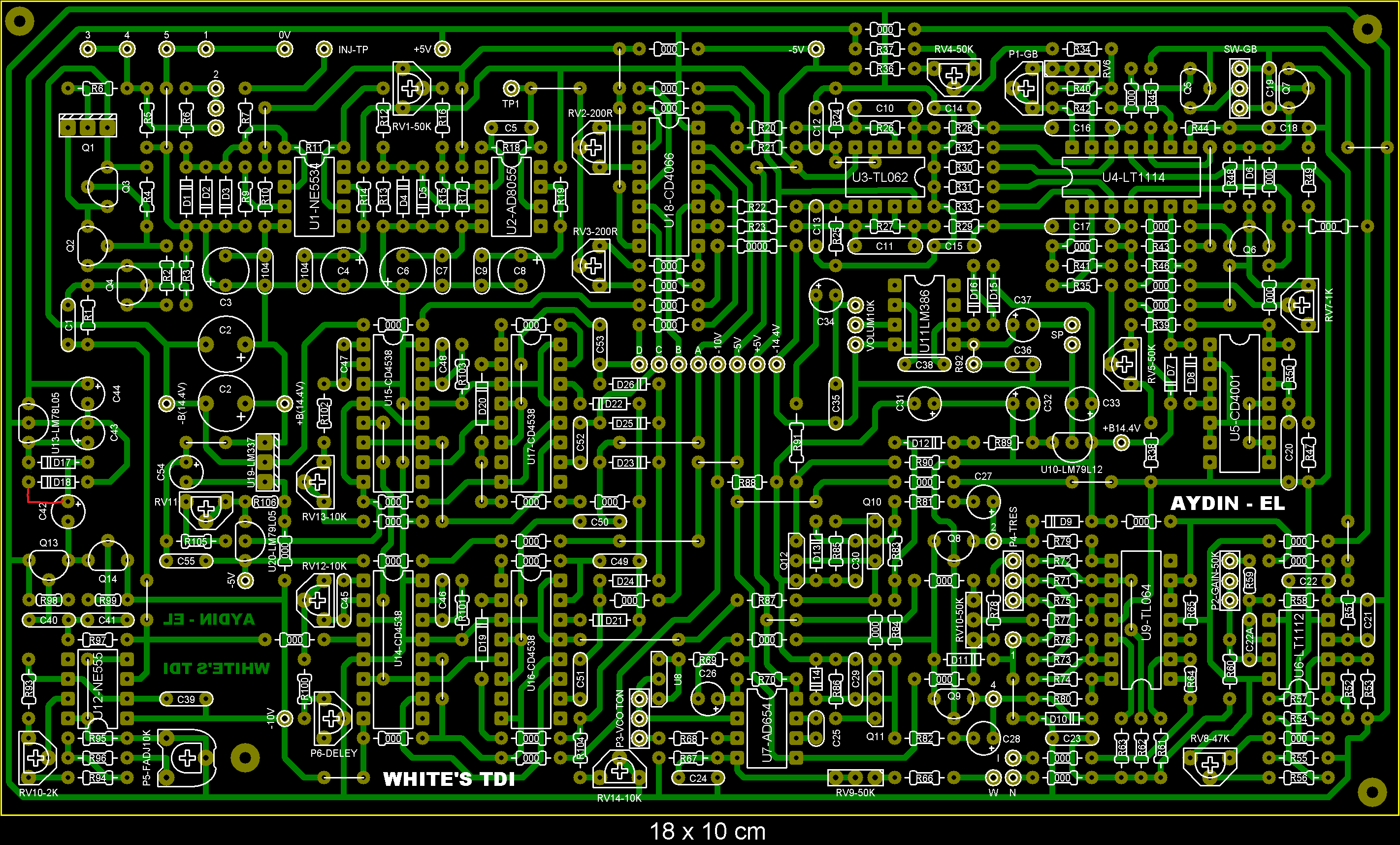

            Attached is the picture of the PCB with correction of the connection of D18
              Correct Detectorist. Also R6 the series resistor going to the coil is only 0.25 watt on the pcb. This will burn out right away. I think the minimum should be 2w or higher.
                Correct Altra. Average power on this resistor is appr. 2.5W. Also, serially to D8 is correct to put current limiting resistor 10K. Also C35 no need to be Not Polarized type. The marked polarity on the board is correct. The resistance of the speaker have to be not less than 32oHms for not overheating of LM386.

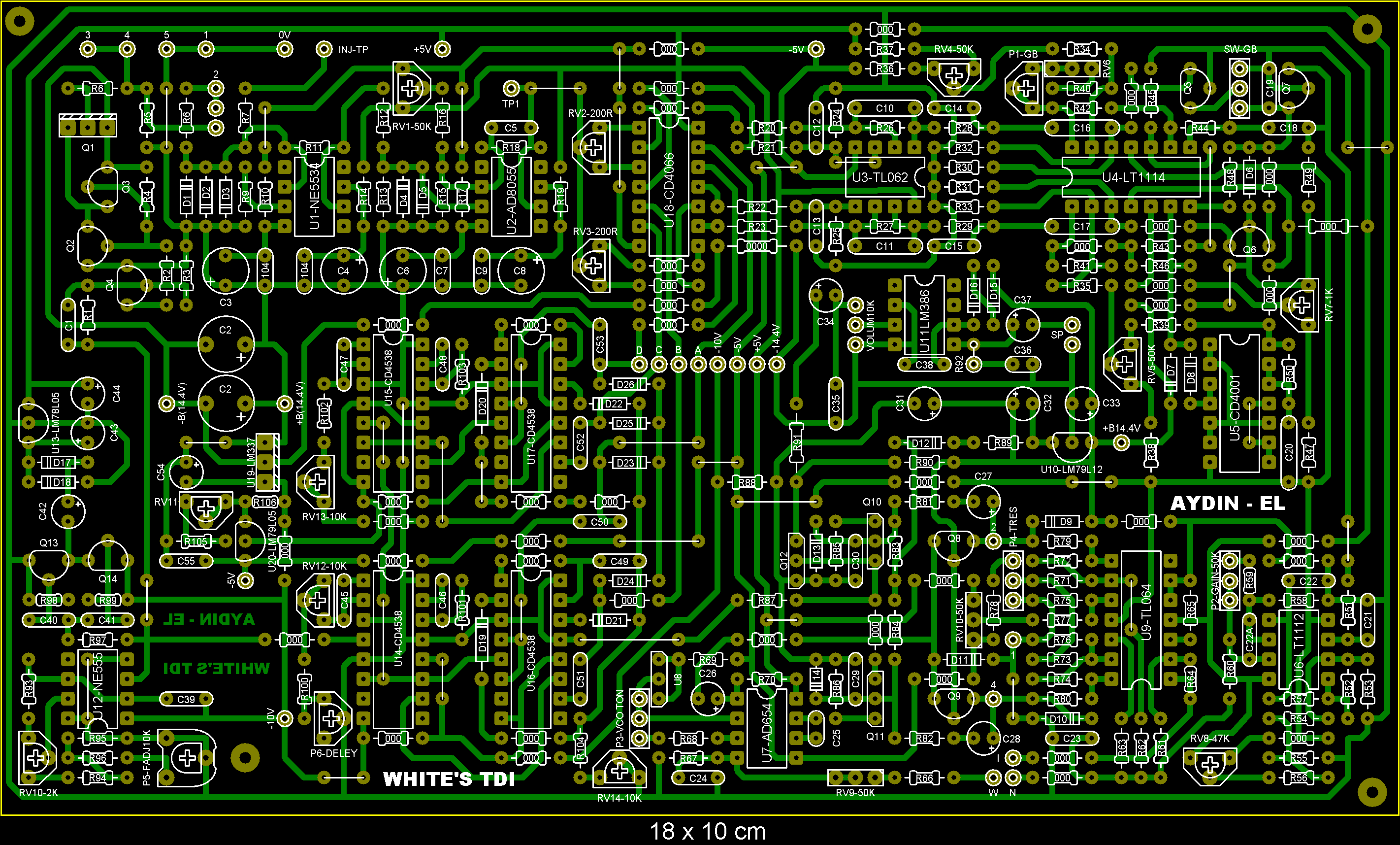

                  Correct PCB
                    PCB with Part Number
                      And again the mistake with D18...
                      • #41
                        The fake lm 386 heats up, the original one does not heat up at all in my TDI - I took it from some device, an old radio with original Toshiba components, they all heat up from China!

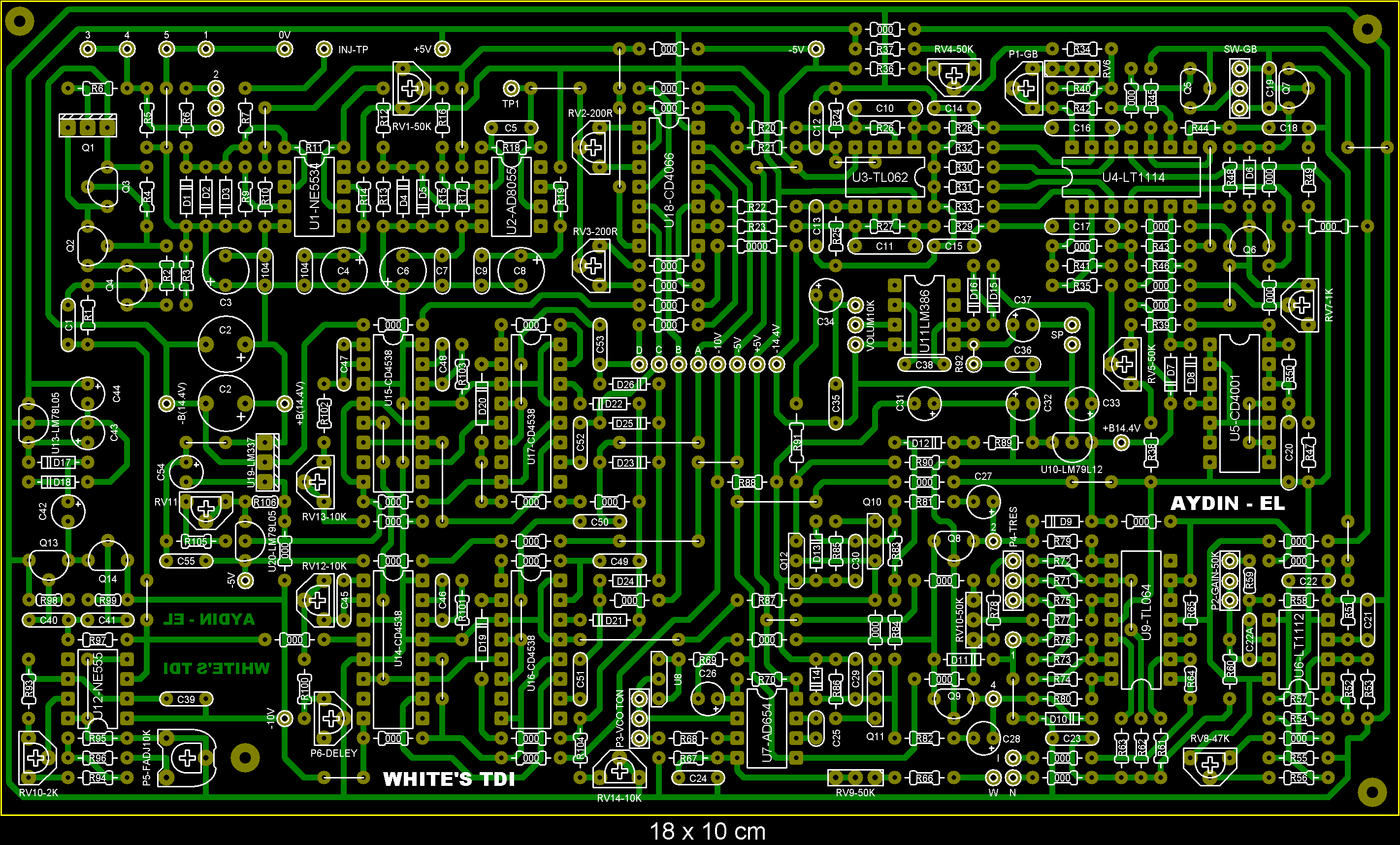

                          hello all member
                          pleas look at the PCB correct or no ?
                          I want make this device
                          What do you think? Please let me know if you have any suggestions.​
