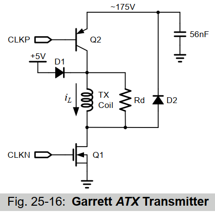

    Yes, this is done in energy-recycling kickstart circuits. The Garrett ATX/Axiom does it like this:
    Click image for larger version  Name:	image.png Views:	0 Size:	29.4 KB ID:	445590

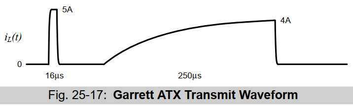

    which is almost identical to patent US9366778. During turn-off, D2 and the cap act like a snubber circuit and dump the coil energy on the cap. At the next turn-on, that energy provides a high-voltage "kick start" which ramps up the coil current much faster. Here is the Garrett waveform:
    Click image for larger version  Name:	image.png Views:	0 Size:	22.3 KB ID:	445591
    The kick start drives the short pulse but not the long pulse.

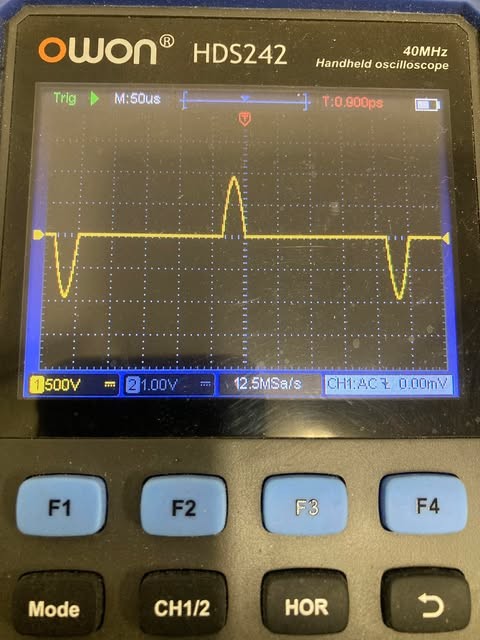

          Originally posted by pechkata View Post
          Click image for larger version  Name:	viber_изображение_2026-02-12_17-20-50-445.jpg Views:	0 Size:	71.1 KB ID:	445607
          Pechkata :
          You went the wrong way. Current is not measured that way..!
            Everything shown in the video is measured in the right way. Orbita makes the same video, let's see how you measure? Anyone can write in words, but the important thing is what a person does, and the colleague, the stove, does not stop and one day will improve. , I admire him.
                Yes, I was making a mistake too! But that's not how it's measured. Of course, I have nothing against anyone, let them measure as they want. And I also support anyone who is persistent in anything.
                  I don't understand what kind of current this is.
                  Where did you see a current measurement?
                    Karl's diagram shows the shape of the current! Let Carl explain. What you measure is another.
