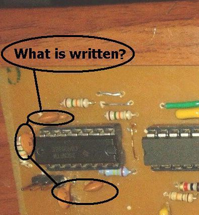

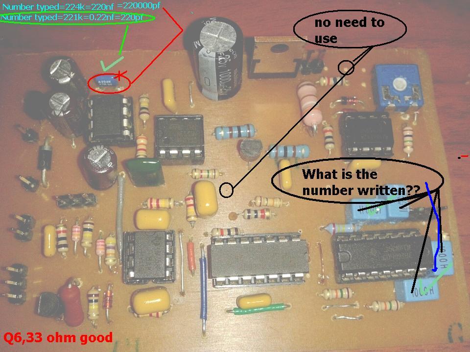

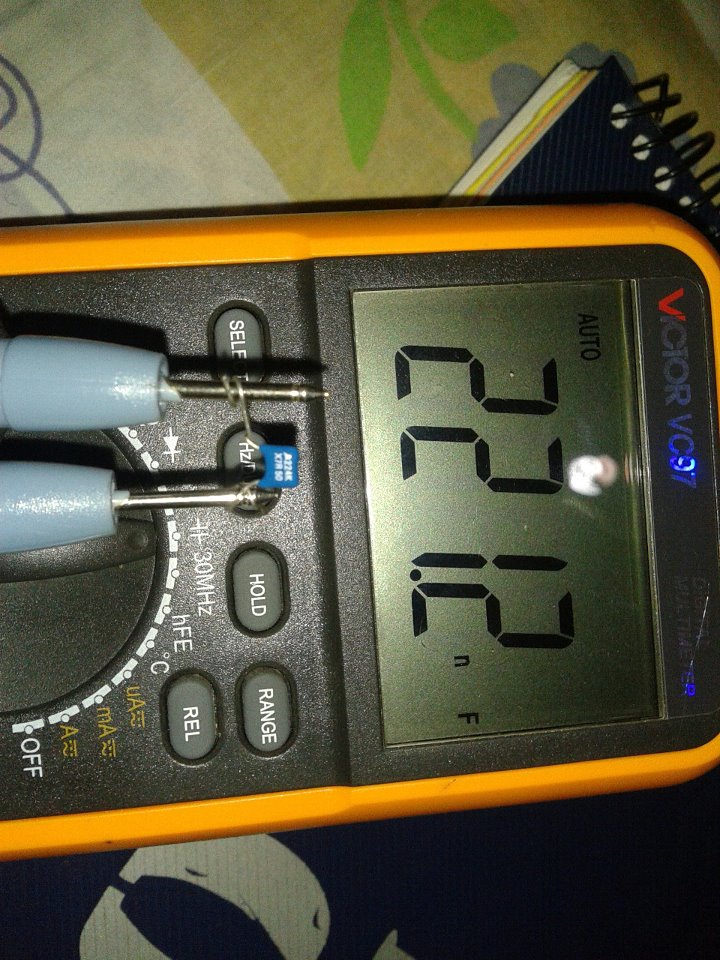

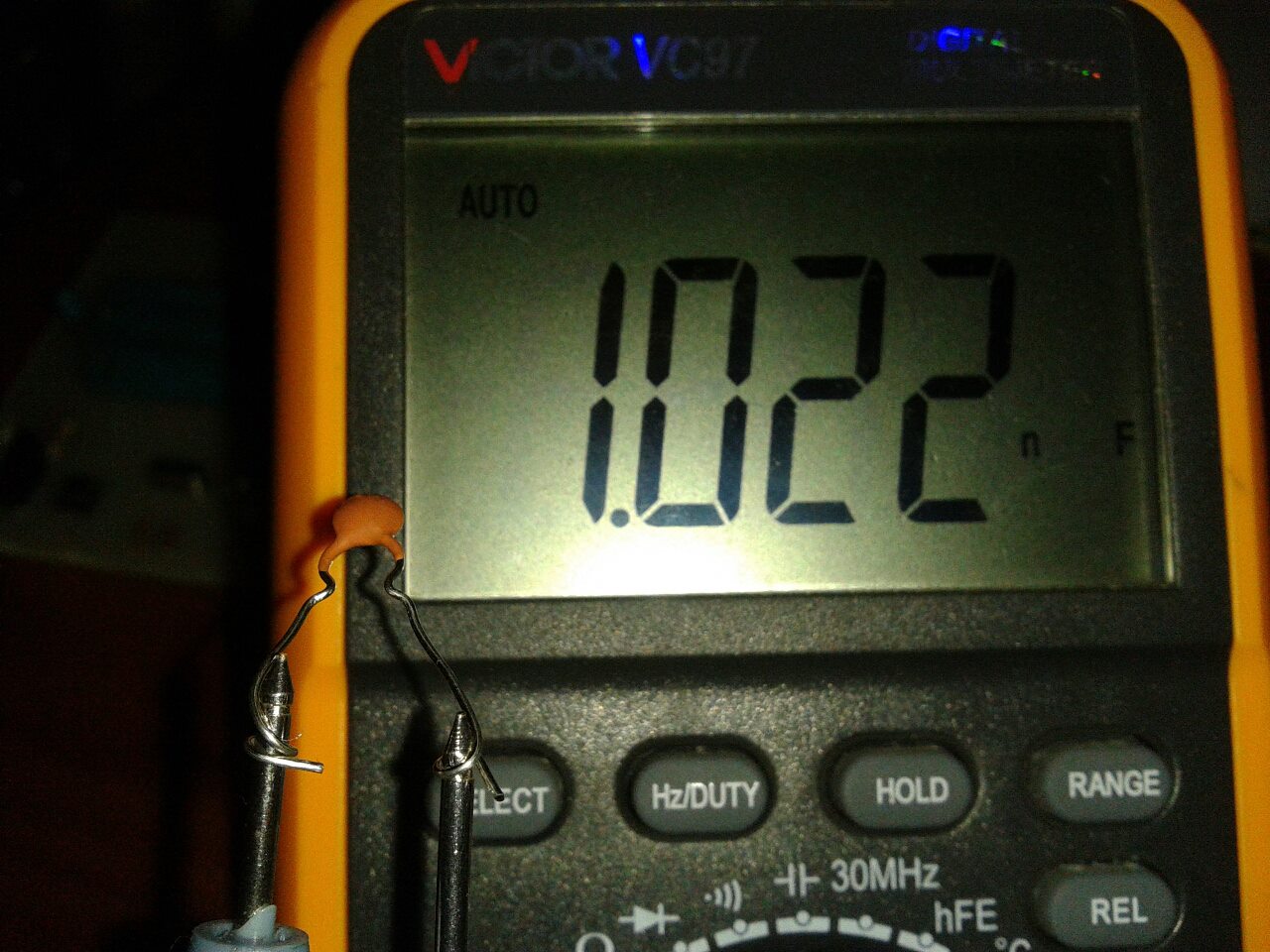

224k market value and equal to 220nf, Just as the meter readers 220.2nf .
221k market value and equal to 220pf.
***Want to change to 220pf********
***Required to change the 4 capacitors to the bottom of the picture :-
by 1nf=102k market value
best time

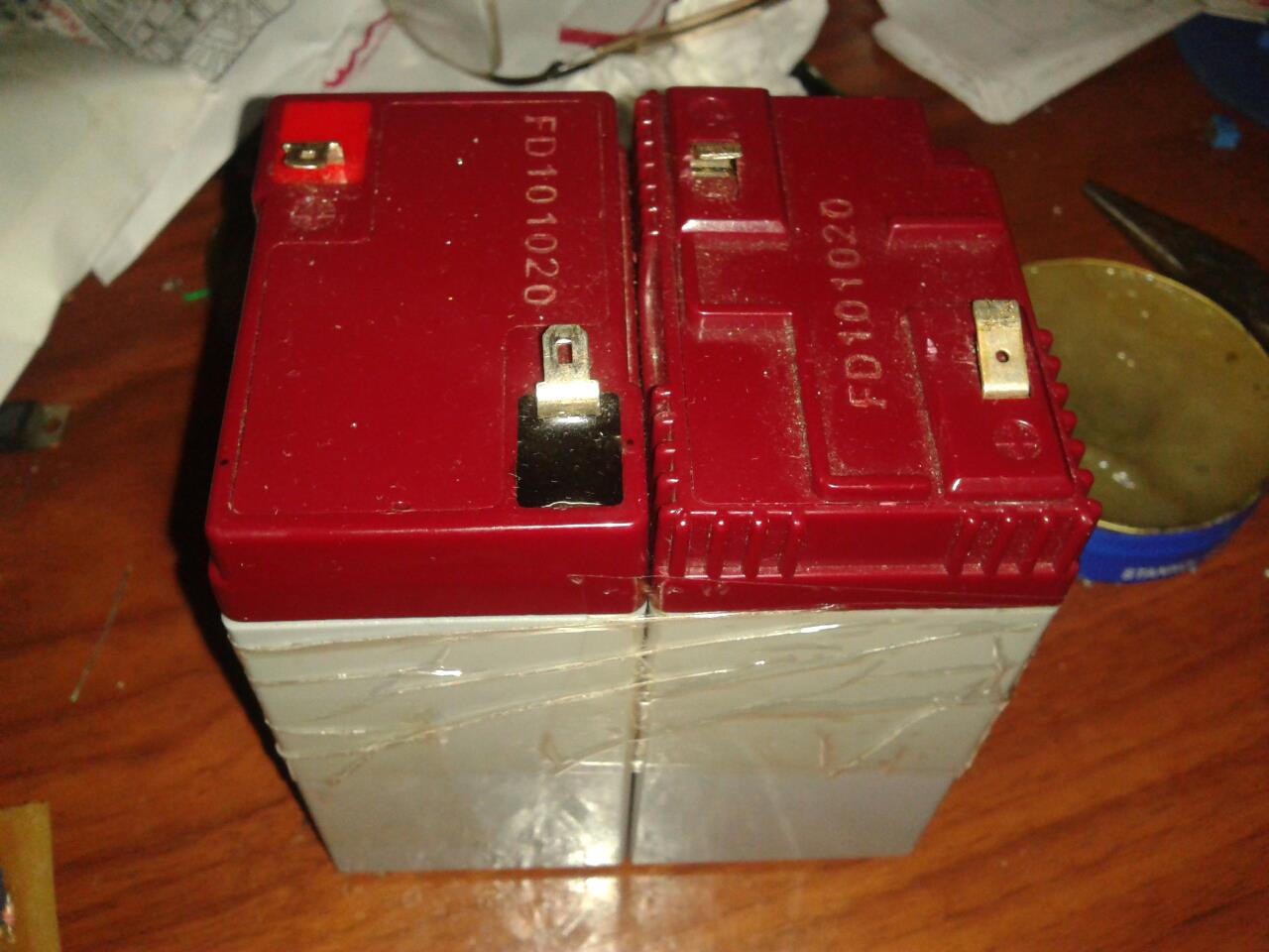

i have 2 (6v 4amp battery) put them in series well give 12v 4amp (is that ok?)

This is very basic stuff.
To decode the number 102, use the 3rd number as a multiplier. i.e. 10 + 2 zeros = 1000. This value is in pF, giving us 1000pF, or in other words ... 1nF.
In case you don't know the capacitor codes, then try using this ->
Hi Qiaozhi
Thanks,,,,, I know he does not ------ Note:Link to the relationship what has been written (102)and reading device (1.022)nf..So I asked him!!!!!

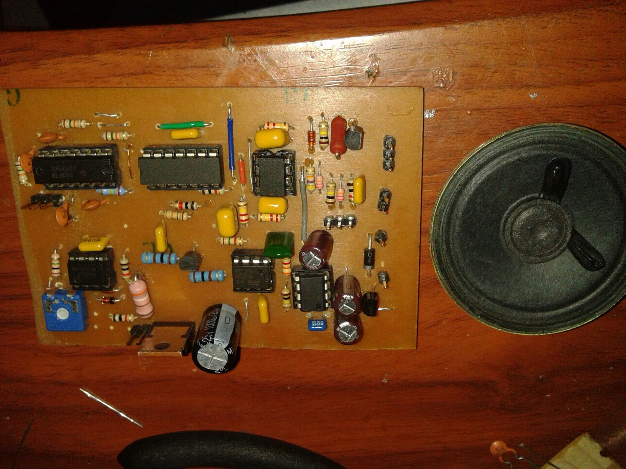

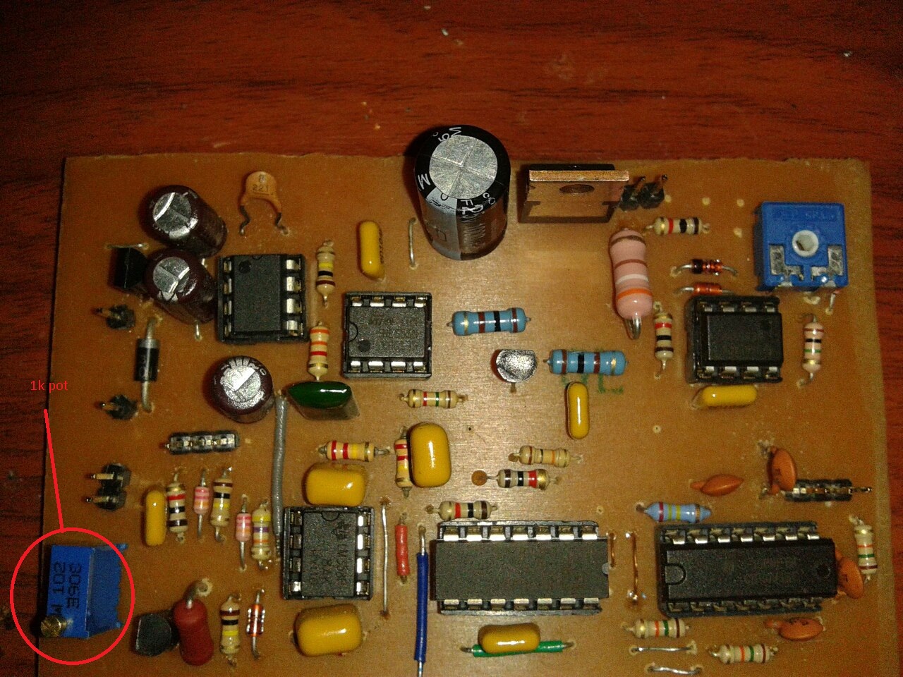

jap i tested it and it gives continuous beeb
when i change the threshold the sound fades ( dose threshold control the volume f the speakers?)
can i use 220k instead of 100k in threshold or delay?
