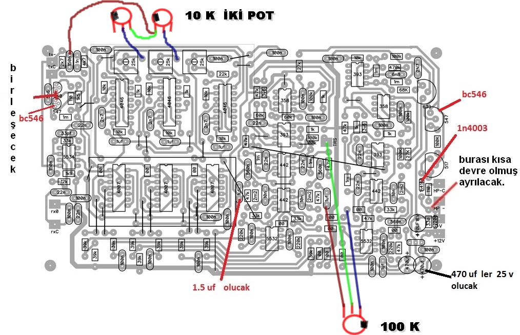

    Dear Eduardo I am waiting for help about modification of elyapımı to get better performance.Pls help to modification
      cnckecgo, what schematic did you use.
      In your PCB I see 9x (R) 39K.
      In schematic Eduardo and Ivconic I see 3x (R) 39K.???
      Grt Nakky

        3x (R) 39K , Add CD4007 pin.2-9 between the NE5532 pin.2 , NE5532 pin.6, NE5534 pin.2

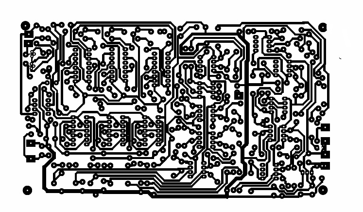

          nakky Have you pcb file can be printable
          can you publish please..
            Originally posted by cnckecgo View Post
            You gotta draw the pcb of this schema eduardo
            Why won't you post the schematic that goes along with your PCB diagram? I mean, you started this thread with a PCB and included no schematic. Wha?

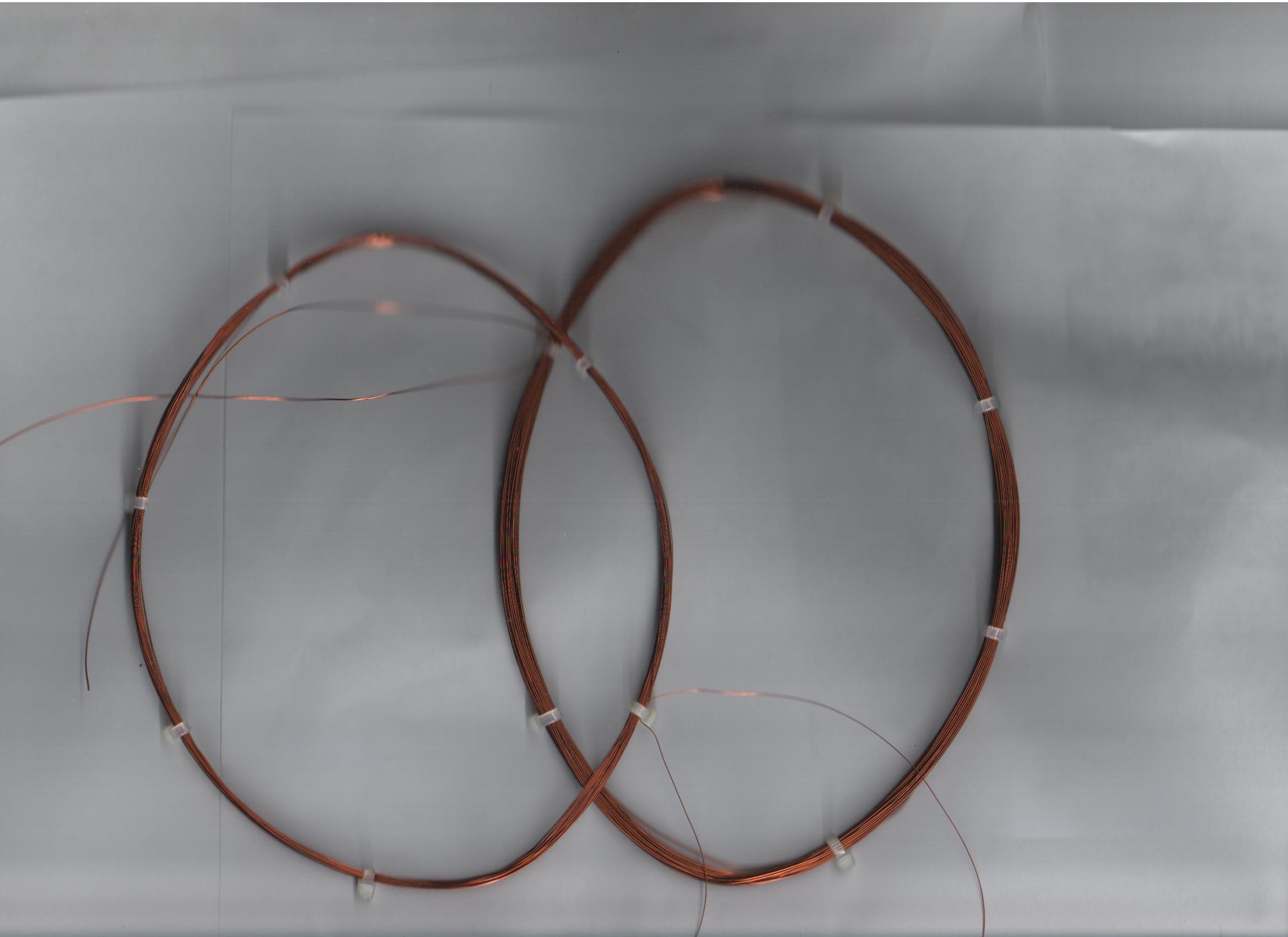

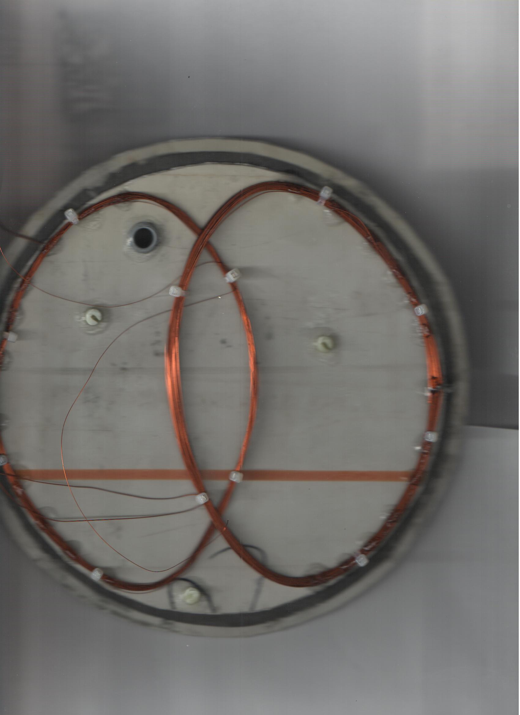

                  coil 13 cm diameter rx 0.25 coil 50 turn tx 0.35 coil 50 turn

                        PCB Layout ic3 filter rx connect point incorrect Is it possible to fix?
                        • #42
                          [QUOTE=dekoratör;164023]PCB Layout ic3 filter rx connect point incorrect Is it possible to fix?[/QUOTE
                          Yes,can you tell me what is incorrect?

                              im very interested to build this project, but i need very fine pcb picture. I have downlod pcb from this thread but very blur when print to transfer paper. 10q
                              • #45
                                Artworks should be posted in gif, or png (bitmap) format. Tif is also OK. But never, ever, DO NOT!!! post artworks in jpg. Jpeg format is optimised for photographs, and compression that it employs is creating blurry edges on sharp edges, e.g. artwork.
