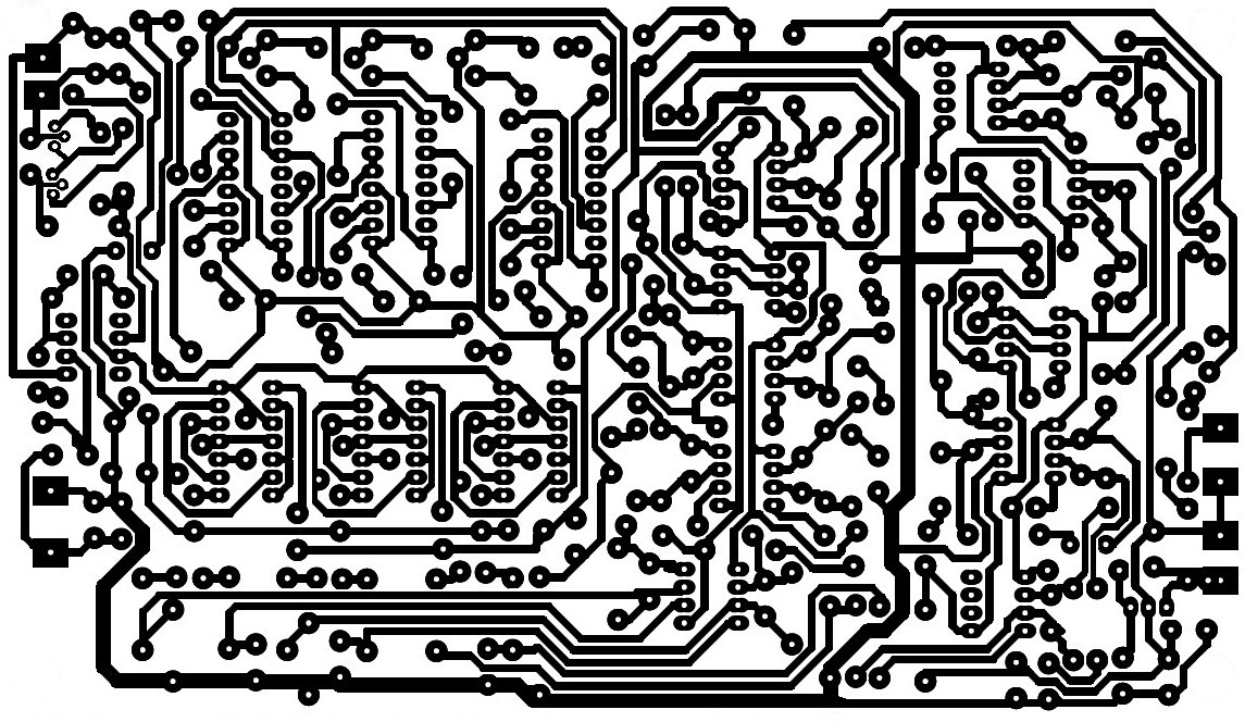

    IC 3 Filter Rev 1. LAY = Sprint Layout File = BMP format = Perfect .
    Grt Nakky

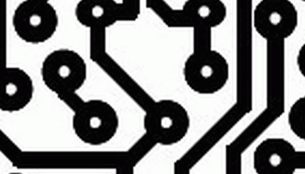

      Good? this pcbClick image for larger version
      • #48
        Grt Nakky
        thanks nakky. i already download sl version 5. prefect!
        • #49
          opss perfect. hehe. direct print from sprint layout. track very smooth.
          • #50
            Originally posted by oros27 View Post
            Good? this pcb
            Nah. Look...
            • #51
              Nice to hear.
              Grt Nakky

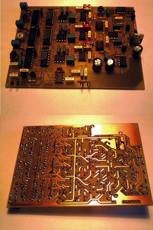

                        • #57
                          Oh yes, i made it recently.
                          First i had to draw again schematic on "my way" to be able to draw my own pcb without mistakes.
                          Than i draw my own pcb, because i don't like original one; it is too largeeeeee!
                          Than i made it.
                          I don't have time to make proper coil for it, for now, so i just tested it with Tesoro coil (Tejon).
                          It is working! Of course; it is not working good at all, because of the not so proper coil.
                          But point is; it is alive and kicking.
                          Also it is promising.
                          Will have to wait for some spare time to make proper coil.
                          Cheers!
                          • #58
                            With improper coil i almost get good results considering air distances!
                            For a coin i get almost 35cm!!
                            Large iron even more.
                            But of course i don't get proper phase behavior.
                            With this coil frequency is 13.91kHz.
                            All the trimmers are working.
                            By now i put only trimmers on pcb to prevent much mess on my workbench.
                            Later i intend to add potentiometers.
                            I had troubles with some component values, for example capacitors 564 (560nF).
                            So i used 220nF + 330nF in parallel.
                            Also i used 8k2 instead 7k9 and 120 ohms instead 110 ohms.
                            Later if i find as necessary; i will try to correct those values.
                            So far i am pretty satisfied because i think that there are no mistakes in my schematic and pcb.
                            Pretty rare case!
                            • #59
                              Thanks Ivconic,
                              Did you change things in your schematic,becose you are confuse about some things.
                              How big is your pcb?
                              Grt Nakky
