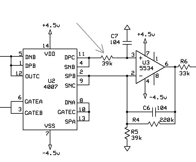

                I looked at this schematic earlier today and noticed this error. The pre-amp seems to be an attenuator rather than an amplifier.
                • #68
                  Yes, thank you.
                  And what has happened to the 39k resistors connected in series with 104 capacitors, between the CD4007s and opamp + inputs? They are shown in the original PCB but not in any of the schematics. (See galaksi's post #33)
                  Instead of having only 0.1uF to ground, this started as 39k in series with 0.1uF, to ground on pin-3 of the opamps. That is not some trivial issue, imho.
                  edit: No, the 39k resistors are not in series with 0.1 capacitors. Three 39k resistors should be located between the opamp non-inverting inputs, and CD4007 4&11.

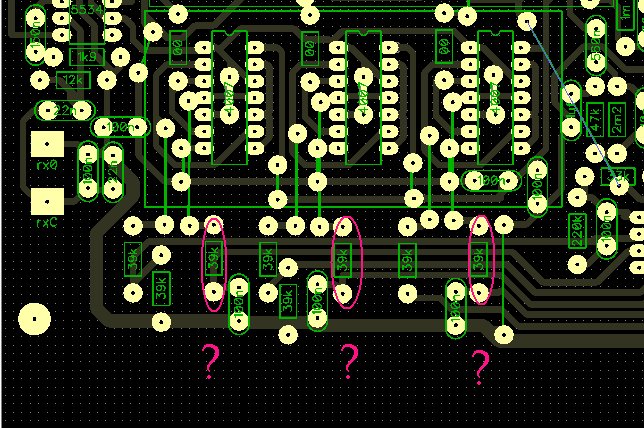

                  • #69
                    Here is another view of something missing. The PCB clip is from post #1.
                    I have severely edited the following:
                    39k resistors should be connected between CD4007 4&11 to the opamps pin-3.
                    • #70

                                I was pointed, er directed, to a Turkish website, but I never could find a suitable schematic to match the #1PCB, so I am still wondering WHERE did this come from??
                                I downloaded and installed Diptrace for the sole reason of opening one of cnckecgo's depositfiles contribution (what a lovely experience), but I was disappointed with what I did not find. The Diptrace PCB is nice to see, but providing a schematic to look at would have made so much good sense. (Hint hint).
                                Ivconic's (and also Eduardo's) schematics do follow the basic PCB layout (thanks to both of you) but there are some er, questionable deviations, and some disagreement on component values.
                                Where is concensus? Or am I hoping in vain (oh yeah, that's it.)
                                We get a PCB layout, no explanation, and no schematic to accompany it?
