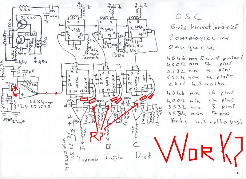

    This schematic work ???This is new ""Tarsos ""???Click image for larger version

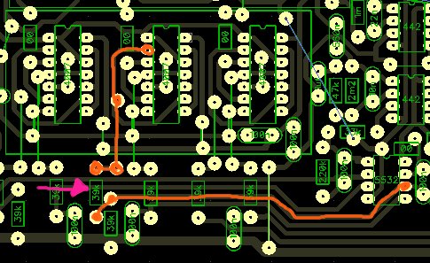

      All R=39 K
      • #93
        SCS appears to be paying attention.
        Take a look at the DIP file and follow the outputs from each CD4007 pins 2/9. Sure enough, there is a 39k resistor in series before arriving at each of the three NE553x opamps' - inputs.
        That makes sense when you consider that there is also a 39k resistor in each of the + input legs.
        I'm thinking it deserves a closer look because it is almost an ordinary differential circuit but with some differences.
        edit: I have re-uploaded and re-named the DIP file that was contained in yepyeni2.rar because the old rar file gave no indication of what it contained. (I hate that and it happens ALL the time. Everybody does it.)
        DipTrace opens the file with some extraneous editor windows. If you close them out (through VIEW>TOOLBARS) you will have a wider viewing area. I know nothing else about DipTrace so don't ask me any advice. Of course you'll need to have some version of Diptrace loaded on your machine before you can open the dip file. The free version works OK.

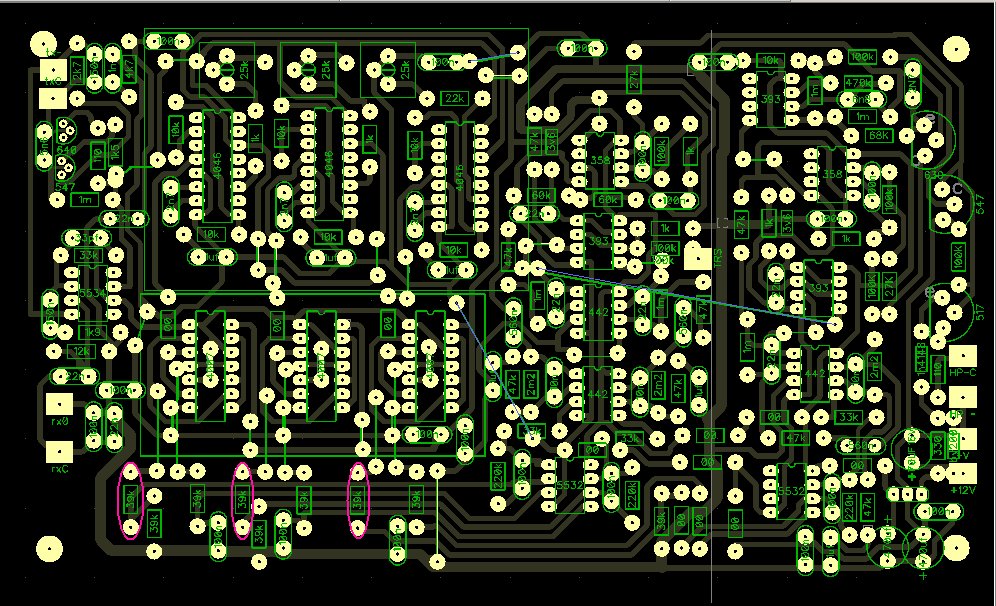

ID:	338419 IVCONİCK pcb error location
                            • What is the error of the detector, or it's a failure.
                              • Zar pll nije uspeo niko da napravi kao na youtube ,klip koji je postavio neko jako lepo radi .
                                Ja sam zainteresovan ako proradi pll ,kako sam cuo da je na terenu neupotrebljiv zbog loseg geba upornoscu cu ga dovesti do perfektnog rada na svim terenima i objavicu izmene i klip sa terena. Tako molim one kojima je proradila neka od pcb neka je objavi ovde ,pripremio sam sondu samo da je nulujem ali psb koji sam odradio nema jos jedan LF358 koji ja nisam blagovremeno video i zavrsio plocu komplet ali napone V+ i V- nisu ok i neradi .
                                Molim za pomoc oko PLL-a.
