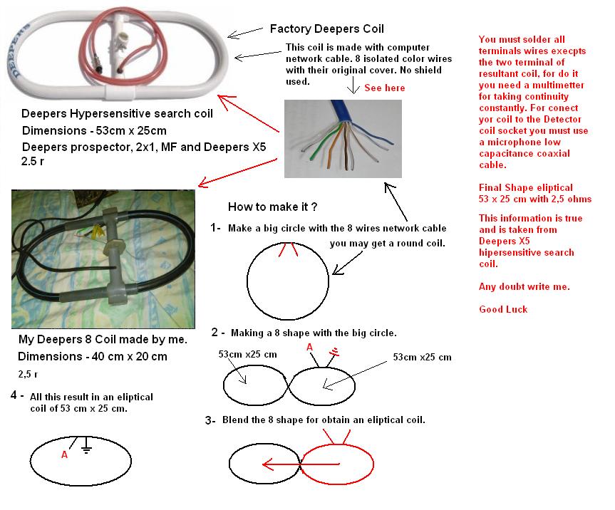

Hmmm, ok just to avoid any confusion, the folded coil I am talking about is step 4 on the drawing in post # 213.
If you follow all the steps 1-4, Step 4 (to me) shows a FLAT figure eight coil, folded over on its self to form an elliptical coil, what is the advantage of the folded coil over a normal bundle wind coil.
In regard to pages 57-60 and the flat big foot coil, Does the folded eight coil ( elliptical) behave the same as a FLAT eight coil ?
what is folded coil what is flat eight coil. give pics. take a mind we are NOT SPEAKING english to graspOriginally posted by 6666 View PostHmmm, ok just to avoid any confusion, the folded coil I am talking about is step 4 on the drawing in post # 213.
what you mean -!

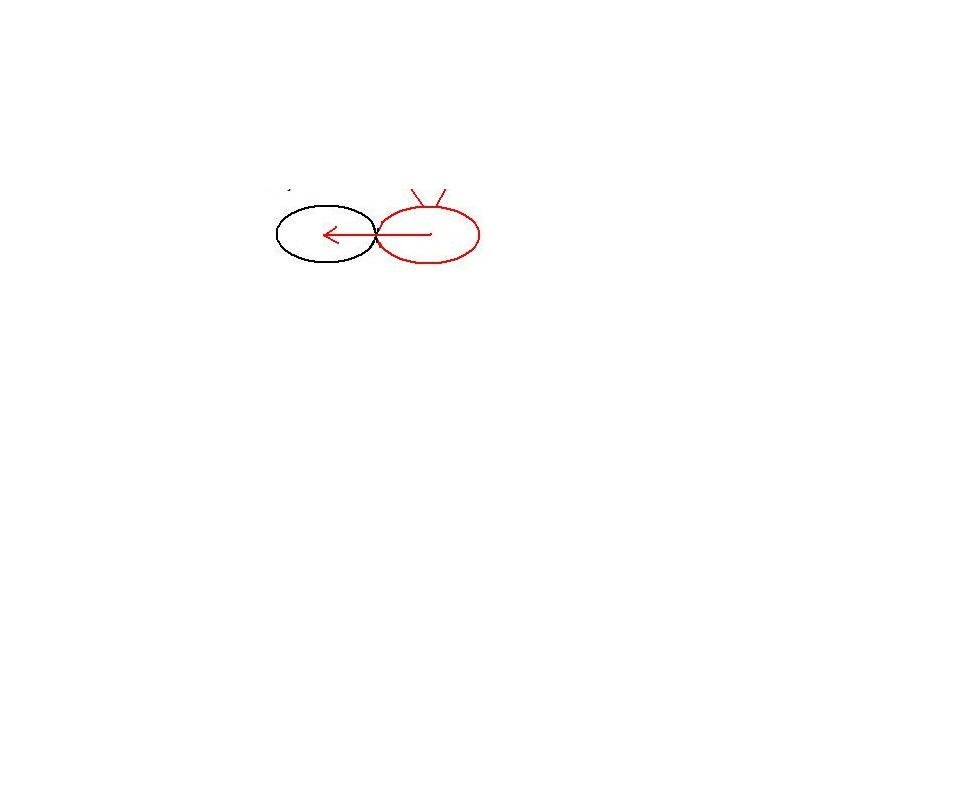

In post #213 it shows all the instructions on the folded coil
basicly you wind a round coil, then twist to make flat figure 8, then fold one side over the other

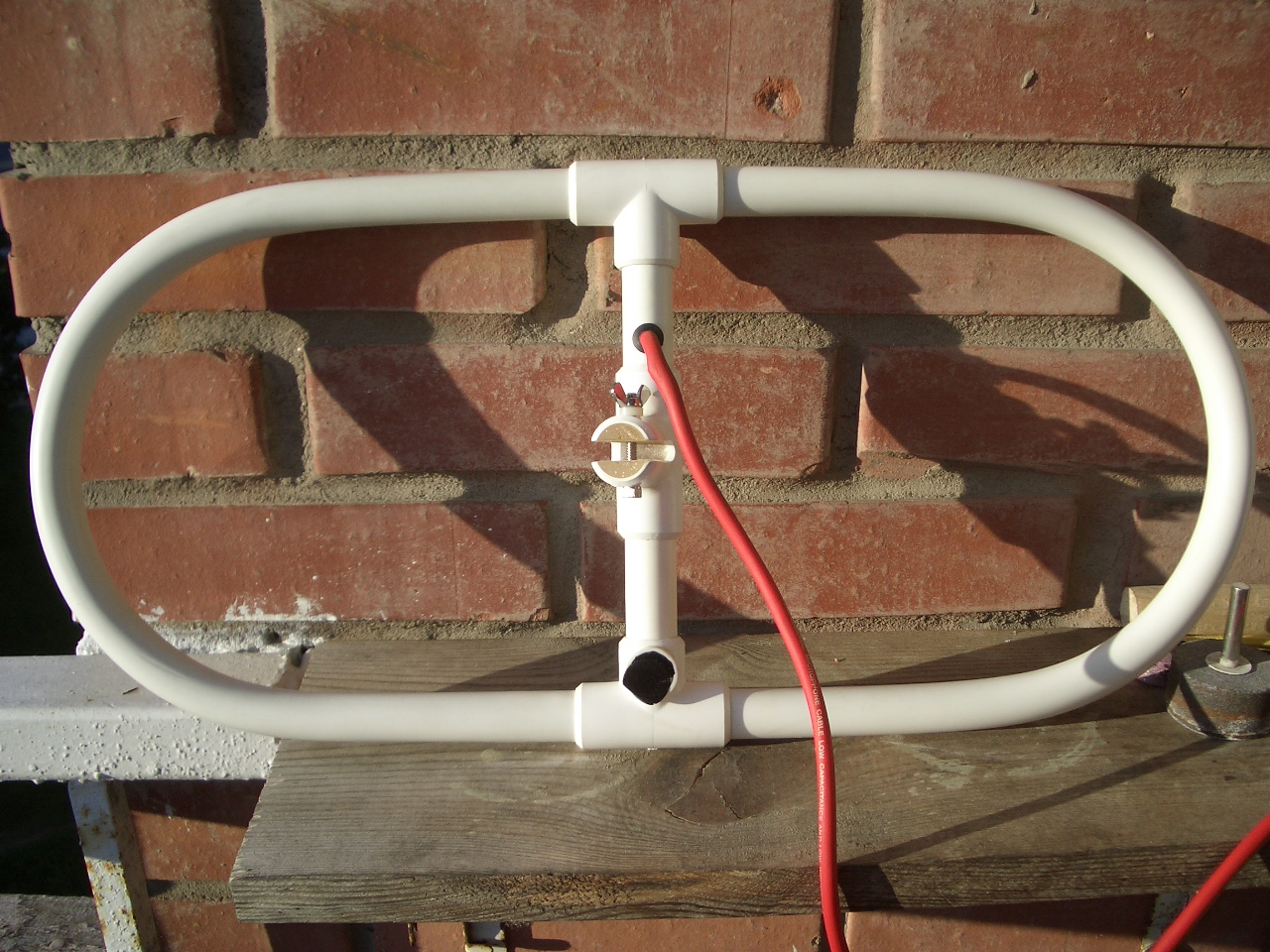

ok. good way. he used my photo of the coil was been with DEEPERS 10DD in complect.
but one thing you do not want to see... you can NOT put it in the tube.
its IMPOSSIBLE. so thats only a intoxical fantazy of the writer.
way must be - you take TWO pieces of the cable and put them in the tube. then you connect wire-to-wire in
one chain.
