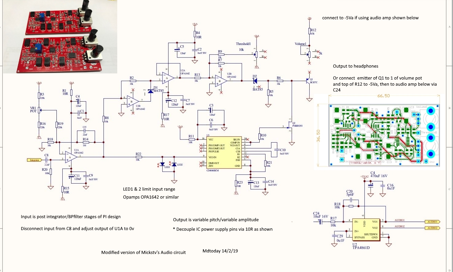

Please forgive me for my wrriting here.
I have a question about your schematic, 100k trimmer.
For doing 0mv out of first amp, do you think i should do it before connecting my pi to c8 or it is better to be connected my pi?!
