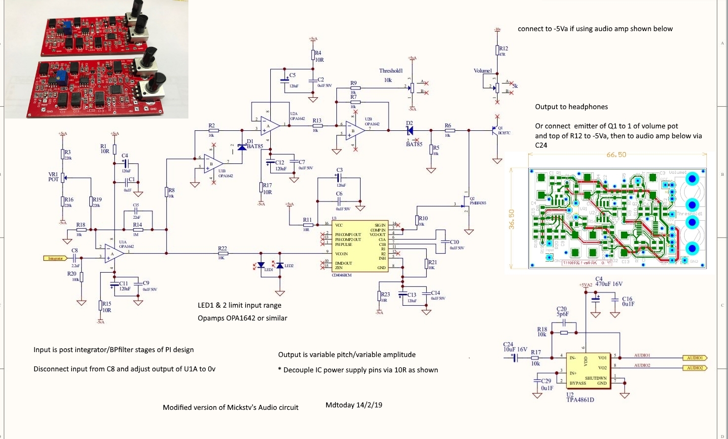

    Here is a great little VCO circuit Mickstv posted back 2-3 years ago and I've had veroboard version for use on my bench for so long..it finally gave out so I decided to put it onto a PCB.
    I added extra decoupling, changed Fet and added option for audio amp connection..all vanilla stuff.
    Had 10 Blank PCBs made by PCBway for $25 Au and $20 of that was delivery.. Thanks for the heads up on that Moodz.
    I normally use a digital audio version of this but sometimes analog is a better fit and Mick's circuit was worthy of a pcb
    It is SMD using mainly 0805 parts.
    [ATTACH]45385[/ATTACH]

          • Originally posted by Mdtoday View Post
            Measured with input zero it is 400hz, just change to suit your requirement

            Dear Mdtoday
            Can you tell me value of VR1-Pot in your schematic?

              VR1=100k and C8 = 2.2uF

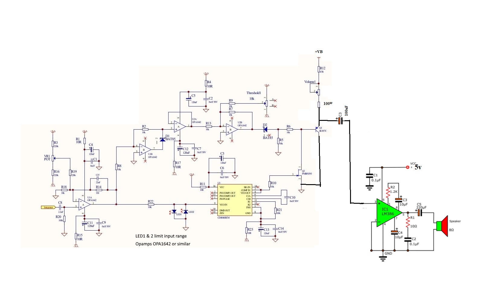

                        Dear Mdtoday.
                        I want to make your Audio + Mr. Walter's audio + HH1 audio and to compare them.
                        As you remember, i'm trying to build your schematic based dip method, not SMD.
                        Mr. Walter helped me (i really thank him) how to add a LM386 to your schematic (attached). Off course, he pointed that i need to build and test.
                        Anyway, is it possible to tell me your suggestion for adding LM386?
                        Thanks.

                          Looks ok, now go build it and try it out, build the power supply and audio amp first, make sure it works, then add Mickstv circuit, do it in stages, test each stage then move to next one. Dom44 did a through hole version, others have built that one too, he used an Lm386.
                          As Mickstv and others have said, the circuit works, so why not build as per the schematic posted first, give it a try then start changing things.
                          It is the best way to start, try not to complicate things, I’m sure you will do just fine.

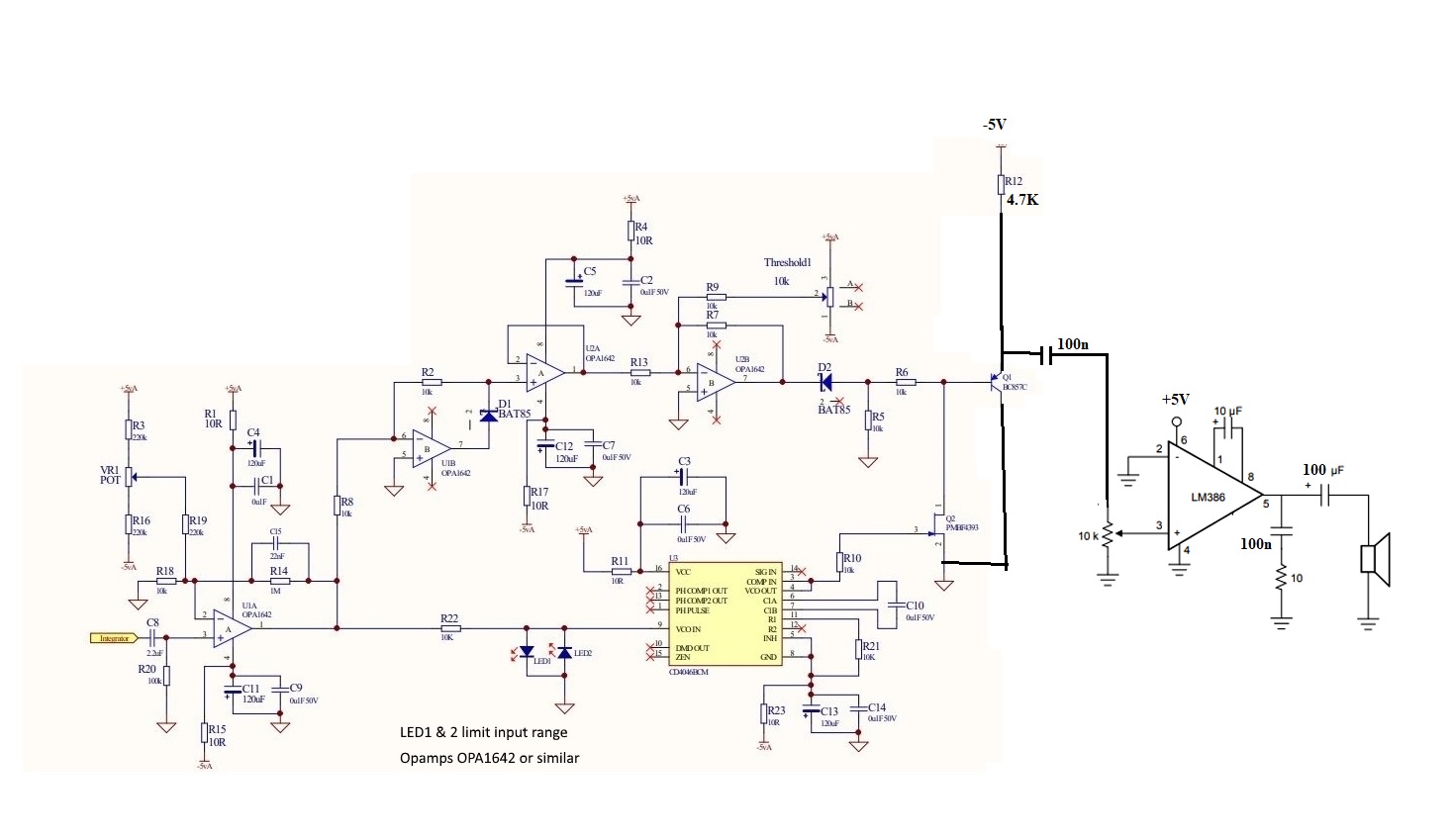

                            thanks dear Mdtoday.
                            I saw Dom44's PCB. He used the attached schematic, do you think it's true? Off course, i think he labeled mistakenly E and C of Q1 in his PCB.

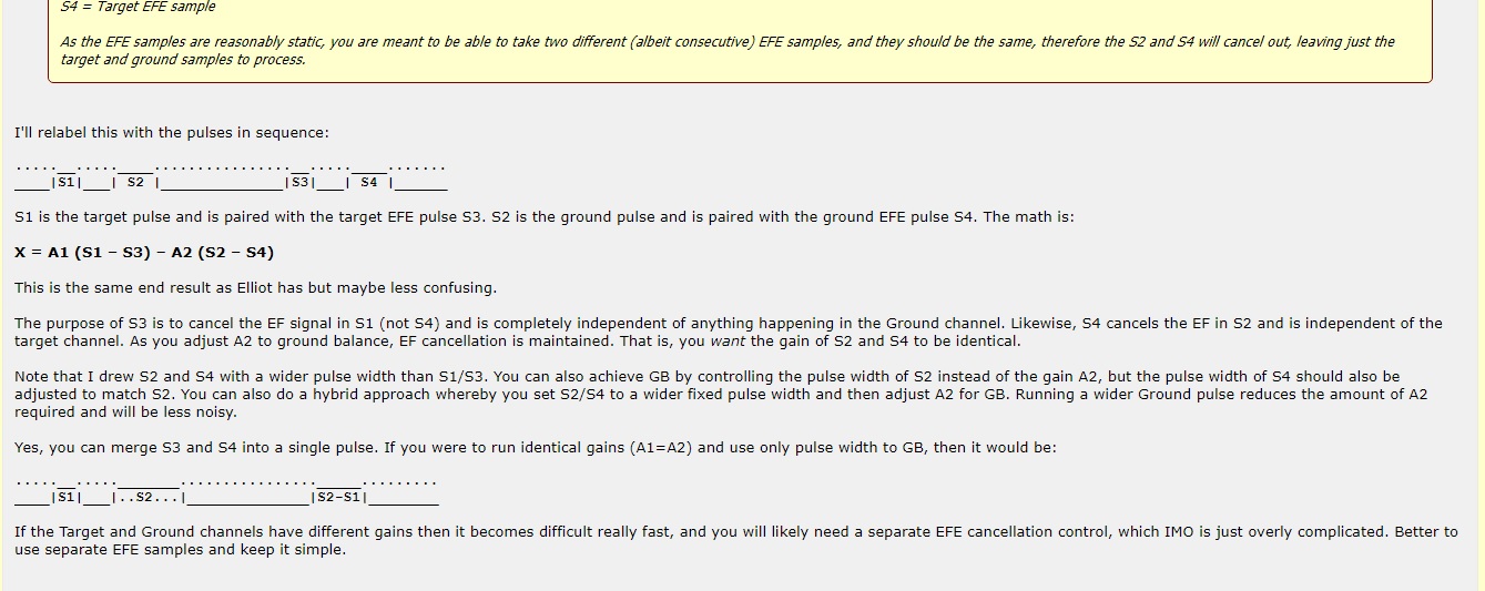

                            • Originally posted by mickstv View Post
                              No pin1 of IC8a. Forget about the HH sat, the rest of the circuit has a manual threshold control, which is better for small target detection.
                              It's easier to do three samples the you only need one integrator.
                              S1 about 5us, S2 130us and S3 125us all approx. Then you adjust the delay between S1 and S2 to ground balance
                              Hello
                              Dear mickstv
                              Please see attached, it's explanation of Mr. Carl about GB process.
                              I think your method is completely different (U-second and formulation) than it.
                              Is it possible to tell me more about your method?
                                Hello
                                Dear mickstv
                                [ATTACH]55642[/ATTACH]

                                This thread is about PI Audio, you should really start a new thread if you want to begin asking about Ground Balance.
