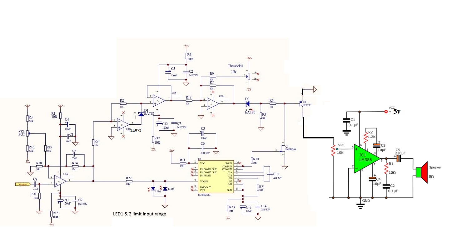

      I want to use TL072 instead of your amp because it's low noise. Please see attached, do you think lm386 part is correct (especially emitter and collector of Q1).
      Thank you.

          Dear Mdtoday.
          Thank you.
          [ATTACH]55068[/ATTACH]
          The common I think is referenced to battery positive, so yes, it seems correct. The ground shown in the schematic for the lm386 is battery negative.

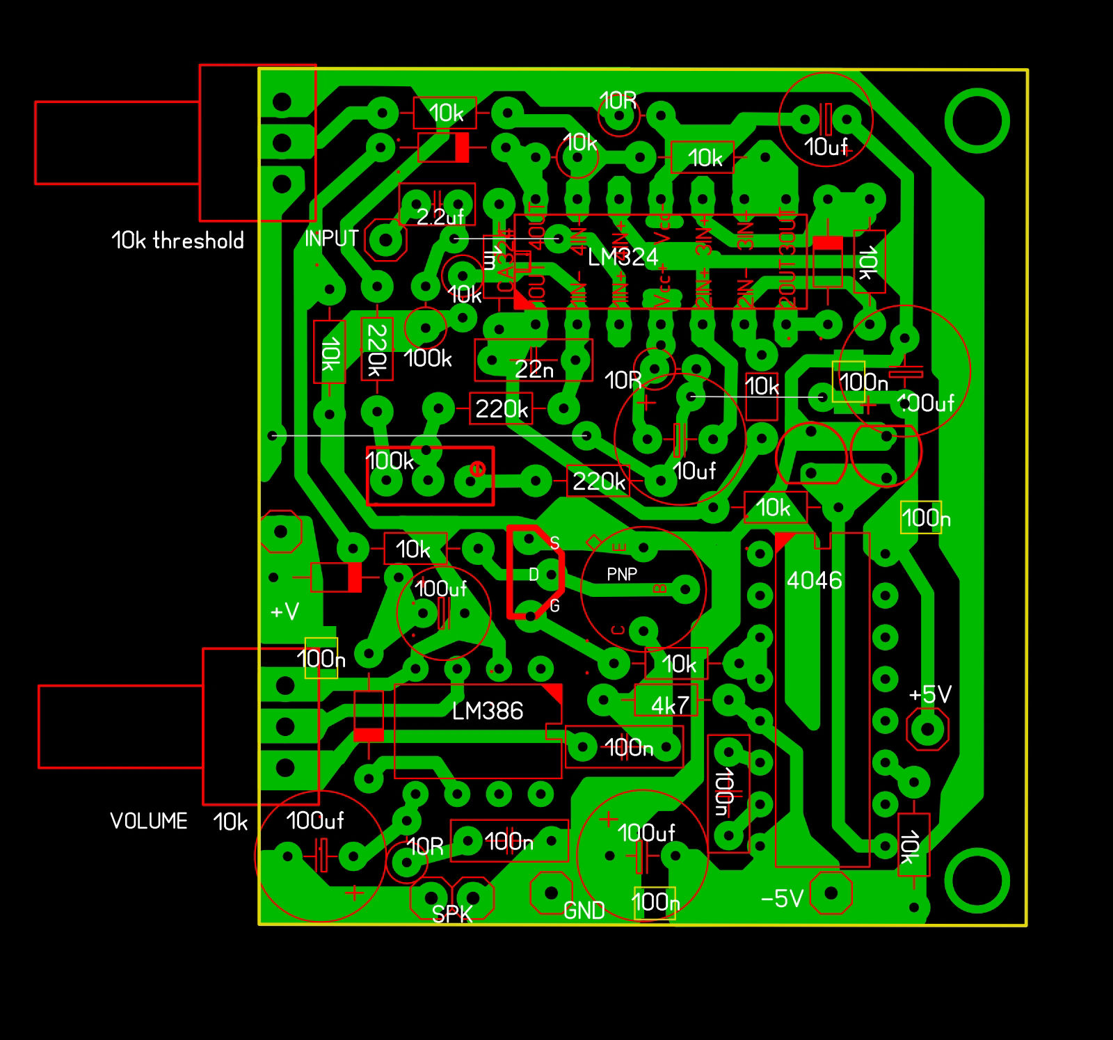

              Dear dbanner
              Please see attached, it's designed by Mr. Dom44. Please see its LM386, i think both emitter of Q1 and ground of LM386 is connected to battery negative, it it true?

                        AC couple the input to the LM386
                        Dom44’s board layout doesn’t look correct, emitter of the BC557 should not be tied to GND.
                        its late, maybe I’m seeing things

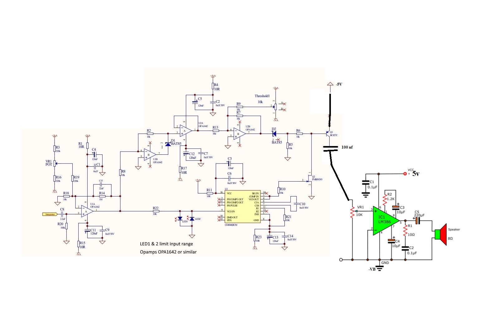

                          So, it's better to be connected to -5V, true?

                            Originally posted by h9361 View Post
                            Thank you dear Mdtoday. About your schematic, we can add a uF capacitor before Pin 9. In this case, we have a nice delay than target and we can easily detect small change in sound (soft sould) like GPX audio.
                            Please see the video, time 5:00. He adds a 10Uf in pin 9, then we have a delay in audio.
                            No, that is not a very good idea!
                            You need fast response not slow.
                            The Mickstv circuit produces variable frequency, variable amplitude and for gold prospecting is ideal.
                            Response is clean and crisp.
                            Best thing to do is build on breadboard and experiment
                            • #89
                              Do you remember audio Frequency of CD4046 in your schematic?
                              • #90
                                [ATTACH]55072[/ATTACH]
                                Yes
                                Build as per the schematic and notes in first post of this thread and it will work.
