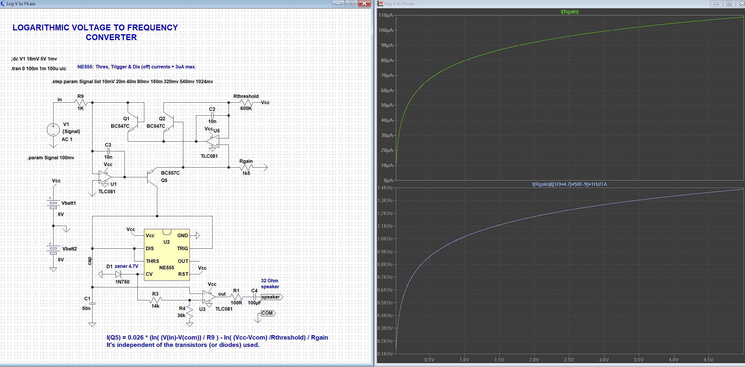

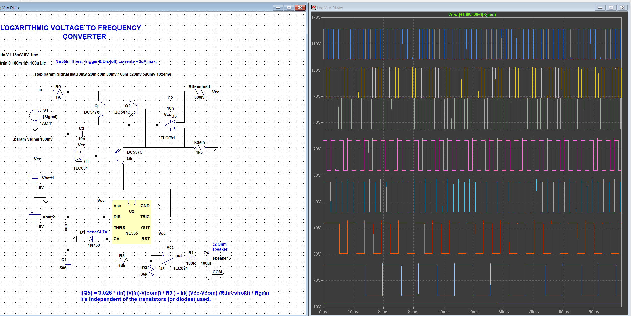

I'm sharing my design for audio. A logarithmic voltage-to-current converter charges the capacitor of a multivibrator based on NE555.
The log function means that small input changes translate into larger frequency changes, weak targets get more audible.
Resistor Rthreshold controls the threshold, obviously, and resistor Rgain adjusts the maximum frequency.
The log amplifier is compensated for Is of the transistors and conforms very well to the theoretical transfer function:
I(Q5) = 0.026 * (ln( (V(in)-V(com)) / R9 ) - ln( (Vcc-Vcom) /Rthreshold) / Rgain
It should be independent of the transistors used.
The input has to be positive relative to the analog ground COM.

Should be possible using a circuit similar to what the TDI-SL has. I'll see if I can figure it out. Realize though that by making the VCO more responsive near the balance point you will end up with a much more "lively" audio threshold.Originally posted by Elliot View PostIt would be great to see a circuit that caters for both positive and negative input signals to work with ground balancing PI designs.
