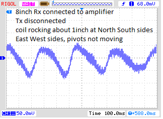

Tried recording EFE signal at amplifier out. Connected 8inch mono coil to my bench circuit and swung it while watching scope. How I swung the coil had a big effect on amplitude. Is it possible to swing the coil for no EFE signal? What has to happen to cause an EFE signal?Originally posted by Carl-NC View PostI completely forgot, there was a quiz question back in #151:

EF effect is due to moving a conductor through a magnetic field.Originally posted by green View PostTried recording EFE signal at amplifier out. Connected 8inch mono coil to my bench circuit and swung it while watching scope. How I swung the coil had a big effect on amplitude. Is it possible to swing the coil for no EFE signal? What has to happen to cause an EFE signal?
This is covered in Physics 102 so good place to search for the Physics answer details.
Basics:
If the magnetic lines of force are parallel to the conductor then moving the conductor will not produce a current to flow.
It is when the Magnetic lines cut across the conductor that current will flow if the conductor moves.
The maximum current flow for uniform magnetic flux and conductor velocity will be when magnetic lines are perpendicular to the conductor and reduce at smaller angles.

Hi dbanner, what happened to your reply? Don't know if it was correct but you at least tried to answer the question. Maybe swing should have been move the coil through the earth field. If the coil was mounted on a slide table that moved back and forth +-1m that could be aimed in any direction, North South, East West, horizontal vertical or any direction in between would there be an EFE signal. My guess is no, searched Physics 102 but haven't found the answer yet. Guess is based on observations of a crude experimentOriginally posted by dbanner View Post
Before the experiment I might have replied yes. Still don't know which is correct. Including scope picture of trying to measure EFE. Signal was less if pivot was N S. Holding the coil vertical, signal appeared to be higher amplitude when rocking coil, rocking N to S or E to W appeared the same. Little or no signal when moving coil back and forth. Signal at amplifier out is picking up a lot of EMI from scope at amplifier out so it's hard to see a small change. Would be hard to keep coil in same position without a slide table.Originally posted by green View PostHi dbanner, what happened to your reply? Don't know if it was correct but you at least tried to answer the question. Maybe swing should have been move the coil through the earth field. If the coil was mounted on a slide table that moved back and forth +-1m that could be aimed in any direction, North South, East West, horizontal vertical or any direction in between would there be an EFE signal. My guess is no, searched Physics 102 but haven't found the answer yet. Guess is based on observations of a crude experimentAttached Files
