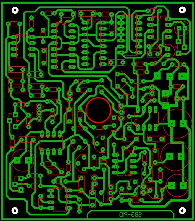

      I have almost finished with the layout. Will be posting it soon.
      I guess I will redraw the schematic too. No problem.

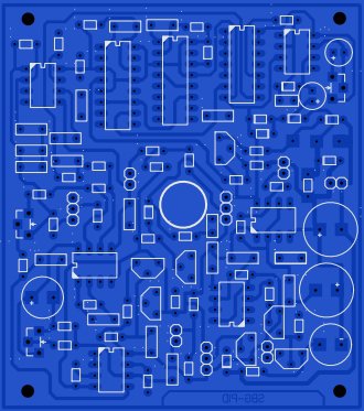

          Express schematic. Express PCB. That's the name of software. It's free.
          Layout has been completed. I will post be posting in few minutes.
          • #80
            top layer hidden in order to show layout more clearly.
            • #81

                  I will send you the complete Sprint layout file when I'm finished with labeling the components.
                  I'll be posting the redrawn schematic soon. Even though the more I look at original schematic, the more I get use to it. It's fine as it is.
                                How did you do that so fast ?
