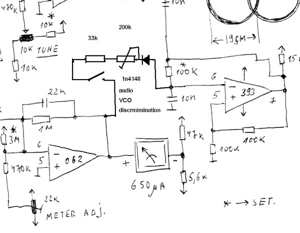

VLF MD (by Sascho - Varna)
  • Detector modification.Click image for larger version

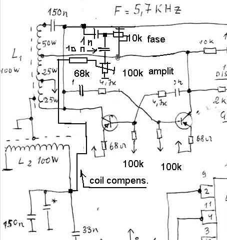

    • Hi scs, thanks, do you suggest to build this modification in coil housing or in main control box?
      • In the main control box of the small board.Make coil position without compensation.
        • Hi scs,
          I have a small request, and a comment.
          I wish to use this kind of coil compensation in my future designs, and I am aware that this is not a new idea, yet you are the one promoting it, so... Is it OK by you if I use it?
          A comment is about the Tx oscillator. In my sims of a balanced oscillator, and your oscillator IS a perfectly balanced one, I found that adding capacitors in the base circuitry moves a phase in way favourable for off-resonance oscillators. Your capacitors are at 10nF, which is on the safe side, but the effect is still there.
          • If you change the resonant frequency of the receiver changes the phase of the signal.
            • Of course. My goal is obtaining nice noise figure by direct method, coupling a coil directly to a real low noise preamp, and that would provide a very monotonous phase change there. Even a series resonance in this configuration has a very little and monotonous phase change.
              There are many ways of achieving superior noise to mid range op amps.
              • This scheme work with high amplitude oscillatory and low amplifier gain.Noise is not problem.

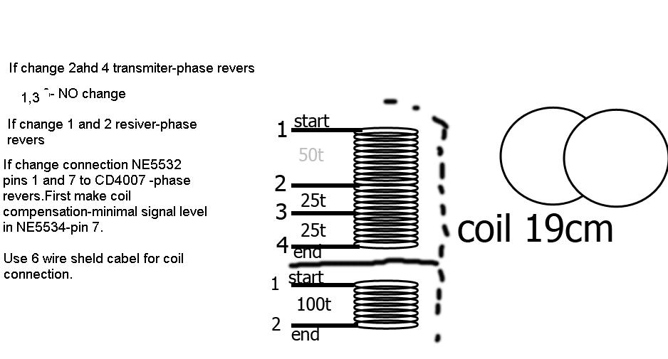

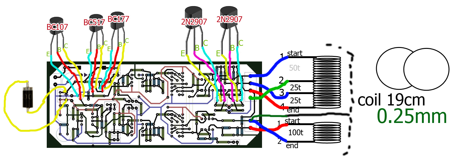

                • VLF MD (by Sascho - Varna)
                  This is the way that was connection to the transistor and search coil .If you have a better idea, I will be glad to Correct picture attached.
                  Greetings

                      • Hi,Salih!At your post #188,#189 you have reversed pins of transistors.From left to right it should be c-b-e .At your picture : e-b-c !

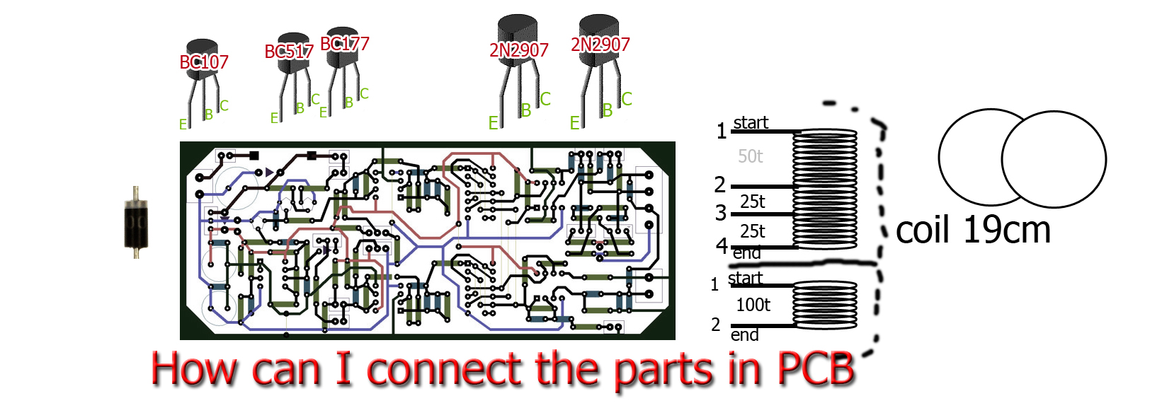

                        • Please give some info on how to properly connect the antenna transistors

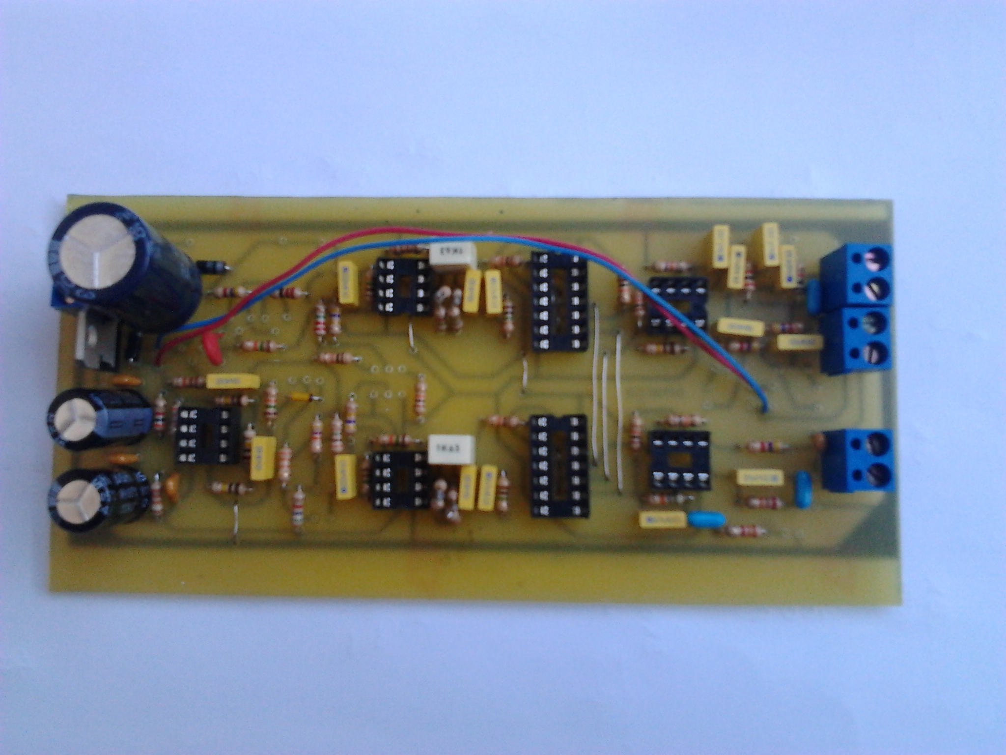

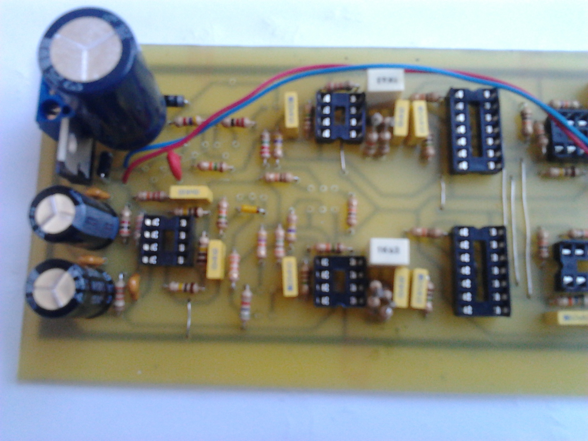

                          • Here's my new motherboard
                            • Good afternoon, I looked through all the pages of the topic and there is not a single publication of the board in LAY, here, please, please check, maybe I put something wrong in the denominations, the pinout of the transistors. If there are errors, please correct them. is it worth adding to the board?
