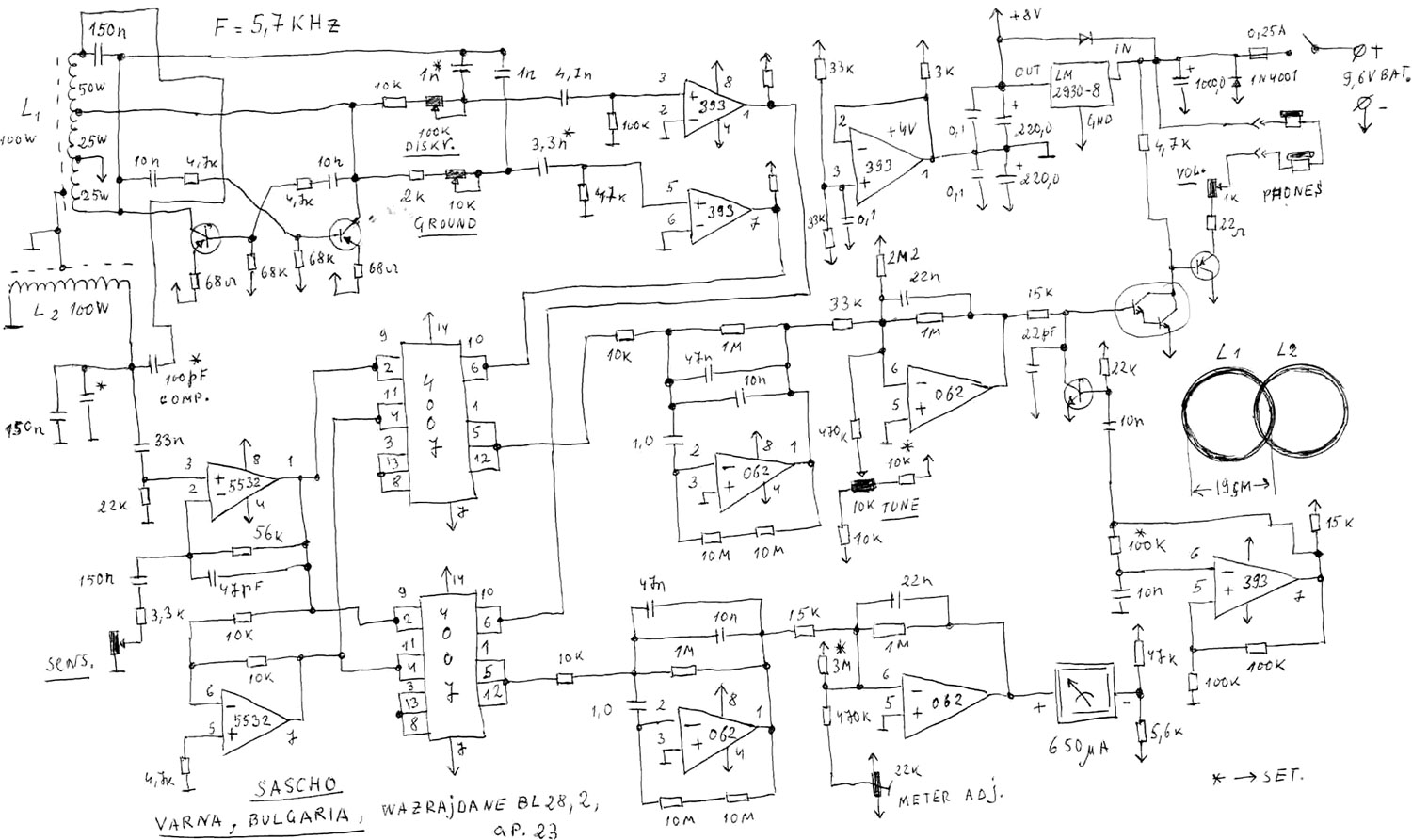

    Here is reposted Sashos circuit design not available at original thread
    Coil configuration is the same as Grozdio Grozdev REBEKS metal detector design. Built in Bulgaria 30 years ago.

    Why building this one?
    * I never made any of 'REBEKS' yet.
    * Very good Saschos design: NE5532 at input, 4007 sinchronous demodulator, VCO ad-on
    * I'd like to play with coils tunned in full resonance for which I belive this is ideal project.

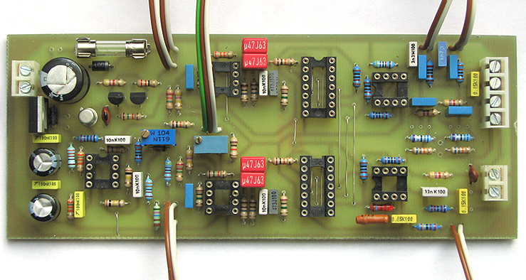

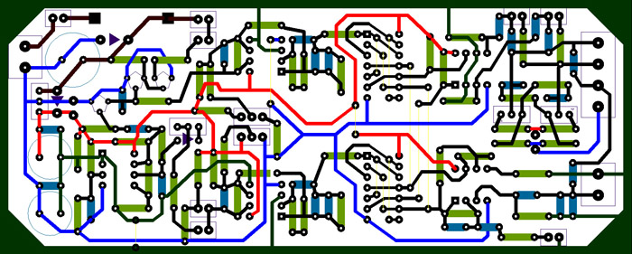

      PCB ready
      Thanks Max,
      I have checked TGS thread - became realy fat.
      I'm quite interested in Vladimirs TGSL PCB designs (excelent work) and also have Silver Sabre project to finish; maybe even Barracuda now with Geo involved...
      But it wouldn't be quite my way to work ''linear'', seems that I need few unfinished projects sitting on my desk.
      So back to Saschos design.. PCB just finished.

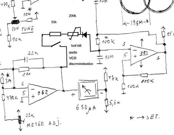

          VCO part

          Forgot to attach VCO audio part... here it is.

                      As I see main differences in circuit are at demodulators - seems that first models were made with transformers (to obtain low voltage levels?) and diode demodulator and later with FET or switching ICs as 4066 and 4011 synchronous demodulator. Saschos design with 4007 looks like the most elegant.
                      Sascho (are you here?) did not appoint transistors and few resistors values. My PCB is designed for TO-5 transistor packages and TO-220,225.. at TX but probably almost any transistor will work.
                      Tomorrow missing parts will be purchased and then the big question: will it work?

                          Missing values of resistors is 10k and potenc. SENS. is too 10k.
                          Transistors may be BC557 ,but I'm not sure of this!
                          Any body have a information where is fit resonance capacitators?
                          In search head (coil) or PSB?
                            values
                            I was thinking about same resistor and pot values.
                            On audio section I will probably use BC107,BC177 and BC517-darlington simply because of frequent use in Saschos design. I'm sure also BC547-550, BC557-560 pair would work. For TX part I'll probably use something in to-220 packs: BD136, TIP32, PN200 maybe BC640.
                            You will need to adjust only capacitator marked * at RX coil for tuning the coil.
                            If you need to alter TX frequency than change caps or resistors in cross coupled RC oscillator.
