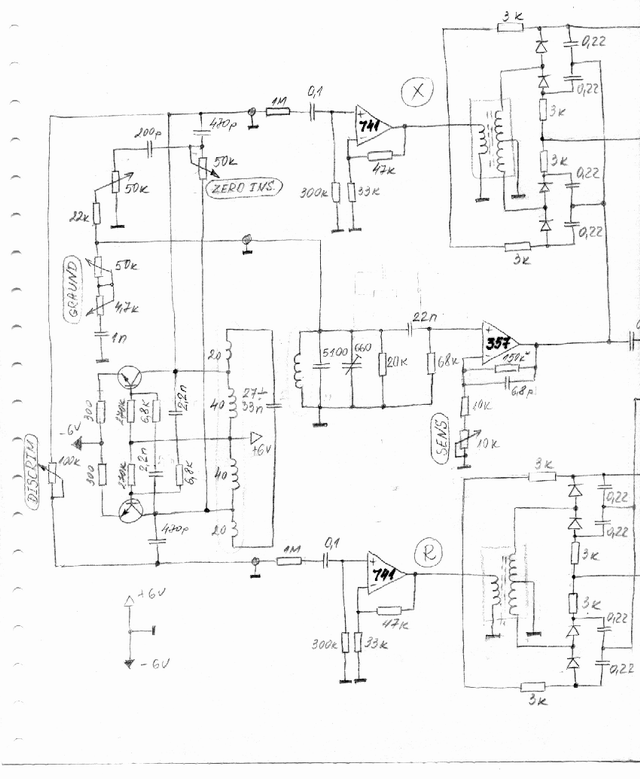

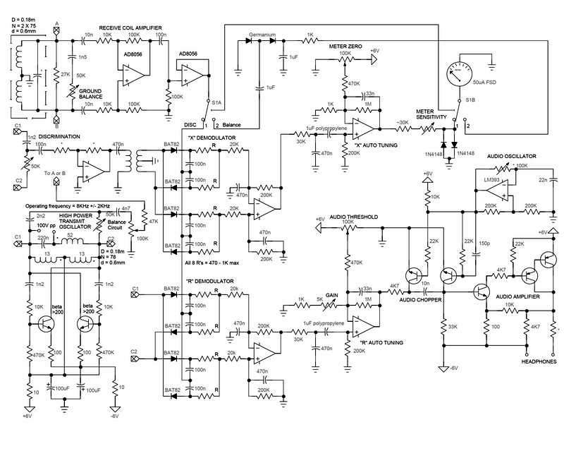

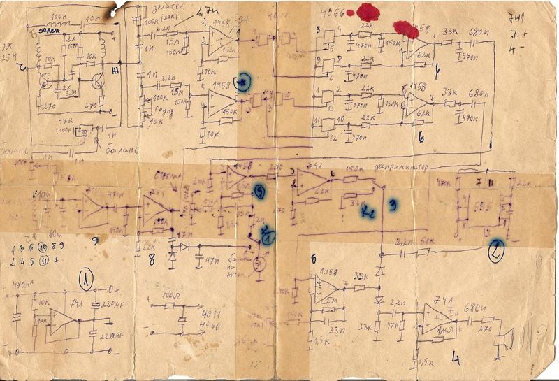

  • Yes the scheme is that. Is somebody made it. Is it stable enough, is the sensitivity as its written on it 30 cm/5 st. in the ground, can it compensate the ground effect. Also there is some details which haven't values: on the input '+' of the upper 741 op-amp. How the sound come up: is the last IC 555...

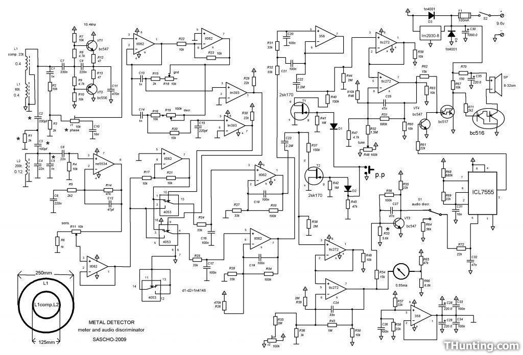

    I'd like to compare it with the Sasho's circuit which is with 2 CD4007 and 2x19cm. coils mentioned in other threads.
    If someone can help I would be very thankfull.
    • Sascho scheme works very well in 8 khz.Transmitter and resiver coils capacitor must be 68nf.

        Grozdanka is a good detector, Sascho's is a little better and and have more details about the construction. But pay attention to Pompey comment #143.
        • OK, 50cm/1 euro is fine. I think its on ear. As far as I understood he uses a bigger coil 2x21cm or so. What about the 2x19cm coils? How much is the depth with them. Can I get 20mm coin in 30cm in the ground. And how it behaves on the beach? Can it work in wet with salted water sand? Is someone made such tests?
          • BG detector-corrected schematic.This is not old legendary GROZDANKA schematic from ing.Grozdio Grozdev.Click image for larger version

              • I see. So you have made it right. Then tell me please the result of it: depth, can it be used on beach. Also the values of C and R on the '+' input of 741. I think I can use LM324 instead of 2x741 and 1/4 for sound generator instead 555. Instead tl081 I shall use LF356. What you think about.
                You said that Sasho's scheme is a bit better: in what its better - in depth, in stability....
                Tnx
                • Hi xycy.
                  Sorry I made ​​a mistake with Pompey post, is not # 143 I thought of #142, where he gives advice to do another project of Sasha - "S1".
                  Sasho's scheme (with 2 CD4007) is a bit better in stability, I think it can not be used for the beach with salt water. "S1" that could be used on the beach (unfortunately, "S1" has a bad audio discrimination)...

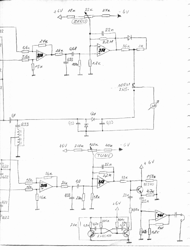

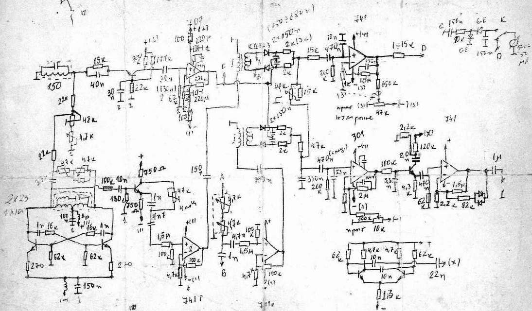

                  And you xycy if you want to build a certain "Bulgarian Legend", here's some schemes:Click image for larger version
ID:	333485Click image for larger version

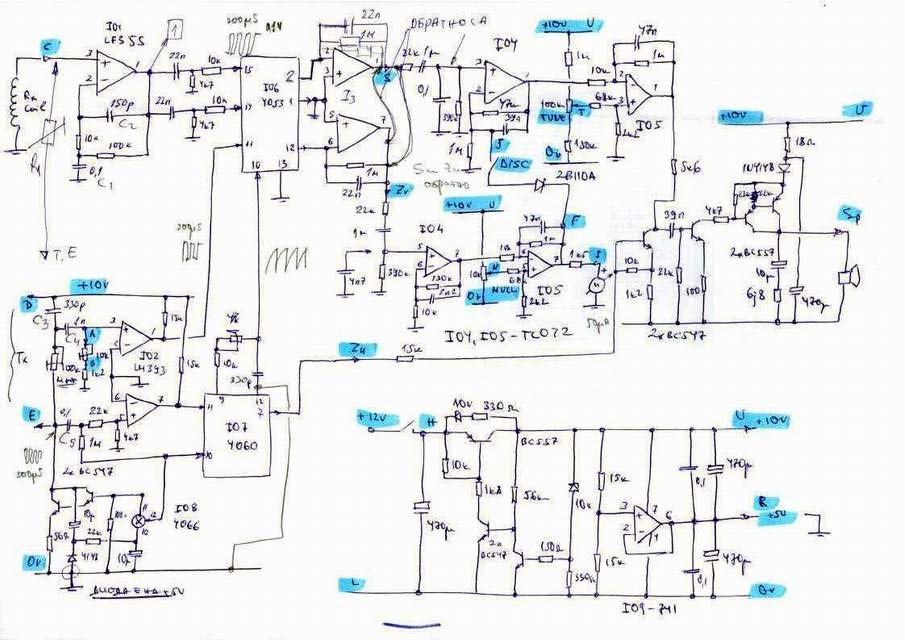

                  • Here's more:Click image for larger version
ID:	333487Click image for larger version

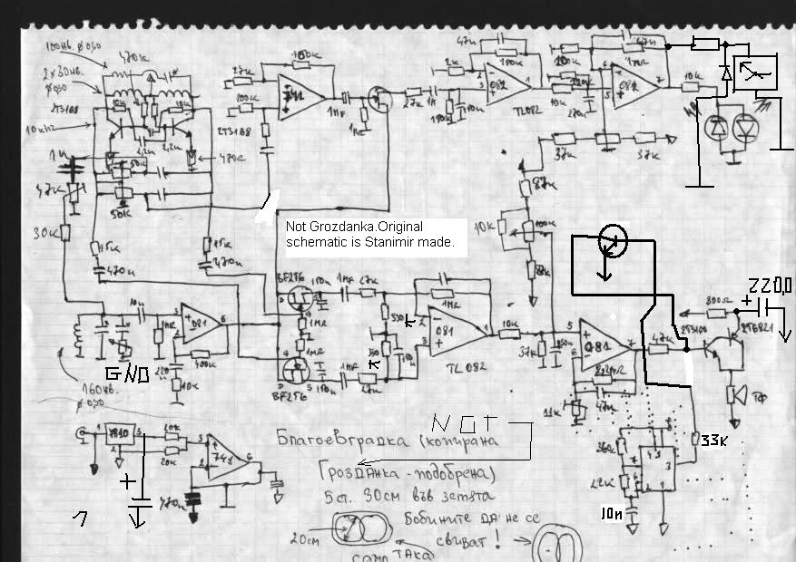

                    • And more:Click image for larger version
ID:	333489Click image for larger version

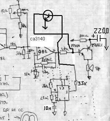

                      • Tnx Maikl. Can you tell me the values of the resistors to pin 1 and 7 of LM393 on Sasho1 circuit please. I suppose that I can use tl084 instead of 2xtl062.
                        • Resistors to pin 1 and 7 of LM393 on Sasho1 circuit is: R26=22K and R25=22K. Try the TL084. Here's a link to this forum where you have more details about the construction (pay attention to "S1" and not "S") http://www.geotech1.com/forums/showt...metal-detector
