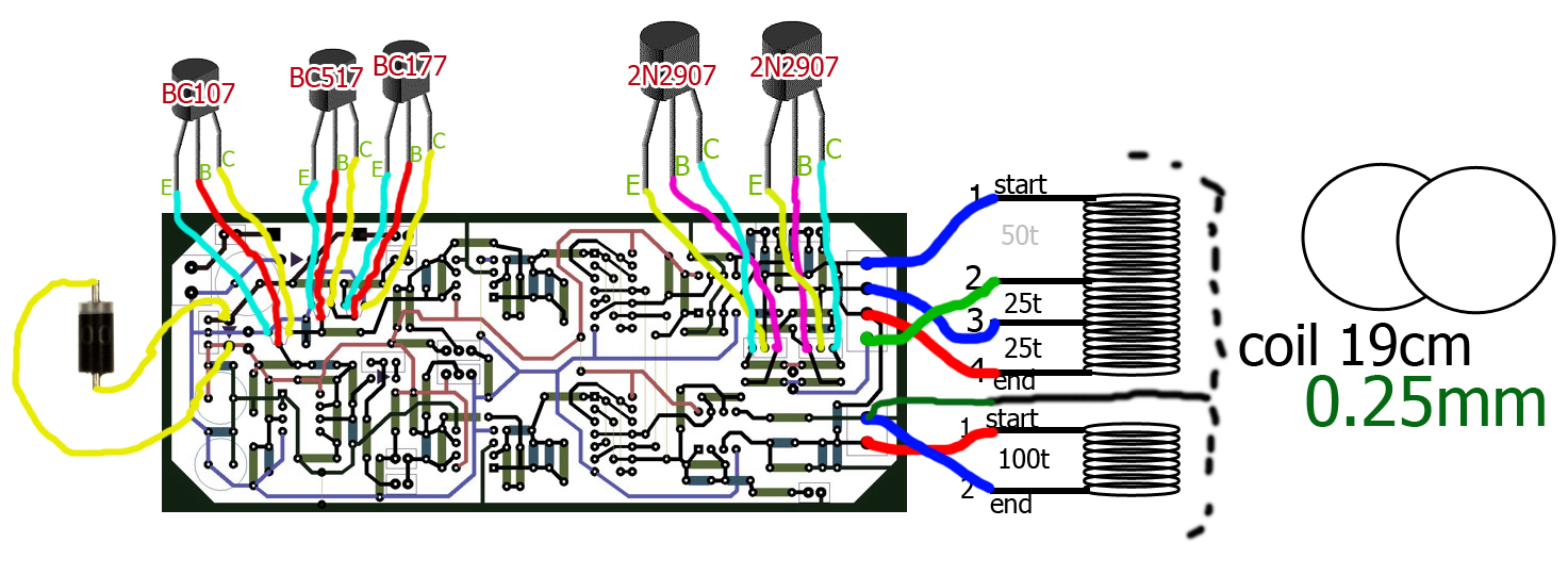

    can you tell me , What I did wrong On the attached picture. If you answer to this question you are realy help me.
    By the way Results 2.2 coin in Air 22cm, Rejection Hot rock and Iron.
    When I'm rmove C28, coin 2.2mm in air 30cm Rejection Iron and read hot rock.
    Best regards

      • Originally posted by salih View Post
        No one can help
        as I said before I did not made this MD, just experiments with oscillator and coils, it's all about that, be patient and try to tune coils properly
        resonant designs are all about that: if properly tuned you have great sens and good disc and geb BUT a little mistake and you'll get lot of troubles and no good operations
        btw you need oscilloscope to properly tune phase shift, though this is not mandatory for nulling (can use other strategies for just nulling)
        my advice is to review VERY carefully your PCB for mistakes (the pcb is small, few stuff, requires just few time), then wirings and last if all OK concentrate on coils, there's at 99% the problem and if you fix that almost sure you'll got extra depth and good disc and geb
        belive me, Sascho design seems very nice just looking at schematic, the only problem in replicate it is at coil tuning; not to say once you have properly tuned MUST fix everything very hard with epoxy, otherwise wil untune easy at first movements: coils must be rigid as iron in these VLFs, absolutely mandatory, and do not forget proper shield otherwise once you go on real soil you'll get erratic from charge coupling of coils with plane of soil
        regards,
        Max

          Thank Max very much
          All you said is true
          Now I get in the air 35 cm and 27 cm in the soil (((Diameter coin 2.2cm)))
          and i think this Detector very good from Tgsl
          Thank Max very much for tip

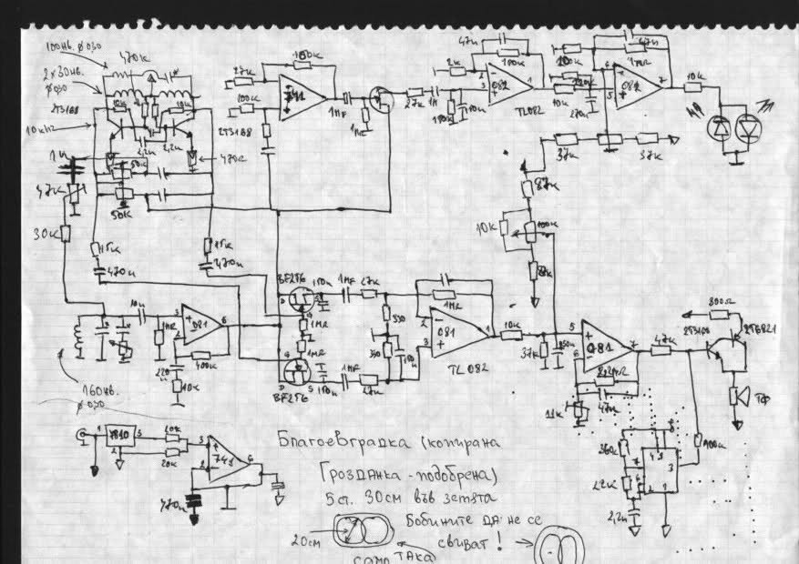

                          • Здравей Наско,
                            Искам да направя една Грозданка: 2х160н. на ТX и RX. Можеш ли да ми кажеш коя схема е по-добра: на Сашо с 2хCD4007 или на тая Грозданка.
                            Благодаря
                            • Originally posted by xycy View Post
                              Здравей Наско,
                              Благодаря

                                Здравей xycy.
                                Поставете схема Грозданка, за да се види и ще получите отговор.
                                Е същото, тъй като това?
                                Hi xycy.
                                Set Grozdanka scheme to be seen, and you'll get a response.
                                Is the same as this?Click image for larger version
