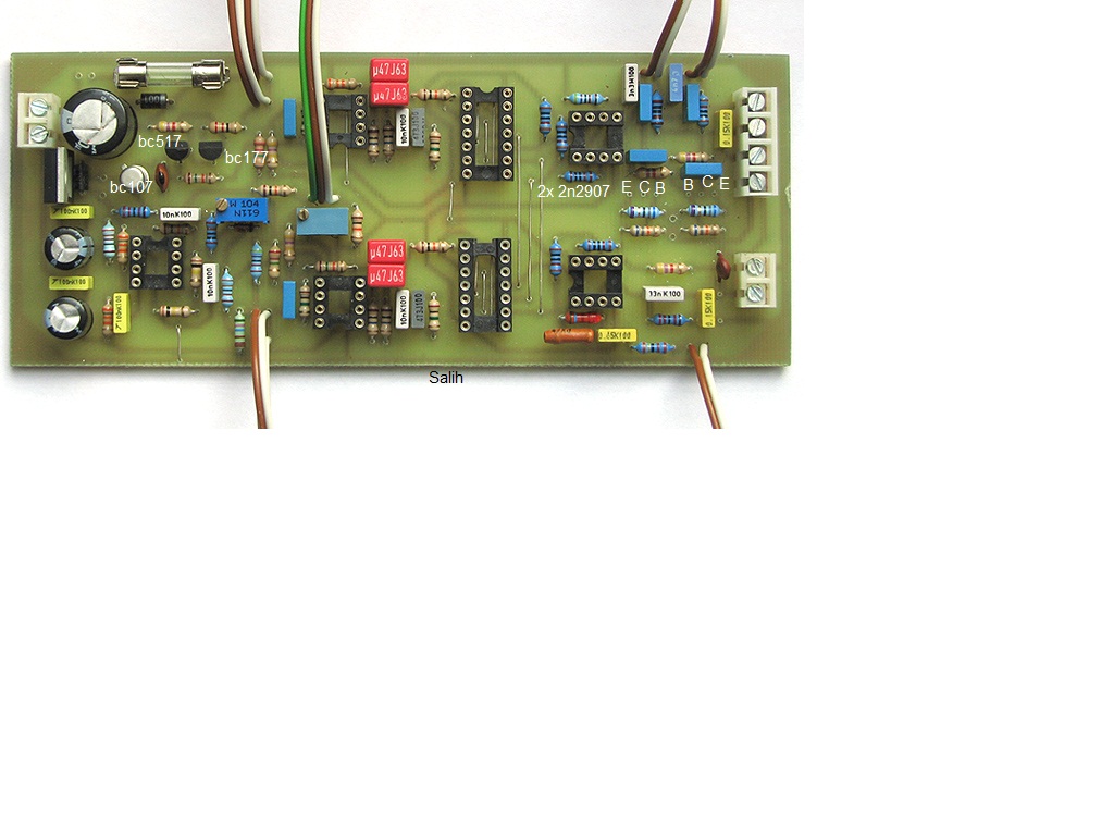

                    • Does anyone have a picture of the connection of the diodes and transistors
                      • Which will you help me with transistors. Thanks in advance
                        • the Way connected transistors
                          • I weave them BC 177 ion but very hot
                            • Originally posted by emoxristov View Post
                              Make sure you put the pin Tr 2x 2n2907 in the right place ECB BCE
                              • Exchange in oscillator transistor base-minus resistor 68k to 100k.Not transistor problems.
