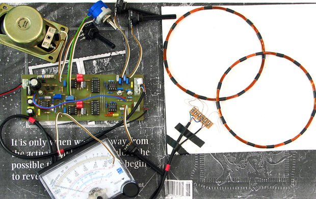

                      eagle has landed..
                      I could not find that PNP pair so I tried with good old 2N2907 for TX transistors.
                      Coils made for testing have folowing params:
                      Tx ID-12cm, 128-Turns (64/32/32), 0.2mm wire
                      Rx ID-12cm, 128-Turns, 0.2mm wire
                      Resulting Frequency at first 779kHz
                      First I checked power: Voltages were not symmetrical (+3.2V,-4V), I removed 3k resistor to get voltages right from 393 voltage splitter - mistake in drawing?
                      40mA overall consumption.. Treshold can be adjusted to hear nice and very loud tone (25ohm speaker), meter circuit can also be adjusted - zeroed very well.
                      Further I tried to null the coils and when I had them in proper position frequency went to proper range - 5.85kHz. -> Quite strange, I never seen that before when adjusting coils? Also have to check those 150nF resonant capacitators..
                      IT WORKS!! From start? I actually did not belive my ears at first.
                      50EU cent - 26cm in the air with 12cm coils - pretty good as I even did not troubled myself with fine adjustments..

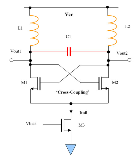

                      Attached is simillar oscillator - I have to figure out power control - more usable than sensitivity pot.
                        PCB
                        As promised here are PCB files. Original AutoCad (.dwg) drawing is included + some generated raster files. PCB dimensions are 15 x 6cm.
