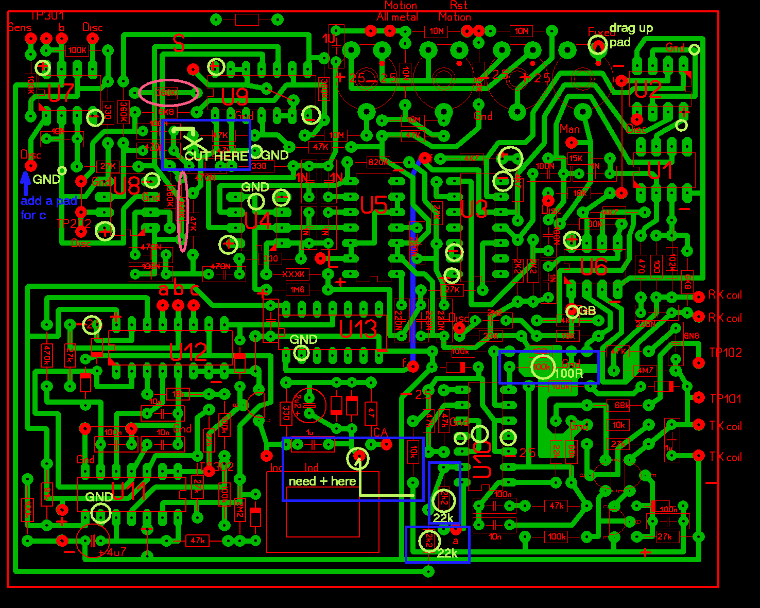

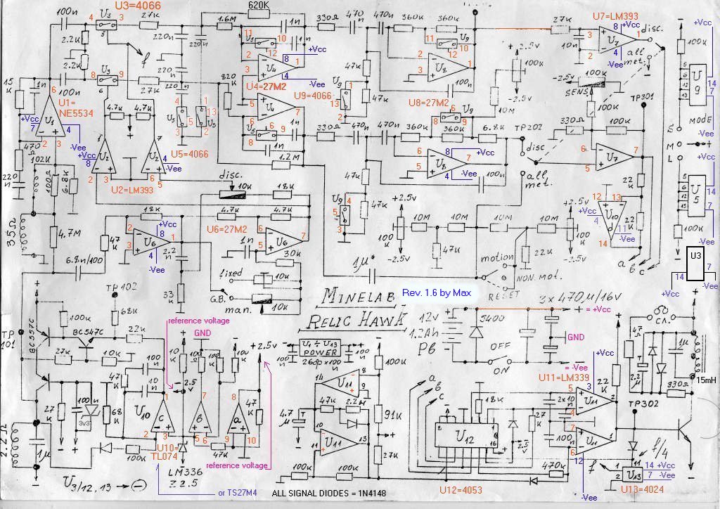

      I think I found a mistake there... I cannot find the 1M2 resistor on PCB... noticed just few minutes ago.
      I think I will add it under the PCB.
      About inductors I have many but made expecially for RH two custom 15mH and 1mH today.... Already soldered.
      I avoided using the transformer kind of shape and used instead a neosid support/core that was of an 22mH inductor.
      Same I've done at 1mH part... made it and used acrylic varnish as finiture...
      PS: about space... the PCB is small but right for most parts... troubles I had at 470nF caps, 1uF and 470uF too... too close one each other... and space is so few.
      I'm around 45% of parts now... it's a little monster this RH!

      • Hi Max,
        Yes i have seen the resistor is missing.But i should be able ot make it fit.
        If you have time you could show me where there is problems so i can try to make it better.

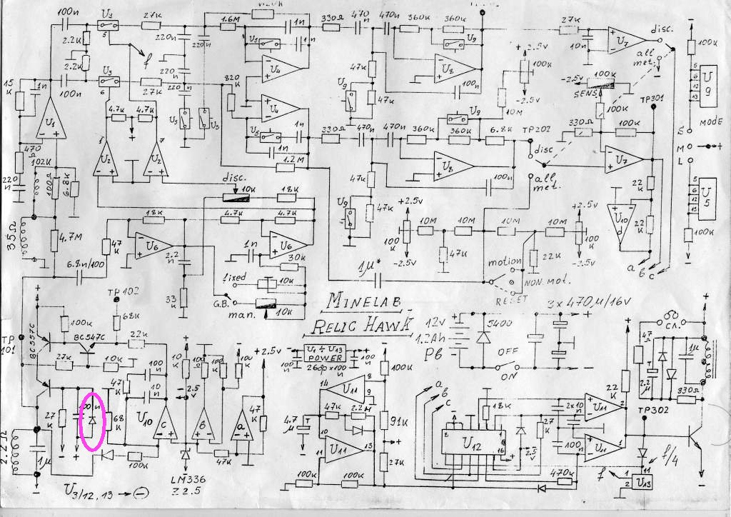

          found another bug: there's a repeated 360K resistor there... I solved not mounting one of the highlighted ones in the picture...
          Kind regards,
          Max

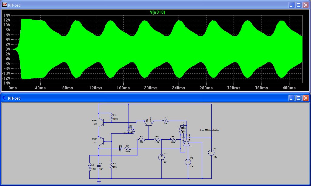

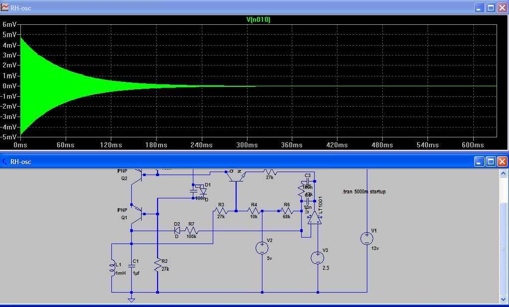

          • uhm...seems not so happy in simulations...
              Max,
              Is D1 supposed to be a straight diode or a 3.3V Zener? I know that Coinseeker was a cheapened version of Coin Hawk without many of the features, but the oscillator circuit is essentially identical except for the diode that you have labled D1.
              J. L. King

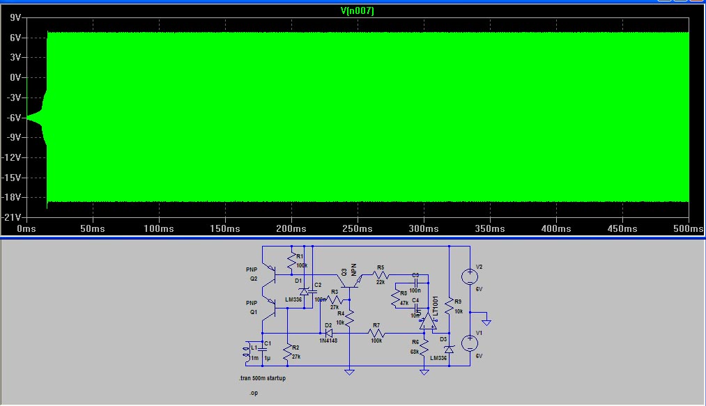

              • It likes this better!
                • It likes this even better!
                    yes, right... in RH schematic we have it's reported as a regular diode... but it cannot work this way so I think too there's a zener diode there...and now that I saw your simulations I'm sure of that, thanks.
                    I'll made another revision with that error corrected.
                    Kind regards,
                    Max

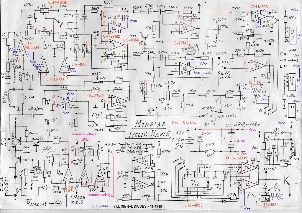

                    • Hi,
                      Here's revision 1.5 of schematic.
                      Kind regards,
                      Max
                      • Hi,
                        now the question is: can we trust coinseeker schematic about value of that zener diode ?
                        I don't know... but I see change few if you use 3v6 or even 6v2 zeners there, at least I cannot notice any difference.
                        It works also with a regular diode (but reversed respect to original schematic that's wrong way), but I think the zener solution is right cause a reverse polarized normal diode make no sense to me there.
                        I don't remember if I have 3v3 (I think yes) but otherwise will use 3v6.
                        Kind regards,
                        Max

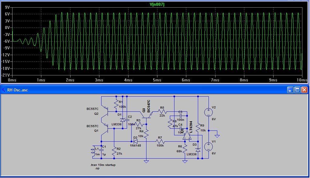

                            • Hi,
                              here's simulation with 3v3.
                              There's about 25Hz modulation of the 5Khz carrier...
                              Kind regards,
                              Max
                              • Hi,
                                this is revision 1.6 , corrected bad voltage pins at U10.
                                PCB is already right way.
                                Kind regards,
                                Max
