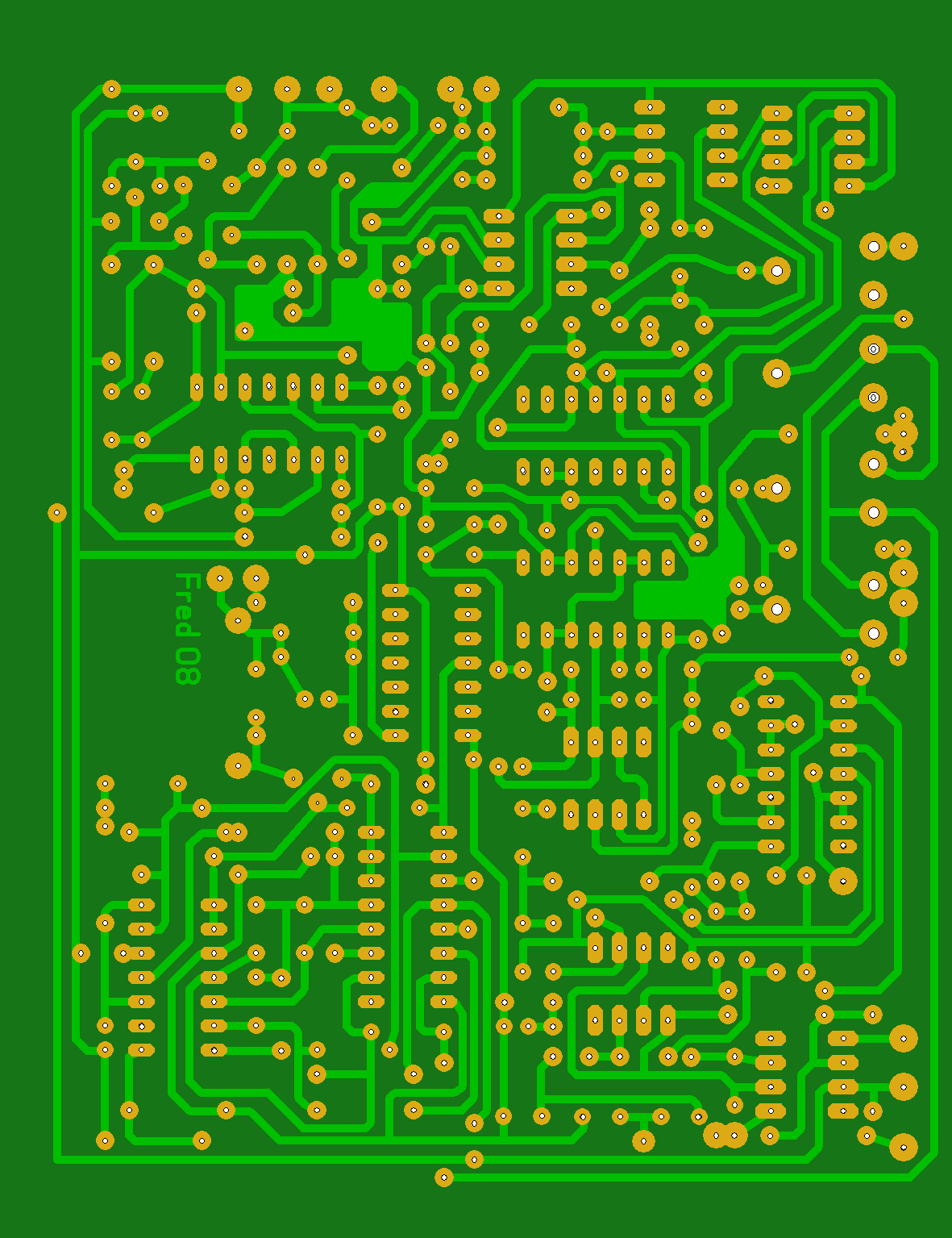

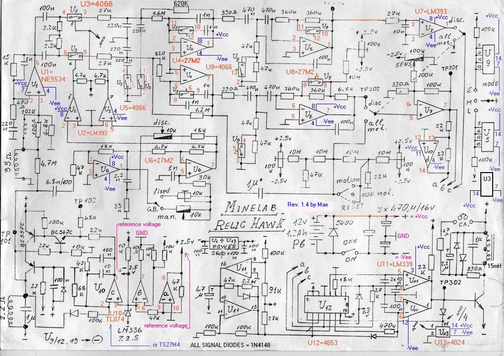

  • Hi Fred,

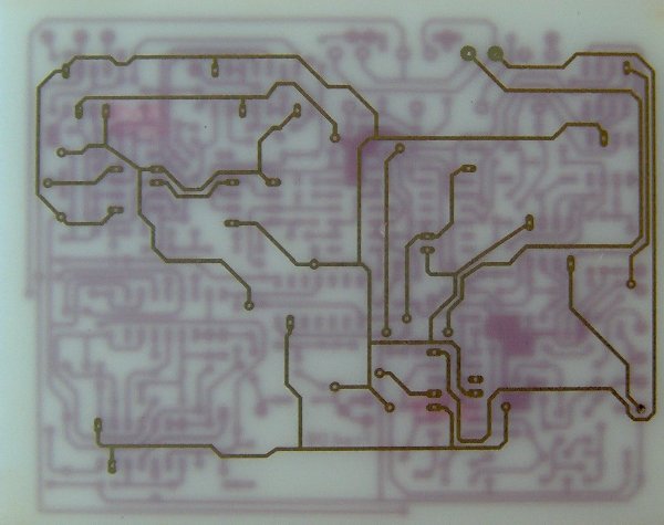

    I think we are ready to go... I'm checking a bit the whole thing but till now don't see mistakes.
    I've made revision 1.4 of schematics with just few informations more:
    - 15mH inductor value
    - all diodes 1n4148
    - unknown resistor now is 620K
    I'll do some check more... if find something interesting I'll report here, otherwise we can go for PCB making.
    Kind regards,
    Max
    • Hi,
      I did not find any mistake... so I'm going for PCB!
      Very nice work Fred!

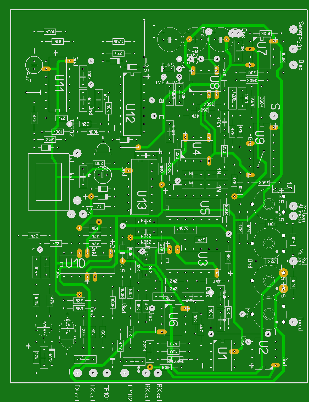

      I'll do as regular double side... but people who wanna use just single side sensitive boards could choose 2 boards with thickness of 0.8mm and then make them separately, and at the end glue them with epoxy before drilling like a sandwich.
      Finshed sandwich will be around 1.6mm thickness so good for standard components and (though maybe ugly) functional like regular double sided FR4.
      Kind regards,
      Max

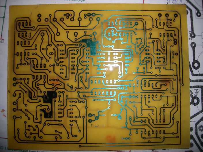

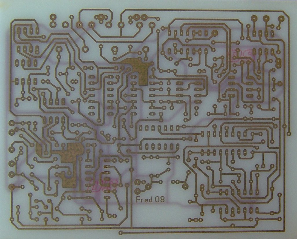

          Hi Fred and all,
          here we are...
          Done... now need drilling and patience with components selection too...
          But board looks pretty cool... little Max's out-of-specs manifacture... particularly suited to this project.
          I hope all you guys will do it soon too so we can share results and impressions.
          Kind regards,
          Max
            • Nice PCB Max,
              Mine is failed, for some reason the developper didn´t work, so i quicly made a new solution but it was too late for a nice result.
              It was the last double layer of this size i had,now i have to wait one week+
              Good luck with yours,
              Best regards,
              Fred.

                  Hi Eugene,
                  I give you some advices for p-n-p...
                  press-n-peel is good but you need extra care in positioning the second layer you made, so the second sheet to match exactly the one you already transferred on copper side at bottom.
                  I do that with photoprocess using some reference cross at edges usually, but in this particular case I preferred using some drilled holes in pcb on particular point in the pcb where there are double side pads.
                  Also, make sure you print all by print command and just select copper layers, without silkscreen. Also remember you need to mirror bottom side before you print it on p-n-p.
                  Hope to see your board too soon.
                  Kind regards,
                  Max

                    Hi Fred,
                    I've used the last I had too... I forgot to order some... so I did yesterday but I was lucky with that last board and got the pcb.
                    I've also some double I've made past years... they are under black paper in my garage... but I don't trust them much cause are too old now (7years) to give me the kind of quality I need for this project.
                    I made lot of custom presens boards in past years but the process is tricky and the smell.... wow... something incredible... and so I stopped making them at least for now.
                    Hope you'll do it soon. For now I'm collecting stuff... found all ic I need, but there's other stuff I still did not find...
                    I'll keep you informed of progress.
                    Kind regards,
                    Max

                      Eugene,i used PnP but i didn´t like it too much.As Max says here we need good quality, i drilled 2 pads at extreme positions too to position the double layer.
                      And yes, you need to mirror printing of upper layer, i didn´t do so and it worked fine, but it is better to do so.

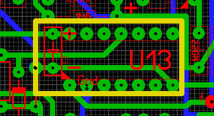

                      • Hi Max and Fred,Is this right or wrong.Grt Nakky
                        • Originally posted by nakky View Post
                          Hi Nakky,
                          it's right way. Have you finished your PCB layout?
                          Kind regards,
                          Max
