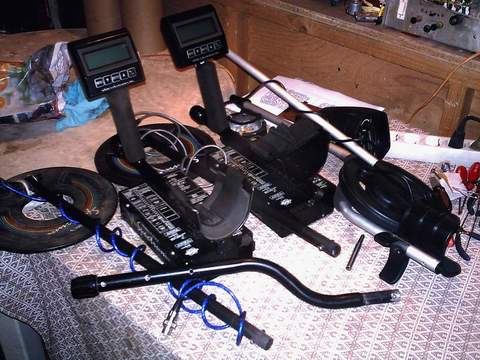

                          • Hi
                            I just looked again that comparing chart of detectors depth that someone have posted here.
                            XLT
                            have almost double depth compared with RH!Minelab RH is no more on tird place there.
                            If we wana make something impresing this is it.Combined PI techology+.............
                            So.Can we do it?
                            Have anyone opened such device?

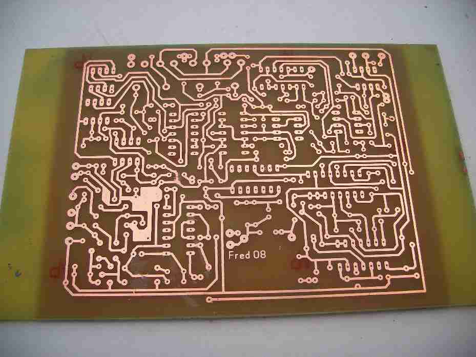

                            • RH Pro V.99.8 II special
                              Fred.

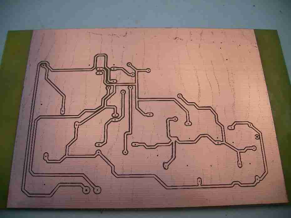

                              • Nice pcb! Neat work!
                                XLT....Yup!
                                No wonder i switched to Eagle Spectrum recently! It does make difference for real! Only problem is i can not copy it...to complex for me. Also i dont have firmware for those two uPc's...
                                Look this photo and enjoy!
