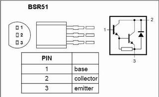

    Ivconic told us it is no J-fet, just transistor.He knows what he says.
    Max, what transistor did you use for audio output? BC517?
    regards,
    Fred.
    yes... about... it's a C517, Japan made.
    Do you think at its higher gain as a problem ?
    Kind regards,
    Max
    • No Tiktak, i am far away from any work in my workshop, for now. Resting and doing nothing.
      Yes it is transistor for sure (is this deja vu or what??). It says "SR51" at both machines i had; RH and Colt. Later i found out it is BSR51 (guess they were lazy to print "B", or paint saving??) .
      So if it is BSR51 than BC517 is proper replacement, although there are other transistors to do same job there...
      But...than you still must use earphones. If speaker is nedeed than audio must be modded. Guess Bulgarians solution at Coinseeker could be a starting point...

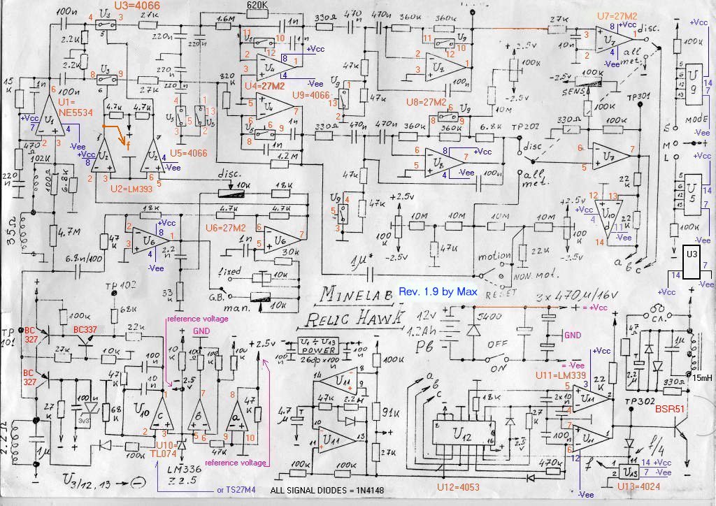

      • schematic update
        here's revision 1.9.
        Corrected the "f" line according to the discovery made on Musketeer board.
        Kind regards,
        Max

              I've made a simulation till comparators... and got about same phase I get from measures...
              .... So, the PCB/circuit is like expected, no errors and timing is the same as from schematic we have.
              This confirms problem is somewhere else... maybe at coil ?

                    • mistakes... and more mistakes...
                      Max,
                      What are/is your battery(s)/supply level? I have found that some of the circuits REALLY do not like marginal voltage (especially the oscillator).
                      In that same area, I am still trying to find out what their "low battery warning" sounds like (the manual fails to tell you this).
                      J. L. King

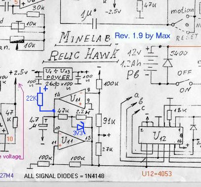

                      I think there are other mistakes...
                      Looking at battery checker I found strange the absence of a pull-up resistor at pin14... so I think it's just another mistake there.
                      Also, I think the diode at comparator is actually some zener , 3v3 or something like this, another mistake there!
                      Now... with changes like in the picture... I think it will detect a 4.2-4.25V drop at battery... giving a steady tone to the speaker.
                      If battery is charged , each cell has voltage of about 2V... but to have 4.25v drop each cell must have (12-4.25)/6= 1.29V, that's reasonable for lead acid cells in heavy discharge.
                      Actually many manifacturers consider lead acid cells discharged already at 1.6V... but in RH probably the breakdown voltage is around 8V for the battery... when under 8V, say 7.75-7.8V, so about 35% voltage drop, the battery checker stops normal operations and start infinite singing.
                      Do you think I'm wrong on this ?
                      People that have used it for long time must know about this. Please confirm.
                      Kind regards,
                      Max

                          the real problem is the diode ... if you leave it there it will not work, need a zener there.
                          If leave a common diode there you'll need fairly large drop of battery to get it commutate.
                          I think there was a zener not a normal diode... but I'm not 100% sure of this.

                            • Hi,
                              I've simulated battery checker and seems with the simple 1n4148 it works, but need the famous pull-up on pin14.
                              The battery checker trigger alarm when voltage drops under 9.25v in this case... so about at 1.56v per cell, that's even more reasonable value.
                              So, I'll try to add the pull-up only and see if it works.
                              Then, if all OK I will made another revision of schematic.
                              Kind regards,
                              Max
