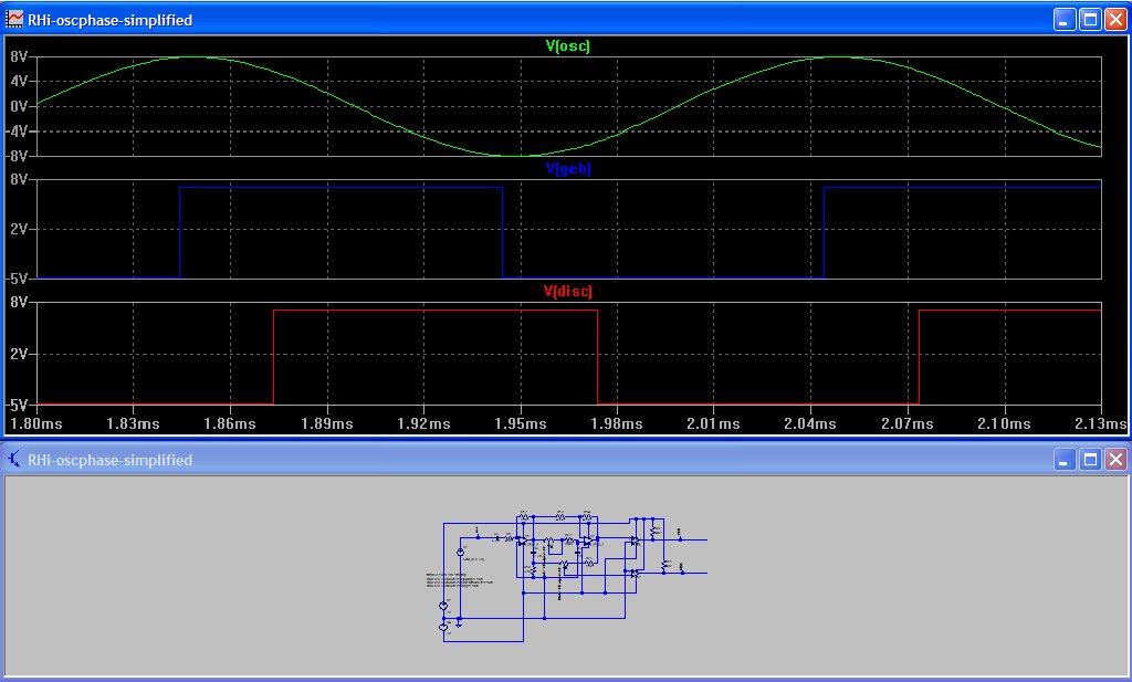

                      • update... about phase
                        I've made a simulation till comparators... and got about same phase I get from measures...
                        for example:
                        in measures I get 79.2° for GEB at fully CCW and I get from simulations 82.48° there...
                        You see... not big differences... about 3-4°... maximum I've found is around 7° about disc that happens only when geb pot is fully CW.
                        So, the PCB/circuit is like expected, no errors and timing is the same as from schematic we have.
                        This confirms problem is somewhere else... maybe at coil ?
                        Kind regards,
                        Max
