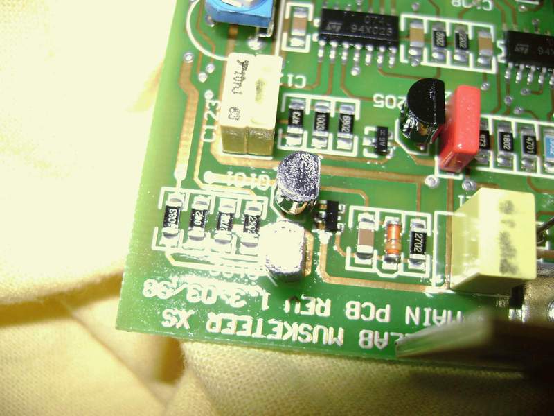

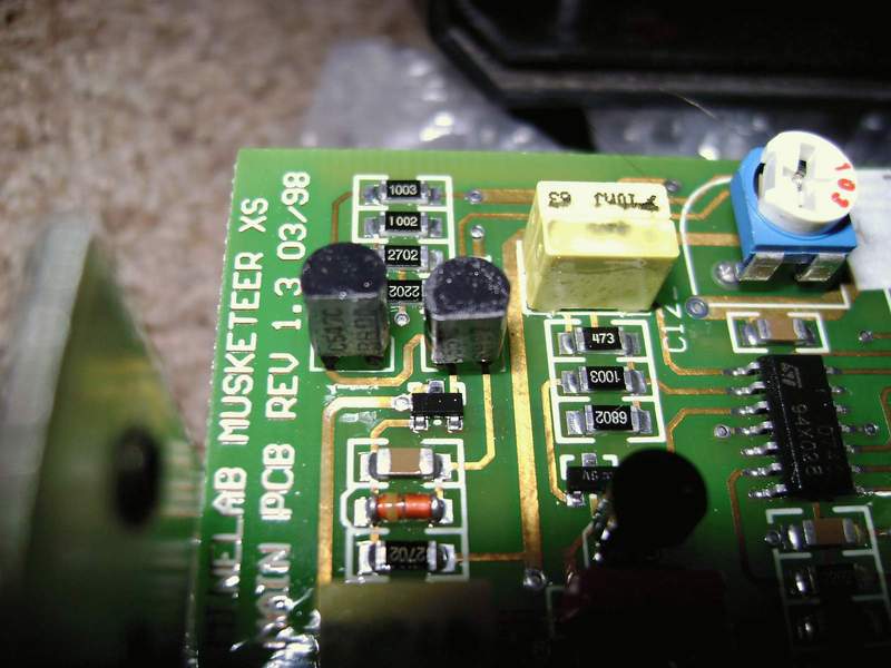

        • Look this shot. It is so clear those two are BC547 and BC557...
          Third one ( and probably most important one) is smt...and i can not see any label...hmmm...
          • This will clear any doubts.I will be glad if we make it work.

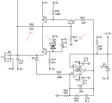

                    • Diode D1 is turned around backwards in Ivconic's last drawing (on page 32). This was a 3V3 zener in a previous schematic. If you remove the diode completely you should still have an output but if you turn the diode backwards you will be dissapointed. I use 1N746 in the simulation.
                      Also, the 10k and 27k resistor on the base of NPN Q3 have been switched. It will still run, but you will have much lower distortion if the 10k goes to ground and 27k goes to the coil.

                      • That makes sense.
                        Thanks!
                        Maybe you solved problem!

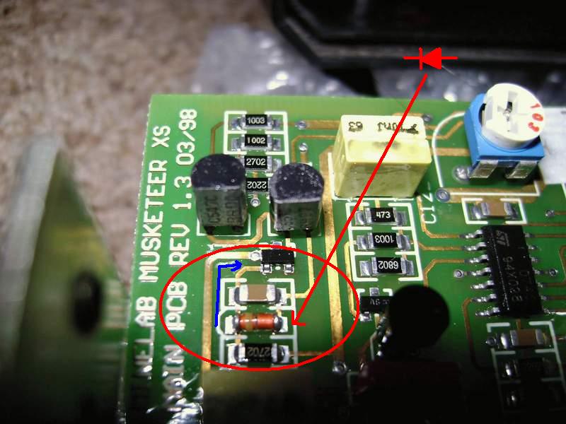

                        But... this photo than confusing me much!

                          This were the major mistake!Now all we need is some fine tuning and optimization.
                          Ivconic the strangest thing is that in original relic hawk this diode is orientated just the way you show.In Maxs schematic its shown Porkluvrs way but in Fred PCB according Maxs scheme this diode is mistaken and it lays like in your scheme.
                          So strange but now its work!I told you about those resistors.But how I couldnt spot this diode.No meter now.
