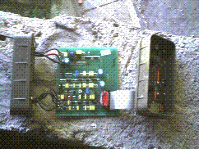

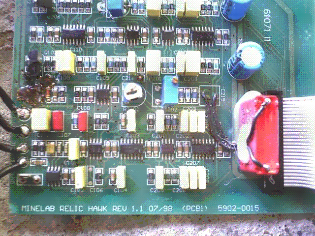

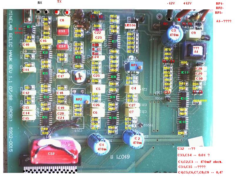

    I HAVE BEEN COUNTING CAPACITORS AND RESISTORS ALL DAY . "A BIG DIFFERENCE BETWEEN RELIC HAWK ORIGINAL AND COIN-SEEKER 2 PRO" !!! IT IS REAL FUNNY THAT MINELAB ADVANTAGE IS 5 KHZ AND ALSO THE CIRCUIT BOARD IS VERY CLOSE IN SIZE TO THE COIN-SEEKER 2 !!! ALSO I READ THE DEPTH COMPARISON OF THE TWO IS ALMOST IDENTICAL !!!!!! I THINK COIN SEEKER 2 PRO IS NOT EVEN CLOSE TO RELIC HAWK. I COUNTED OVER 110 RESISTORS AND CAPACITORS ON RELIC HAWKS FUZZY PHOTO , AND ONLY 26 CAPACITORS ON COIN-SEEKER 2 . I WILL BE WORKING ON THIS FOR AT LEAST A FEW WEEK'S ......... AND THEN A PCB BOARD.. ..............EUGENE

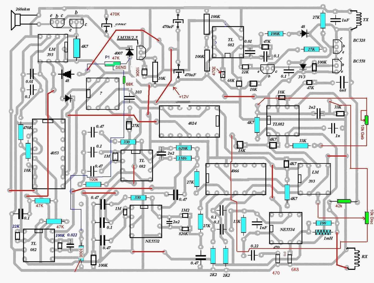

      Compare the 2 circuit diagrams of COINSEEKER 2 PRO and RELIC HAWK.
      The resistor and capacitor values that are changed by "OPERATION MODE" switch ("LMS" switch) are the same in COINSEEKER 2 PRO as having "LMS" switch on RELIC HAWK set to "L" mode allowing for detection of large, deep targets.
      Not good for small, shallow targets etc...
      If you add on other changes done to COINSEEKER 2 PRO then this is reason for unhappiness with COINSEEKER 2 PRO.

      • #78
        RELIC HAWK

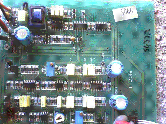

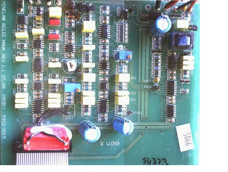

        IF ANYONE HAS CLEAR PHOTO'S OF THIS .PLEASE E-MAIL ME . THANK-YOU.......EUGENE [email protected]

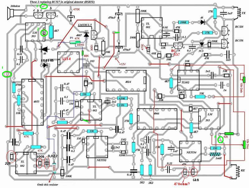

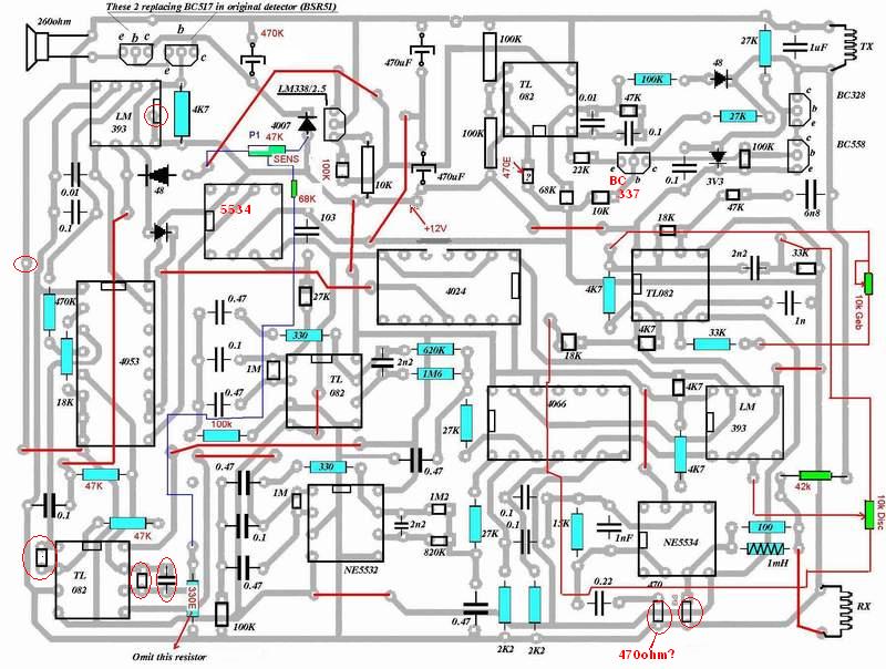

          Did anyone labeled ICs on last schematic right?
          • #80
            Ivica can you tell me what values to try in red circles?

                      Values
                      Here are the values....

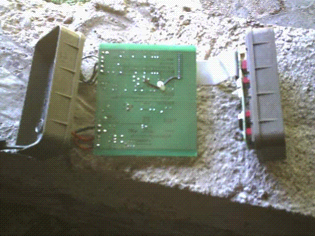

                      • #86
                        But this bulgarian pcb and mod lacks of to many drawbacks. So fianlly i do not recommend it for making.
                        Better to use all posted on this subject and especially that complete schematic and draw quite new,accurate schematic with original components.
                        It is quite possible that oscillator on this pcb will not run from a start.
                        Also audio mod is not good.
                        After to much problems i managed this pcb to make work so,so. I am not satisfied at all. So...i will wait someone to post here another pcb from that complete scehmatic. If not...than i will draw my own pcb...but right now i dont have time for this. Maybe in a month or two...
                        If until than some good pcb project appears than i will use it.
                        • #87
                          Ivica.
                          Thanks for REPLY!
                          Why you have changed your opinion about coinseeker?
                          Please look at the green circles?What are they?
                          Also can you see the green lines that I have added?On the PCB scetch this lines are missed!!!!
                          Thanks.
                          Danm I have almost finish this.

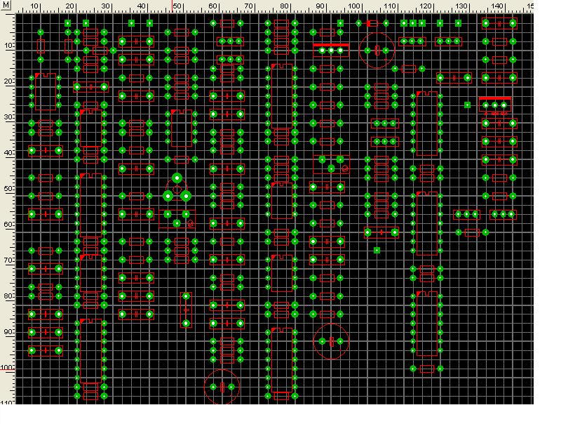

                          • #88
                            Damn
                            • #89
                              Ivconic can you give some more detailed pictures here?
                              And some help too?
                              Can you offer some other replacement for this BSR51?Because I cant find such?
                              • #90
                                Hi
                                This are the parts!Please help with conections.
