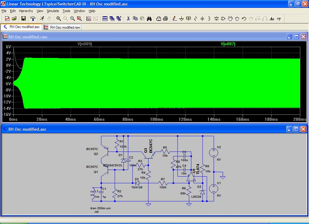

    • Max,
      With 2 changes you can make it oscillate with coil resistance up to 5.5 ohm. Change the zener that is between +6V and the base of the PNP driving the coil to 8,2V; and change the resitor at the emiter of the NPN feed back driver to 10K.
      That is about as high as I can tweak it without making it unstable at 2.2 ohm coils resistance or a significant decrease in oscillator voltage.
      See attached (run with coil resistance at 5.5 ohm)!
      J. L. King

            Max,
            J. L. King

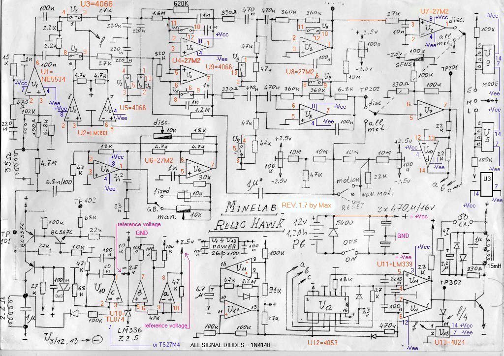

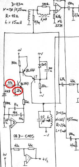

            • Hi Max,is hand draw schematic that Ivconic has posted.Grt Nakky.
              • Hi,
                this is rev. 1.7 of schematic: U7 must be an op. amp. so I changed it to 27M2 as well as for others, not anymore LM393 (wrong there).
                PCB doesn't require to be modified cause of this change.
                Kind regards,
                Max

                  Did you try to increase the 27K resistor to get better oscillation?

                    I've tried there a 33K but without relevant effects. I think problem is that some components are still unknown... as for the last PNP transistor that's maybe something a bit more special than a BC557 I think. The fact it was SMT say they used something particular... maybe available just as SMT or maybe not... but they want/used SMT any case... so we can expect something exotic will make it work on smaller coils but not or not well with traditional gen. purpose PNPs.
                    Though the frequency is so low (5Khz) I think the oscillator design is so critical that only the use of right stuff will make it run smooth.

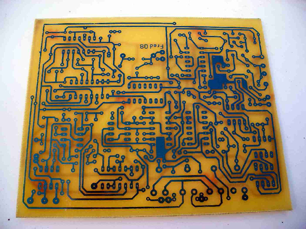

                      actually looking at my PCB as posted here it looks like drawn with a pencil.Quite awfull.
                      Anyway, i think if you have tried with high gain transistors and very fast (RF) ones ,and as Ivconic says it must be a regular type, there is no much more to be done ....I think the 2 NPN together look a bit strange,but this has probably been checked.
                      The other (RX)coil close to the TX one will modify its inductance, and may help to reduce number of turns (or is it the other way around ),but i doubt it will be enought to make much difference...
                      Fred.
                        Fred.

                        • Hi Fred,
                          I have bad news about board... other mistakes:
                          first you need pin3 and pin6 of U2 need GND connection...cause it's missing
                          also...
                          following the signals I found that the 1.6Mohm is connected to the + rail... and that U5 power rails are missing... so you have to cut there at 1.6Mohm and use some jumpers to carry supply at U5.
                          All I solved easy... with some jumpers and cutting some tracks.
                          This way I get good signals till the middle of signal paths at U4 outputs.
                          The circuits seems get fair 50Hz ripple on signal path... that's maybe cause I still didn't mount the 100nF decoupling caps on bottom of PCB.
                          Kind regards,
                          Max
                          • How many mistakes one can make?
                            I also found more mistakes, important too: the 100K resistors that connect U5 and U9 pins 5,6,12,13 that goes to (- ) are missing.
                            Fred.
                            PS : Pin 3 and 6 of U2 have been corrected before.Pse don´t make it look worst than it is !
                              Fred.
                              PS : Pin 3 and 6 of U2 have been corrected before.Pse don´t make it look worst that it is !

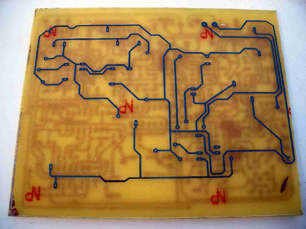

                              • Updated...
                                It is becoming very dificult to increase nº of components...
                                -2X 100K resistor to - from U5 and U9
                                -1.6M disconnected from +
                                -U5 power rails fixed.
                                -Some minor stuff like more separation on some traces/pads.
                                Please someone verify !
                                regards,
                                Fred
