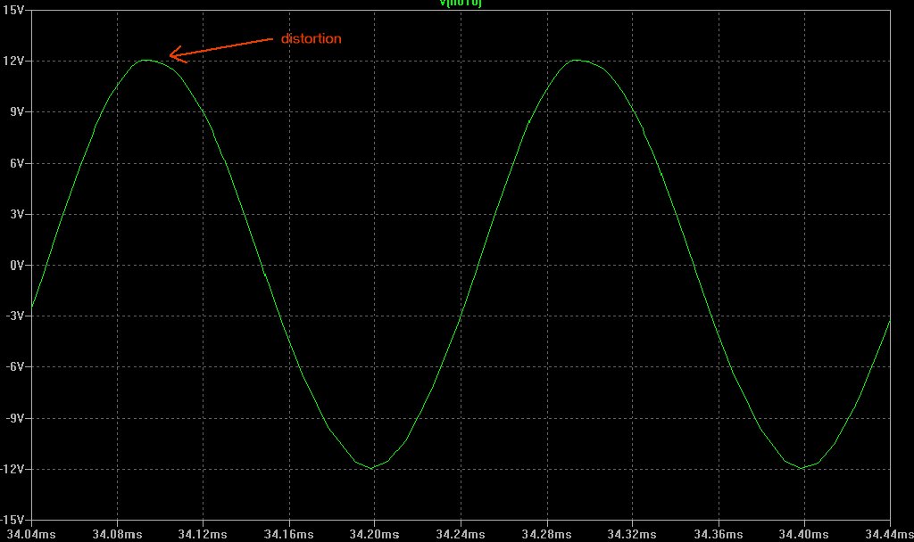

          Now my puzzle of the day is about TX signal shape... cause I noticed a small... really small distortion at sine wave on tx signal... probably due to the oscillator itself or coil.
          The distortion in a bit flattened part of sinus at top positive right end of signal... look at picture to have an idea of it... I didn't take a picture from scope but the distortion is similar to that from this bad simulation.
          The question is: could this so small distortion cause such strange disc behaviour ?
          Qiaozhi (and all) what do you think about ? Too distorted stuff can lead to disc fault ?

            The small distortion you have indicated in the TX waveform is really insignificant, and will have no effect whatsoever on the discrimination. The cause is most likely some nonlinearity in the oscillator. Nothing to worry about.
            It is very difficult to debug this problem remotely. Have you probed the signal along the DISC channel, as you wave ferrous and non-ferrous targets in front of the coil? If you first try to monitor the output of the DISC sample switch with both target types, then you don't even need to move the target, as this will be a non-motion response at this point. The differentiating circuitry is further along in the channel. Try plotting the amplitude versus distance for both ferrous and non-ferrous.
            If this looks ok , then we can eliminate the problem being located in the sampling circuitry.

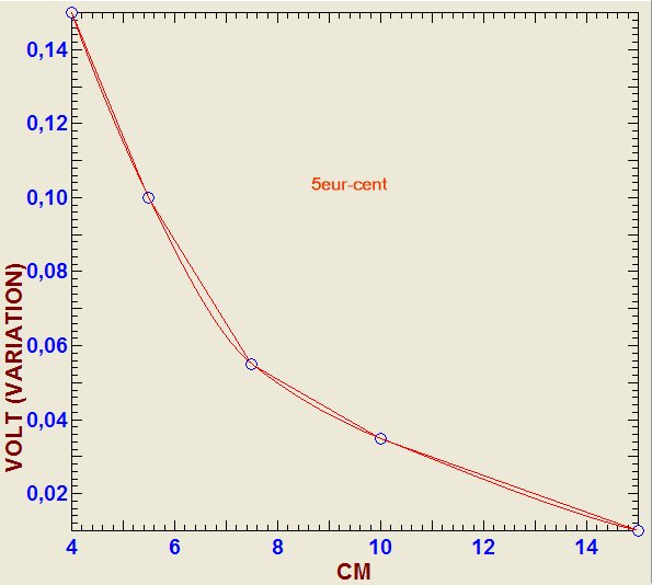

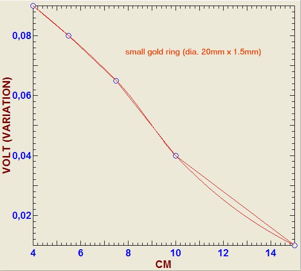

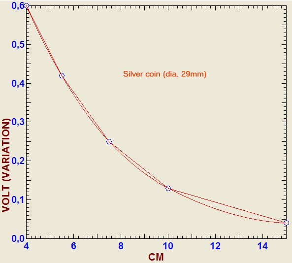

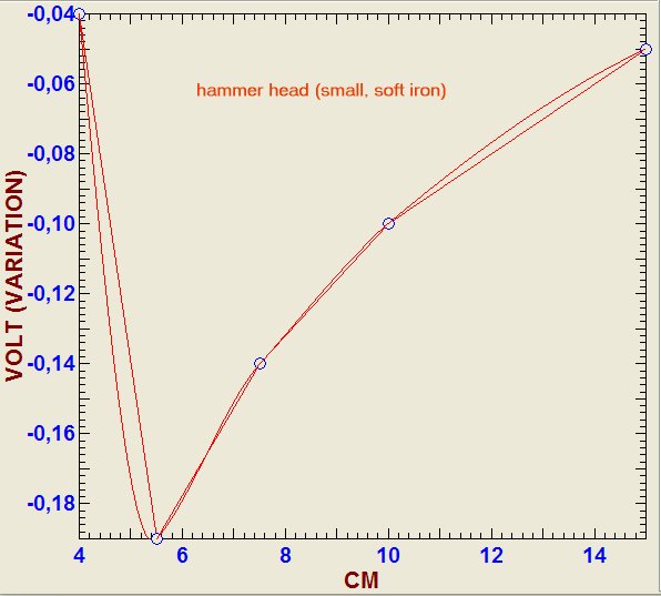

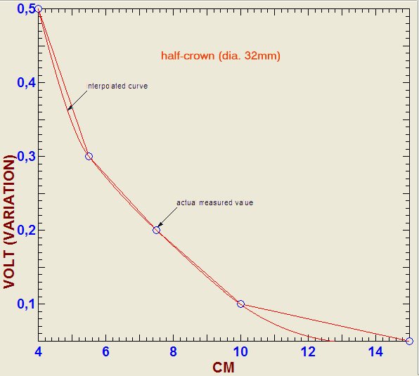

                • seems nice....
                  Hi Qiaozhi and all,
                  here some plots made with data collected for different targets.
                  First some values...
                  At 220nF - 1M6 joint at input of disc channel... just after the sampling gate and low pass I have a 0.22V level above the GND level.
                  Consider that GND is at about 5V over the negative rail... so the level at input is something 5.22V.
                  Now... I tryed retrieving from there the voltage variations... but was impossible task... too small variations and too offset to do it well... so I read them after the integrator.
                  At pin1 of U4 (integrator , disc channel) I have +3.5V above GND when no metal near coil. Coil was nulled at 15mVpp before tests.
                  All metals considered give positive response BUT iron that gives negative.
                  The values are respect the steady 3.5V so positive values for gold, silver etc... and negative (meaning less than 3.5V there respect GND) for iron... just when nearing iron very much you'll get invertion and rise variation, but always negative value.
                  So, consider I've reported in plots just variations respect to the steady state of no metal near. Also consider you'll see points with straight joints + poly interpolation I've added there to get better the picture.
                  Do you think something is wrong with them ?

                    Hi Max,
                    Nice work with the plots,
                    The invertion with the hammer is precisely what i was talking about some days ago.
                    I thought it was possible to cancel it by coil configuration?
                    I don´t understand why you cannot find a way to make coils without this invertion.
                    I didn´t make progress on my RH, i still have a few things i must do while weather allow it
                    Fred.

                        Hi Max,
                        Sorry for the delayed response.
                        These plots look exactly as I would expect. If DISC is not working correctly, then the problem must be located further along in the DISC channel. Can you now probe the output of the first differentiating stage (as before) and let us know the results?
                        The inversion with the large iron is quite simple to explain. Ferrous items cause the amplitude to decrease, but there is a limit on how much it can decrease. As the target gets closer to the coil, the signal will be inverted and start to increase. You should be able to confirm that the same thing happens with the TGSL.
