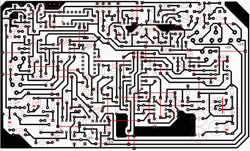

  • Yes...looks ok. I just finished pcb. It is HUGE!
    I dont mind at all. It is through hole, single sided and all the gnd coupling caps are on their places. Good thing is that top layer also can be ground plane. Come to think..; it is not so huge, not bigger than original RH or Musketeer...
    I "crossed" many gnd vias, especially across critical paths. Payed a lot of attention on S/N ratio and hopefully this will "choke" any eventual internal hum. Of course there are many gnd traces that can be carnified, exalted and make a small zones of those. When rechecking i wil also correct those to cover more area on empty pcb space. Pcb is approx 16x10cm... Detailed draw will post after checking.
    Just finished and very tired. Next days i wil recheck from errors.

      It can be optimized later but hard work is done now.
      I like it very much.Look real cute.

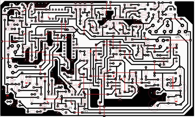

        • This is "mo' better blues" file. Not optimized 100% yet, but good staring point to check and correct more. For those interested...
          Still checking for eventuall mistakes. When i will be 100% sure that it is absolute correct , i will let you know. This thing is going to slowly at me, cose i have much other things to do, these days.
          Regards!
          • Our good friend Nakky found 3 errors so far, on this pcb. I corrected those and here it is latest file.
            Many thanks to Nakky!
            Best regards!

              seems nice, no matter it's 16x10 ...who care about ?
              It's ok having a large board on RH clones... cause spacing is also a key to get less noise from crosstalks there. In board I've made, by Fred, then modified a bit to overcome little mistakes I found high crosstalks effects cause of "small" wiring and upper tracks. I ended up finding also a ground loop I had to remove before get it to work right way.
              The larger board could suffer much less of all that situations and having decoupling caps through hole it's not bad idea... the opposite!
              In my prototype I had to fly-mount downside all that caps... resulting in a big mess to look at when downside! But it works, anyway.
              Now...you made excelent new single side board and so your next challenge is mounting it and testing with coils... but I'm sure you'll do soon !

                  • There should be conection between R65 and R66 no metter that they both goes to + 5v

                          So now my PCB is ready.A little bit slopy but I can start making some excperiments.
                          I have solder those 3 X 470m and 1N4007 that should consist the power suply.And have battery voltage on + rail and no -!Also stedy 6,5 on GND.
                          So my question is how is - rail formed here?And how we get -5 +5 then?
