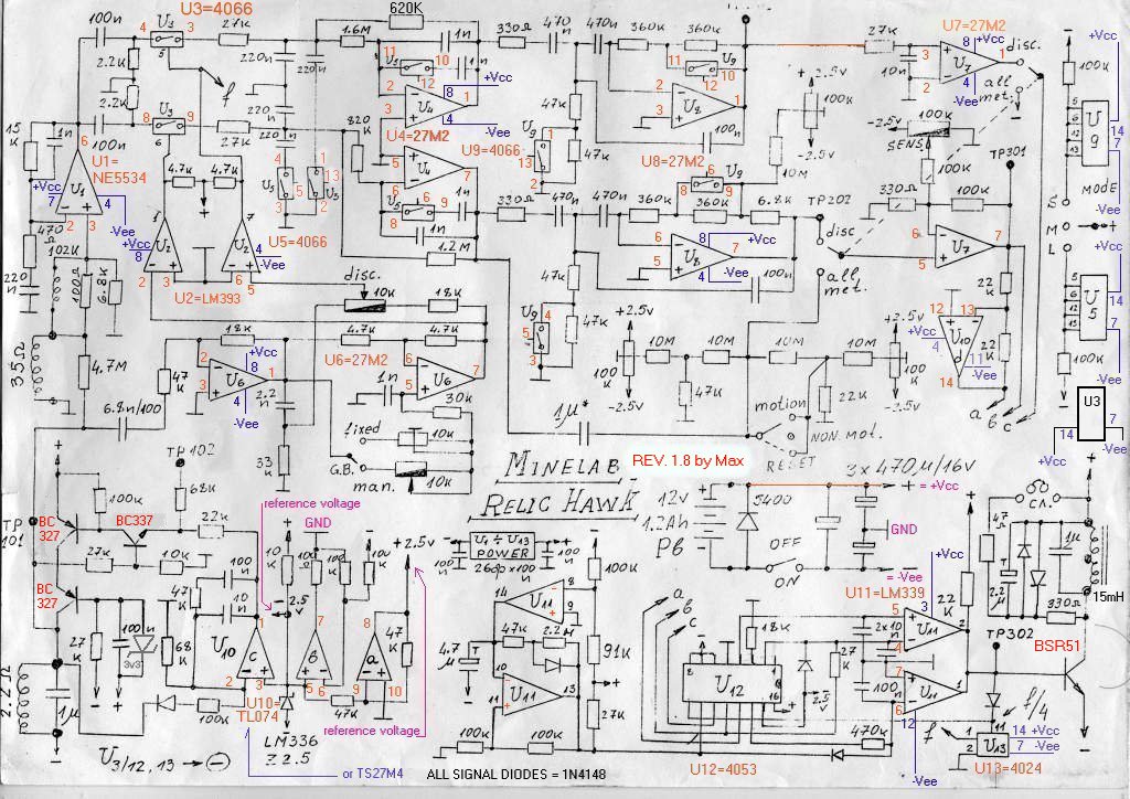

            • Hi,
              some wire arrived ...so I've made a new TX coil with 0.56mm diameter (bare) wire... and 3.5ohm resistance... to try if works now, with mods on transistors... and it works, I mean, oscillator runs good BUT this just using BC337, BC327 there.
              (btw also my old 0.50mm coil works now with them in oscillator)
              Unfortunately frequency I've got is not as required but lower... but this is unimportant in thoughts about oscillator startup.
              So, the problem at oscillator we can consided as solved. So I'm updating schematic with new labels for transistors as required.
              Here revision 1.8.
              Kind regards,
              Max
              • bulgarian RH schematic again
                I've spotted another difference between this (complete?) schematic and the bulgarian version called "relic hawk I", look at "f" point... that goes to pin1 of 4024...
                don't you notice anything different ???
                The 4024 gets its clock from geb/all-metal control signal, but in our RH schematic the "f" is at disc gate control signal...
                So... someone could say... ok , it's always 5Khz there...
                Sure... but I don't think is the same getting clock at 90° more or less ? Do you ?
                In an extraordinary hi gain device...like THIS IS... that 90° could make lot of differences...

                  Well done Max,
                  This is an interesting difference,mostly with he discrimination problem .You just have to connect F to pin 6 instead of 5 of 4066.
                  BTW, the bulgarian version pin7 of 4066 is wrong, should be 8.
                  regards,
                  Fred.

                      • the "f" line...and detector behaviour
                        this post to explain what I realized from getting the "f" from the geb control signal:
                        detector is more quiet...than before...
                        Also, before I made that change the movements on disc pot, even in all-metal mode, gave variations in random chatters and the like...
                        Now what I think:
                        have no sense to me using the disc path to get the "f" signal... cause the disc pot rotation change the phase of that signal respect to the transmit signal at TX coil, that's reference.
                        Have much more sense to me that the "f" is get from geb path, instead, cause once you tuned device on soil you'll not touch the knob anymore, unless you change soil (e.g. move far apart in the field, that require new geb fine tuning): this is expecially true when using disc mode... where you're expected to move the disc pot... thus resulting , as in schematic we follow, in a variation of the phase at every disc pot movement that could imbalance detector and cause erratic behaviour.
                        My conclusion is... people who made the bulgarian schematic on page1 know about the exact connection of the "f" line, so they followed that scheme. People who made the complete schematic probably don't know or mistaken about the "f" line connection... or intentionally faked schematic there. I don't belive ML could have made such a stupid mistake connecting the "f" at disc control signal.
                        What do you think ?

                          I agree. But since you are going to move the souce of 'f', why not source it from U6 pin 1? That way no changes to GEB or DISC will have an affect.

                            yes, good observation... but you probably forget a thing... I think ML put the line there cause of a reason:
                            do not interfere much with true signal path and give compatible signals where required
                            Let me explain... I think that if you bind the "f" there... so connect the pin1 of 4024 with pin1 of U6 you'll get troubles...
                            Why ? Simple, the 4024 expect a CMOS input level there.
                            You actually don't know which voltage there is at pin1 of U6... cause depends on TX coil voltage... but it's really difficault you get there a CMOS compatible level of voltages... so it's like playing dice there... sometimes could work... but it's unreliable unless you pay attention on that voltage... if don't use a level shifter etc
                            So, the actually made the easy way: used a comparator that acts as level shifter and it's triggered at zero crossing. This is a truly safe way of doing it.

                                However you want to do it, but the output at u6 pin 1 is at cmos compatible level, < +- 5.5V (actually it is about 5-6 vpp).
