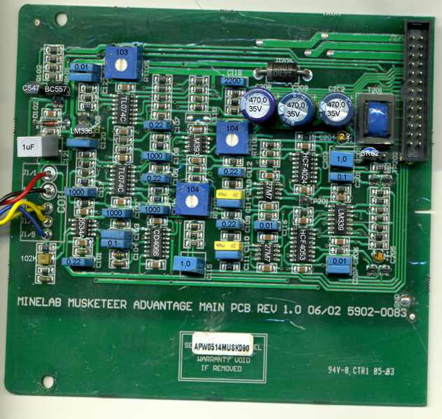

Hi tiktak, can you share your Sprint Layout file of Relic Hawk.
So this way we can try to help.

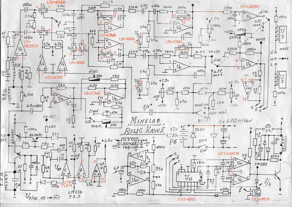

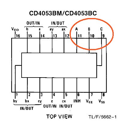

No guys... the a,b,c (lowercase on schematics) I think ARE NOT referring to the datasheet letters assignment for 4053... but are just shortcuts the schematic author put there to say... this point connects there where there's same letter... thus leading to a big confusion.
