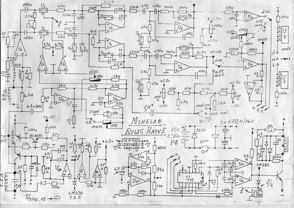

        Unregistered schematics direct link is
        http://www.snimka.bg/album.php?album_id=240227
        Erol

          Hi
          Because most of ICs are with unknown values?!??
          U............?But what are they?
            This will help much to compare and resolve misty parts...

            I think a bit interesting stuff is the temp compensated voltage reference: LM336-2.5
            It's something that is there to mean "you need a stable voltage here"... and often something that in "common" MD you don't see. Seems that the stability issue is related to stability of that reference over temperature... and that's nice cause one could even find better solutions today, though a bit expensive... but if the purpose is making one clone... I see no problems at all.
            Other interesting stuff is related to TX section...
            Ivconic you used RH much as far I remember... what do you think of non-motion mode in it ? Is it superb for you or not ?

              took a look at it more deeply... please correct me if I'm wrong...A,B,C are tone ID signals used to control audio stage (well... frequency of tone generated I think depending on target composition).
              The modes controls the time constants of integrators giving a preset for each mode to suit user needs: slow, medium and L ??? L means "large" maybe (widescan)... referring to sweep lenght at more speed ?
              Uhm... I think the misterious parts need effectively some deeper understanding... but we are on the way ???
              I think also... the first sampler stuff is about like in TGS, two channels about 90° one each other...
              What do you think?

                The S M L is switch wich changes the searching mode S-small ithems;M-medium ithems;L-large ithems.
                This is what I now.But more interesting for me is fixed GEB!

                  yes probably is like you said... I confused things... but it's about same stuff reversed: at L device is slower, so can catch deeper and larger targets... and at S is faster so can catch small things at few depth.

                    yes,maybe you are right.I am cnfused looking only the schematic.
                    Can anyone make PCB?According original schema?Max can you see any purpused facked parts?
