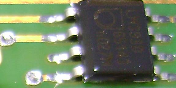

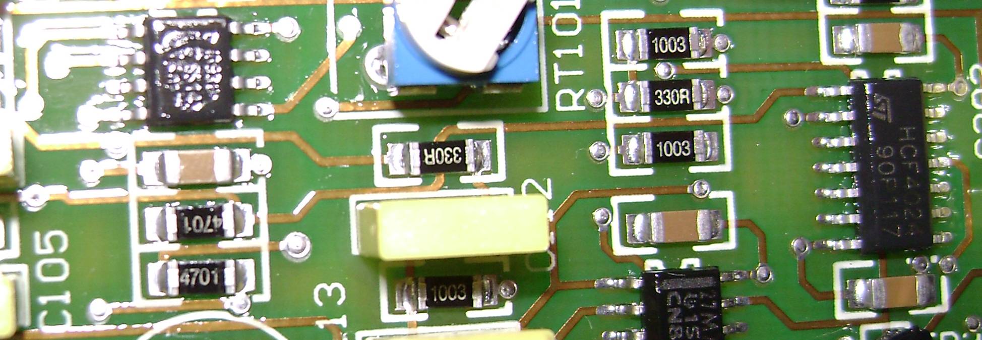

      Eclipse,can you make two better pictures from the total board,top and bottum side or can you trace the F line ?It is hard to do with this pictures.Grt Nakky.
      Hi Nakky,
      I think you found it.
      I was following it... just under the smd resistor there and found your post that let me think you found it already.
      Now we have to consider the 2nd comparator inside there... and look about where signal came from.
      I mean... we have to look for disc or geb related control signal.
      Kind regards,
      Max

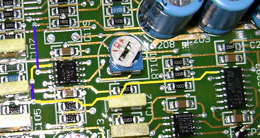

      • Max,look at this.
        • Hi,
          I think the mistery is solved now.
          The "f" goes to pin5 of an LM393, then the pin6 ...where's inverting input goes to a 18K resistor: it's GEB control line, cause just GEB comparator take input at that 18K = out pin of previous op amp (U6 on our schematic).
          So Minelab bind "f" line at GEB control signal, not on DISC as we have in our schematic.
          Do you agree ?
          If ok and no questions I will put in next revision.
          Kind regards,
          Max

            • Hi Max,
              Yes we can say for sure that it goes to pin 1 of 393, so there was a mistake when shematic was traced pin 5 and 6 were mixed, wich is very easy to happen.
              Nice team work, an congrats to Max who found this before.
              In fact the "problem" with ferrite looks like a proof that it really works,thanks to the manual.
              Fred,still waiting for parts
                Hi Max,

                • I can't see it ,is it pin 5 or pin1 ?
                  • Originally posted by nakky View Post
                    Hi nakky
                    If you look carefully you will see the "9" of lm393 so you know the position.
                    You can also see the notch designed in white below the IC.
                    regards,
                    Fred.
                      Where the f goes ? now I think it's pin1 for me... but maybe not
                      if not... then is pin5.
                      It's not really a problem... let me explain:
                      if is pin5 then the input is at pin6 (inverting) and goes to 18K
                      if is pin1 then the input is at pin2 (inverting) and goes to 18K
                      both ways the comparator inside see 18K at its invertin pin... that's what we are looking for to say it's GEB related.
                      BTW, Fred is right, I agree on the 9 and notch.
                      Kind regards,
                      Max
