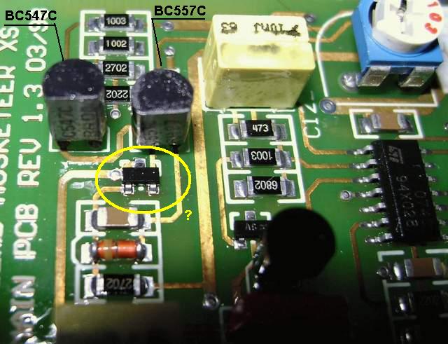

              • Musketeer and Rh are very simillar. Thus Musketeer could be adopted as lite version of RH. Working frequncy is 7kHz and at RH iz 5kHz.
                90% of designs are identical.
                So...look at output stage, there are BC547C and BC557c with that unknown transistor.
                Bulgarians did not deciphered it and than used BC337/327 combination on their Coinseeker 2 Pro.
                Few days ago i got brand new Coinseeker 2Pro pcb with all components soldered. It is not working? Dead!? I tested it with original RH coil.Not oscillating. Power drain is 20mA? Nothing warm or burns. No oscillations....
                Powers supply lines are ok. Everything seems to be good. Yet not working.
                So...my doubts are still on those transistors....
                It is obvious that ordinary BC547C and BC557C can work there as far as last (smt) transistor is properly choosen.
                Instead using various other transistors and "push" this to work, i would rather rethink and decipher original smt transistor and find its eventual replacement.
                I also had Musketeer Colt in the past. And RH. Also inspected those pcbs...nothing strange nothing from Mars. Yet...these handamades refusing to work!?
                Sheesh!
                • This is not a transistor but diode, i checked it before when i had it.
                  The freq of the XS is the same as RH - 5Khz/15V

                    • Hi Ivconic,
                      this transistor or diode must have some number on it??
                      If the oscillator is working fine with a trnasistor,i wonder how it would do with a pair of diodes instead
                      Maybe if you take off the varnish you can see the reference.
                      Fred.
                              Sheesh!
                              Hi Ivconic,
                              it's the same problem I had... if you use a thicker wire coil you'll see it oscillate if everything is ok about circuit you have.
                              I think the transistor could be anything there... but we can expect will be a real problem identify it cause we don't have nothing more now that pictures... and there I see no label about it.
                              I think the best way to discover what is it is by smart handle analyzers... that could tell directly the transistor kind if connected to its leads... something woody.au made about sd2000 if I remember well... but I think the last test would need dismantling the piece from a board.
                              Probably it's something not so strange or unusual... maybe some BC827 smt version or BC807... something you can see in old TVs.
                                It is transistor not a diode! You checked something other!?
                                Maybe you forgot. Maybe you checked those 2 diodes in same case at audio output...
                                Think again..
                                I had Musketter Colt (older than XS) and its frequency was 7kHz. Do not ever have doubts in my words.
