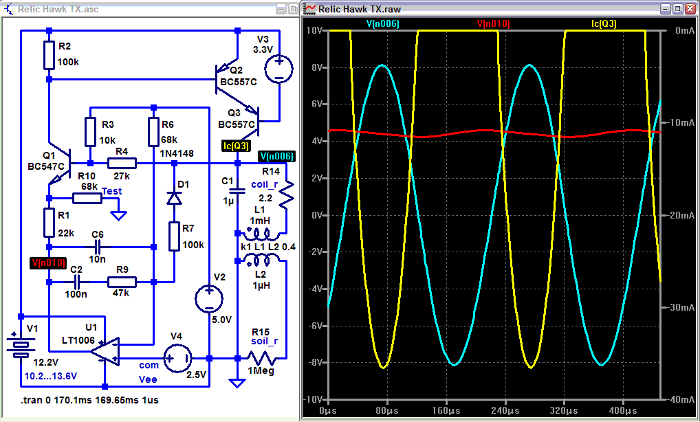

                • Eugene, I posted SPICE circuit for TX revision of Relic Hawk in a thread started by you:
                  Every familiar with SPICE can test and improve this incompetent designed TX.

                    Lately I can spend more time for the forum. I have time to explain for beginners how a hobbyist can design TXs, RXs and search heads for metal detectors.
                    What would happen if my future explanations and exercises in design are aimed at Minelab designers?
                    I don't know, but I know that it is unethical I to accuse of incompetence Minelab designers especially in a forum sponsored by Minelab. This may affect badly on the sponsorship of THUNTING.com forum. Guilty of this is Eugene, who started the above mentioned thread, knowing that the circuit digrams of Relic Hawk, Musketeer and Coinseeker Pro are bad designs.
                    To avoid adverse effects on that forum, I will continue here with several posts for ham designers called EXERCISES FOR BEGINNERS. Let we start to make revision and improvements of above mentioned circuit diagrams.
                    Here is the first exercise titled
                    ANALYSIS OF TX
                    SPICE analysis of TX was made in this thread several years ago, but not for beginners. For beginners, here is attached a compressed file ready for simulation. Every ham designer can download LTspice and open this file. The SPICE circuit of TX is made according posts of Max. His circuit is more convenient for simulation and design because LC tank is connected to SPICE ground.
                    Let we see how TX circuit works. Try to obtain the following picture.

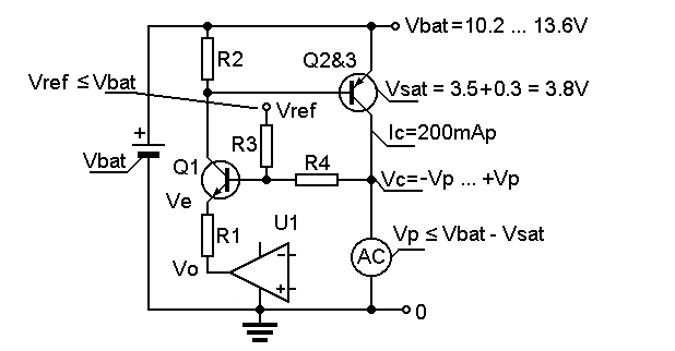

                          How to calculate the resistance of these 4 resistors?

                              WM6, I know that it works, but it is incompetent and incorrect designed. Its TX and RX sections will work better if we redesign them. I will post SPICE circuit of RX preamp to show that it also has drawbacs.
                              I use for simulation of TX a single supply opamp like LM358 and LM324, which operates better than 074 because have small value Vo_min (see post #927). If we remove transistor Q3 and all components forming voltage source V3, the TX starts to operate better until 10.2V battery discharge and with increased power. Please make the above SPICE analysis to see what happens when battery discharges from 12.2V with 0.1V only.
