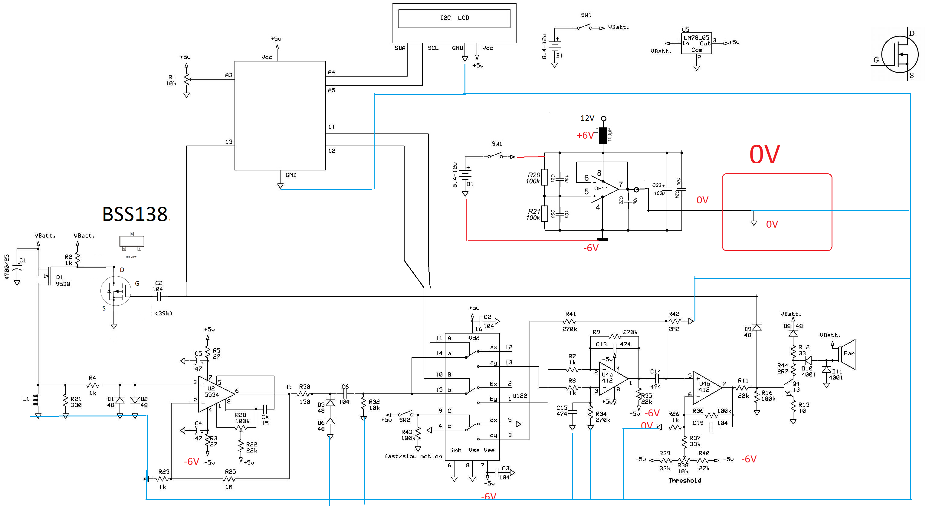

  • pito
    replied
    I have good results on IB VLF, just out of curiosity, I'm thinking about trying PI.
    I hesitate to do so because the PI detectors I've seen, for coins have a 50% shorter range.​
    Leave a comment:

  • pito
    replied
    The reduced range is due to mixing two channels. = instead of mixing we can calculate the magnitude and phase using stm32
    Leave a comment:
  • pito
    replied
    Circuit Modification First Step;
    blue line = power modification
    red line = can be replaced with stm32f103,
    Second step;
    green line = final modification​
