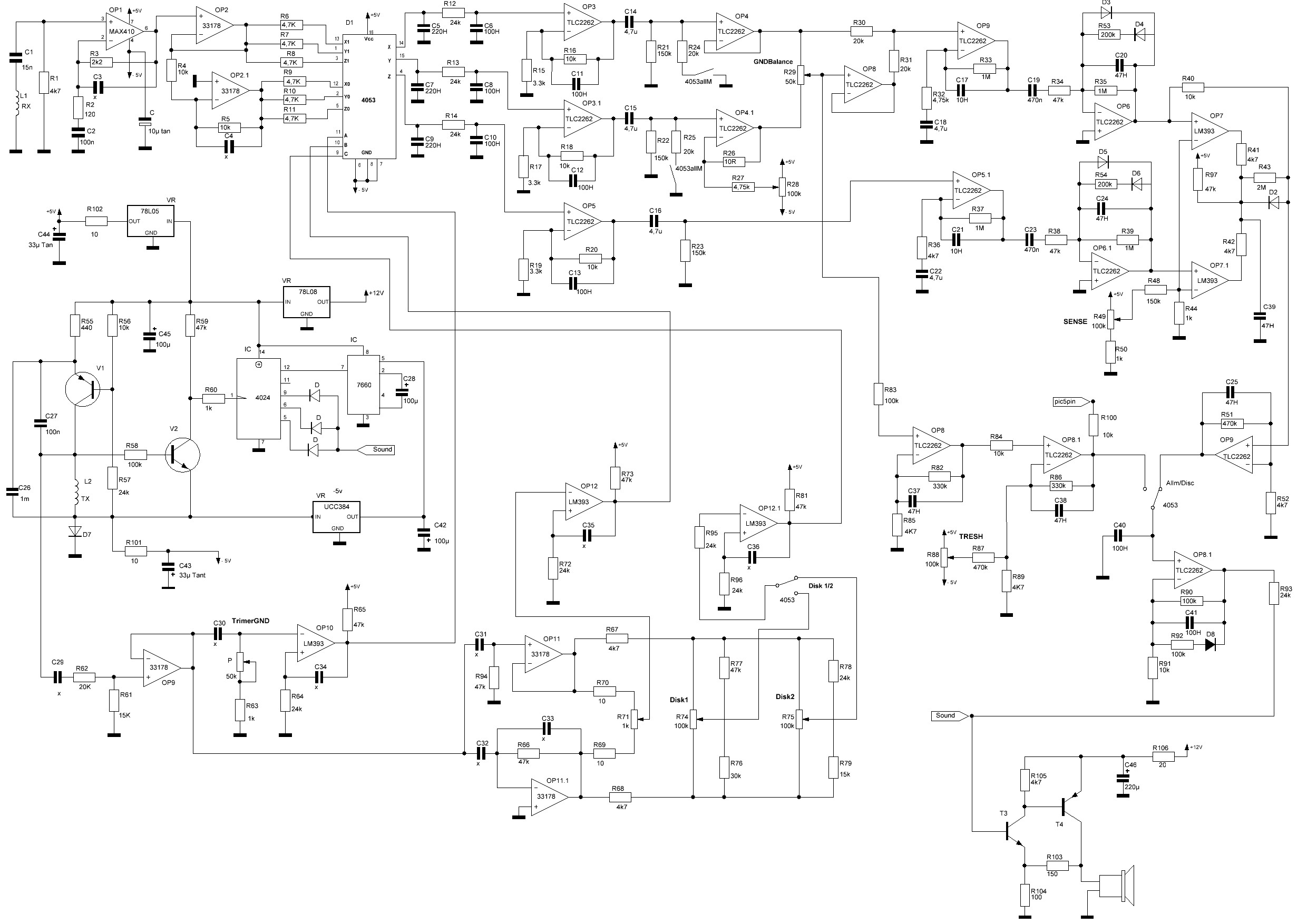

    Hello friends!
    This is almost the whole scheme of the analog part of Tejon. if
    anyone have information about missing values ​​of the capacitors let's share them.

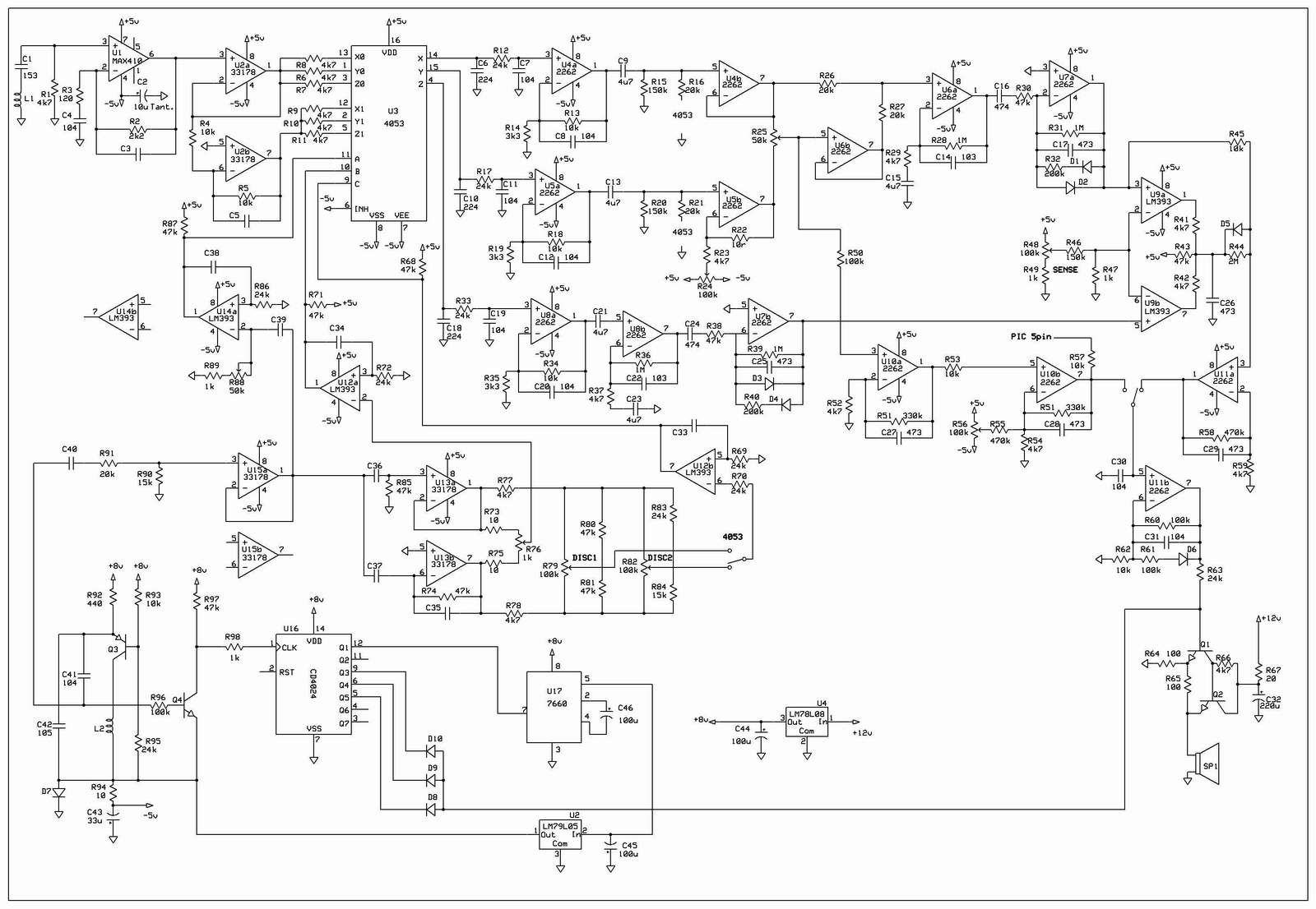

        Small additions and corrections schemes

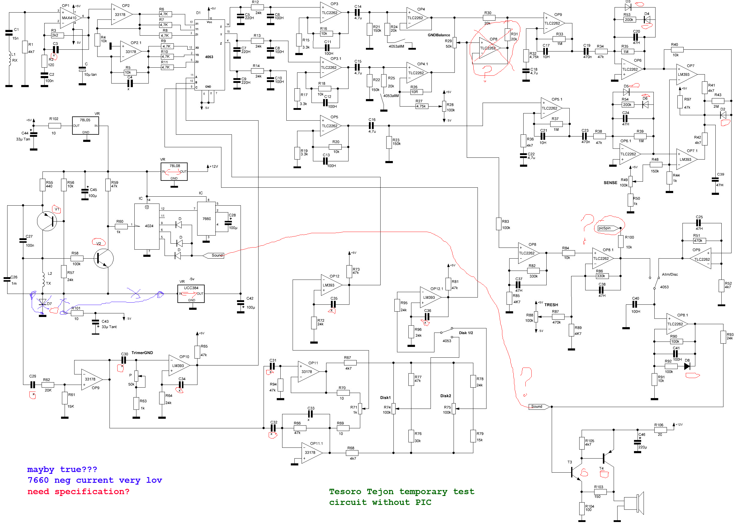

              This last scheme is fine? Free errors?
                The -5V regulator has IN and OUT swapped over.
                  78L08 too.
                    more?
                    about * capacitors?
                    What is the frequency of the device?
                    What type of coil used? Ring? DD?
                    What are the parameters of detection device?
                      see this! correct this!
                        I agree with the oscillator power supply problem, I don't think transistor V2 will feed +8V/-5V into the 4024 logic IC (powered off 0V and +8V). Diode D7 is probably shown correctly connected, to stop the -5V supply going positive. R55 won't be 440 ohms. The * value capacitors will be unmarked SMD ones, hence the lack of values on the schematic, they would mostly need removing to measure them. Is C4 even fitted? I would think it must be very small in value, else it would upset the operation of the phase detectors by adding a lag to the inverted signal. Presumably the opamps and comparators are powered from +/-5V?
                          transmitter sheet very similar in ELDORADO or LOBO
                          You can take the whole scheme of the transmitter by LOBO )))

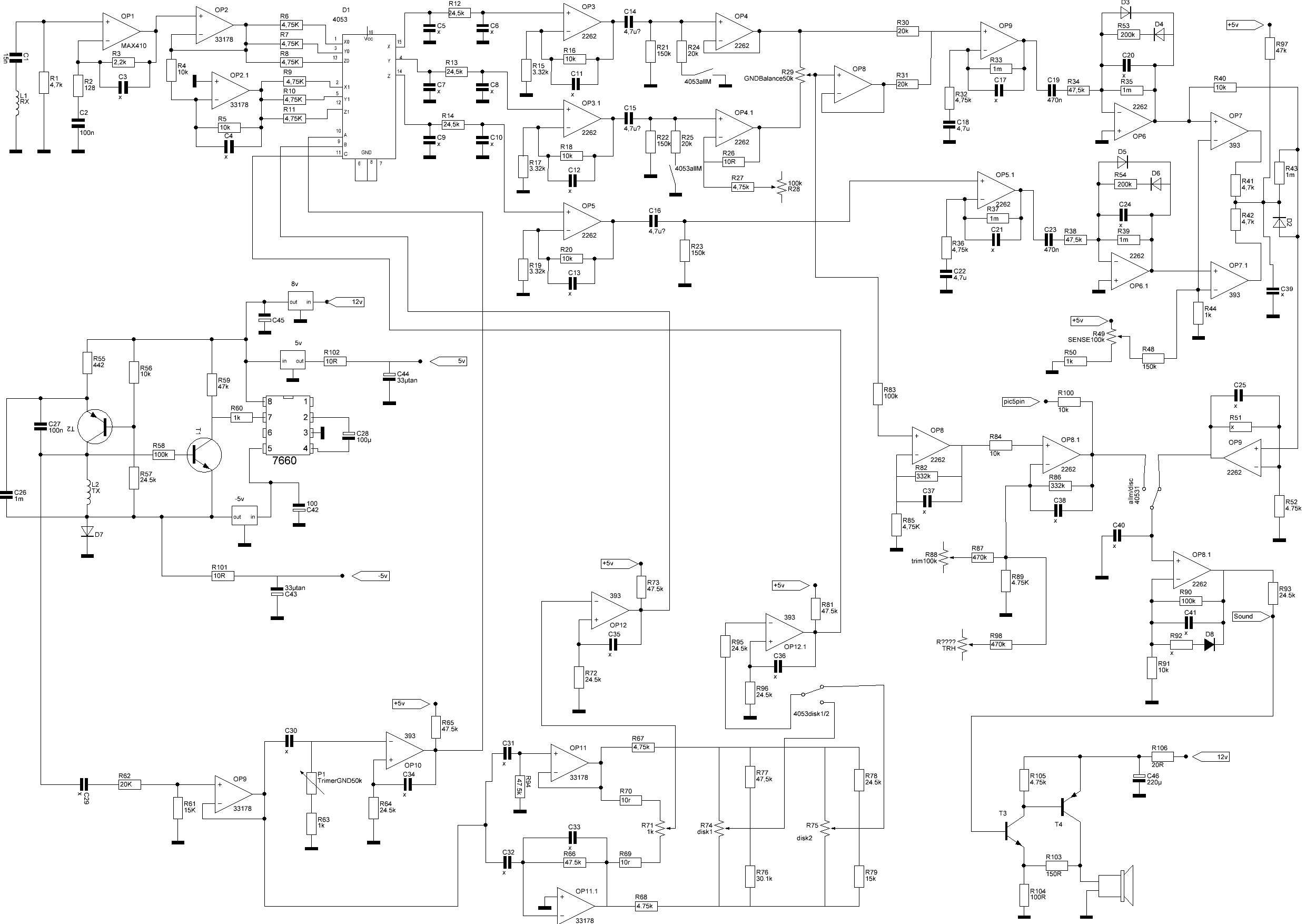

                              I transfered schematic into ExpressSCH.
                              Also i am giving here .sch file so it will be much easier to make further corrections and post them back here.
                              Yes there are several suspicious points in schematic. (for example: RST on 4024 should go to GND)
                              Need to be corrected.
