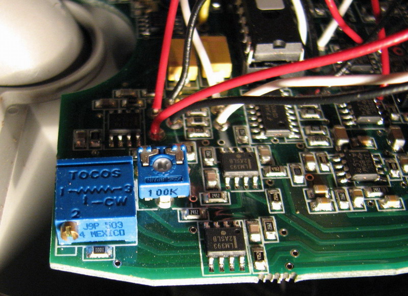

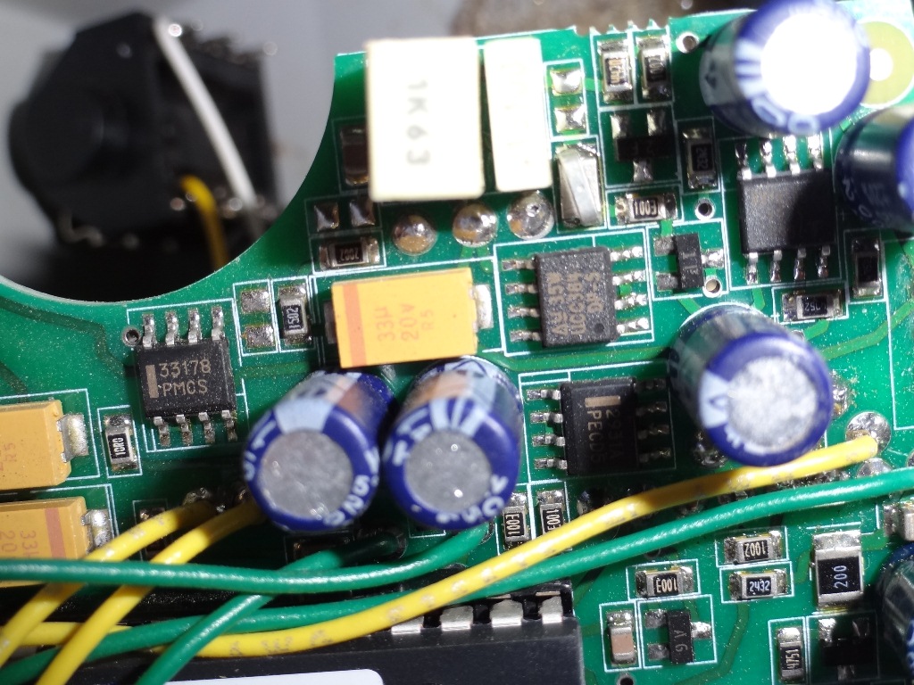

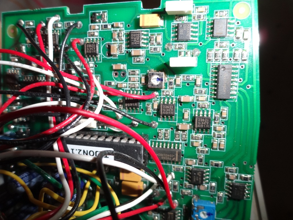

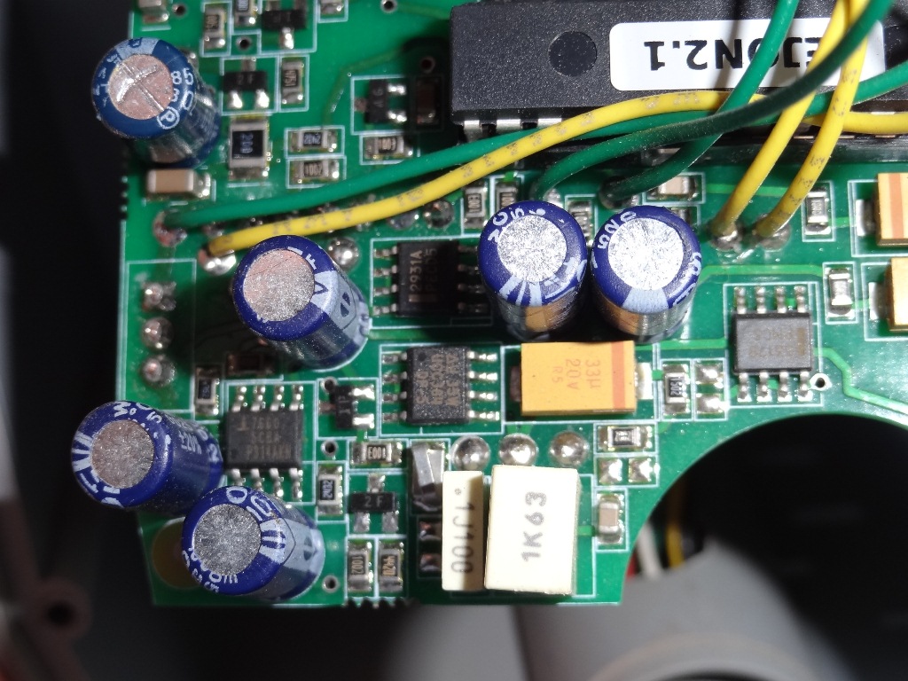

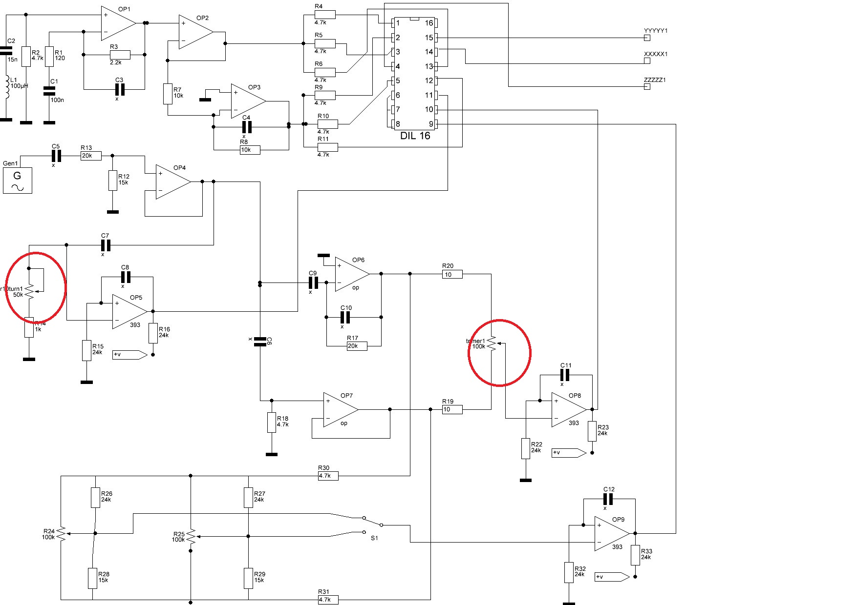

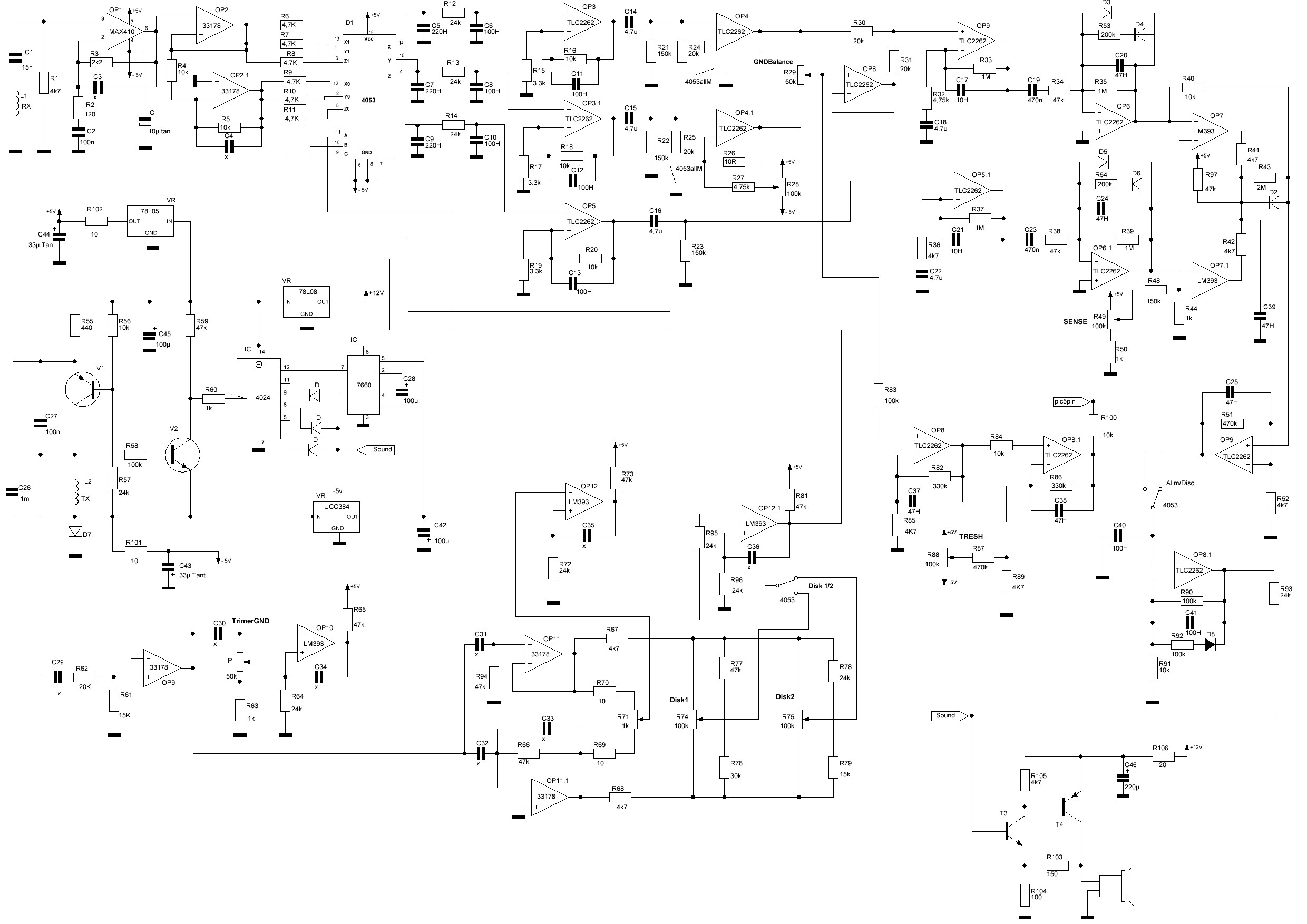

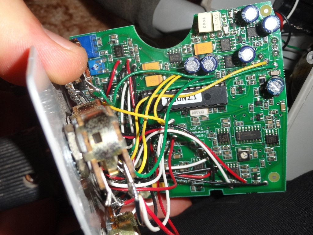

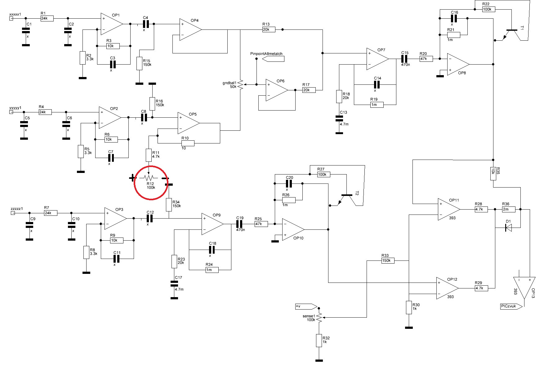

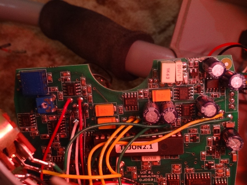

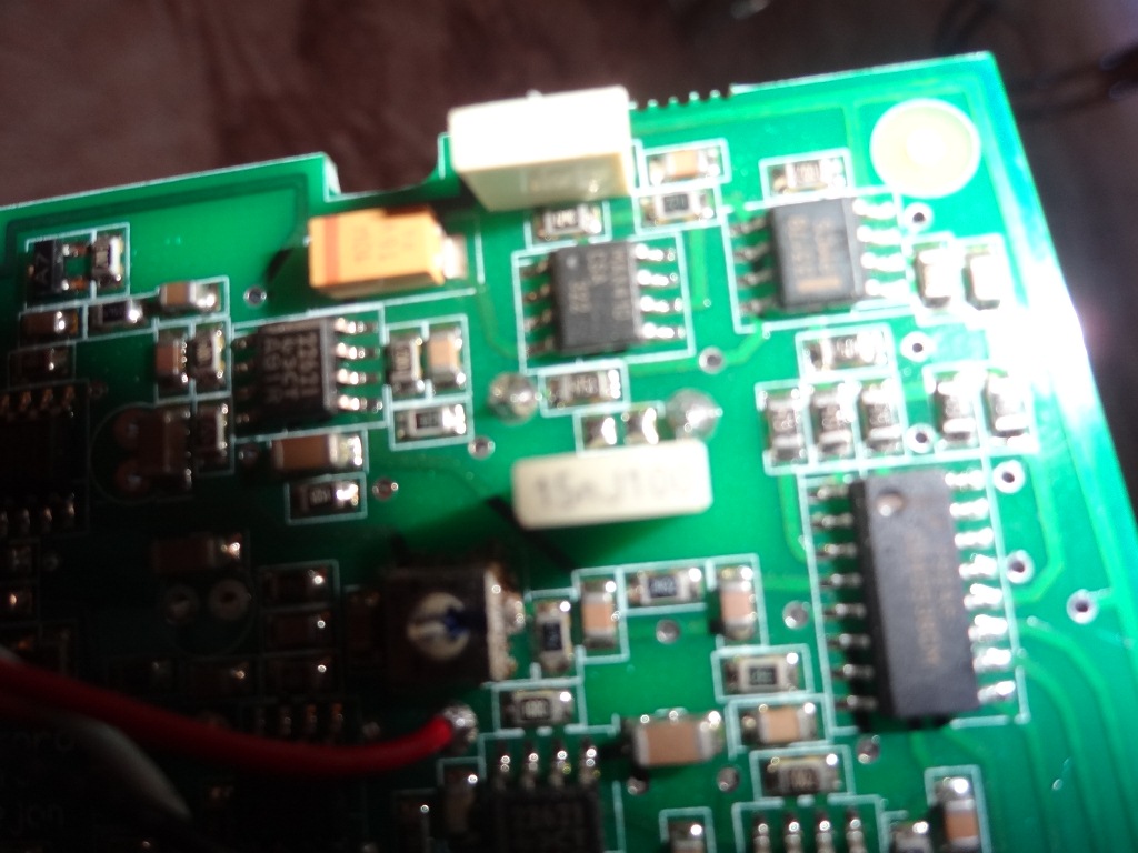

Thanks for the postet pictures !

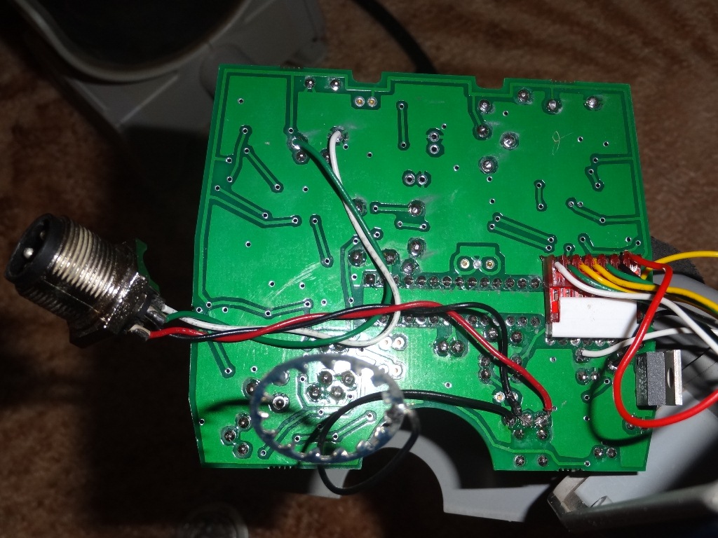

I have all postet pictures from the russian Board... but there is no schematic with the PIC Controller.
This schematic pictures is from a "analog rebuild schematic" ... At the Pictures from the PCB is not possible
to see, the connection from the PIC Controller to the other Parts.
I need the complete orig. Tejon schematic to make my own PCB. The PCB from the russian Board is wrong and not complete !
You can find Lobo M on the last page's on russian forum, complete pcb and schematic. Pcb is drawn in smd. Version is without PIC.Originally posted by daverave View Postwas there ever a true working schematic done of the tejon without any pic controller ??? did lobo also have a pic controller ???
It's on this page, also there is several video's about the same device.Originally posted by daverave View PostHi CDI...would you have the link for lobo M on russian forum...and also does it have the vco audio or just single tone ????

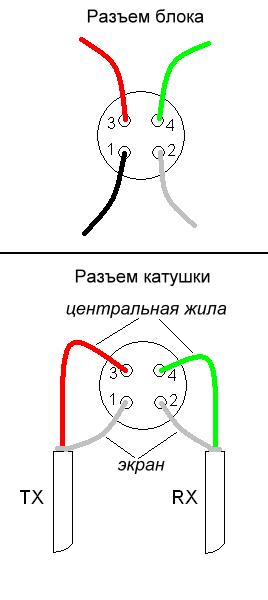

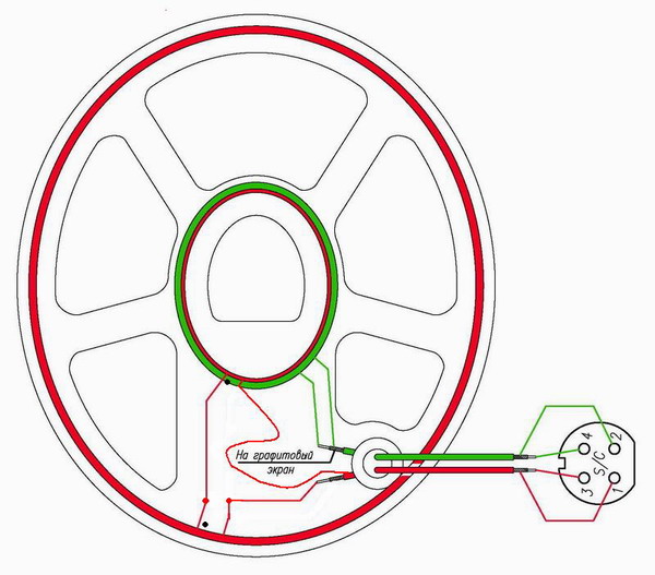

If i understand good, coil for Tejon can be adapted here.
Not sure about VCO mod.
