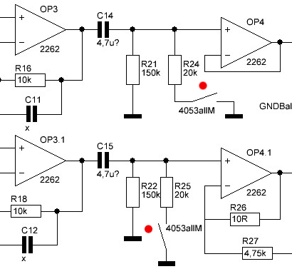

    The scheme is fundamentally correct. there may be some error in the values ​​of some of the capacitors. I personally remove any parts of the scheme but I had no "C" meter to measure capacitors
    • #62
      Doesn't the Tejon contain a micro-controller?
      If so, it's not shown in the schematic.
      • #63
        Yes, it does.
        IMHO, It's used to generate audio and maybe to control a 4053 chip ...
        Original design don't have no 4024.

          Pic is not need.Only lose VCO and variable tone.

            Have someone this Tejon bulid? This PCB works/correct?

              I am looking for all Tesoro Tejon Files for example PCB, Layout Files and Part List to build them! maybe in SMD too....
              Does anyone build a good working Tejon ??? so i need this PCB Layout
              • #67
                Good luck with that.
                I looked at the back-engineered design a few months ago and it appears to be full of errors.

                    It's the Russian back-engineered schematics that I looked at. The Tejon has a micro-controller inside, and it looks like someone has replaced the micro with analog electronics.
                    • #70
                      Firebox, make anything simpler this is my suggestion to you. Tejon is based on u-chip, maybe PIC one. do you have access to HEX to program the PIC? not. CAN you write the code yourself? NOT. so why you need in the complicicated schematic??? there are massive of CLEAR analog VLF schematics you may begin from now!

                          Have anyone build this Tejon? It´s this PCB correct and works proper?

                              PCB is not complete, missing some connections.
                              • #75
                                you may find PCB in RAR here http://www.md4u.ru/viewtopic.php?f=25&t=3056&start=250
                                vlaser makes...
                                PCB is wrong... Missing connections, and a few other connections are wrong !
                                Another problem, i can´t find a complet schematic with the PIC Controller
