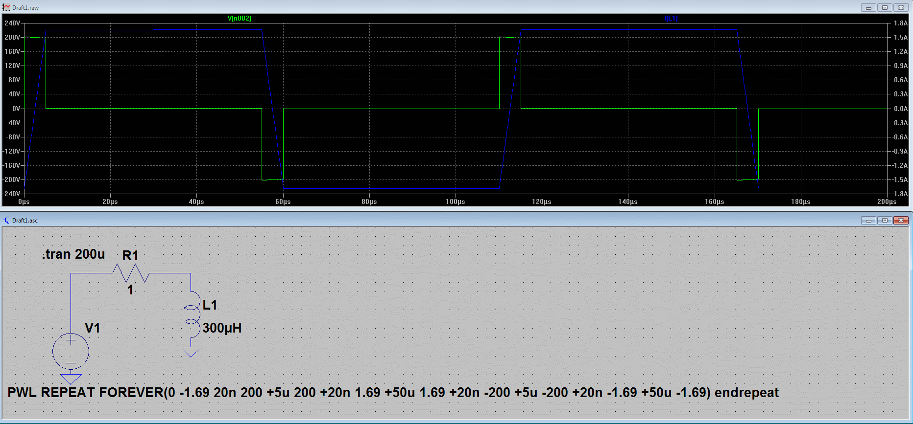

    Is it a PI or not?

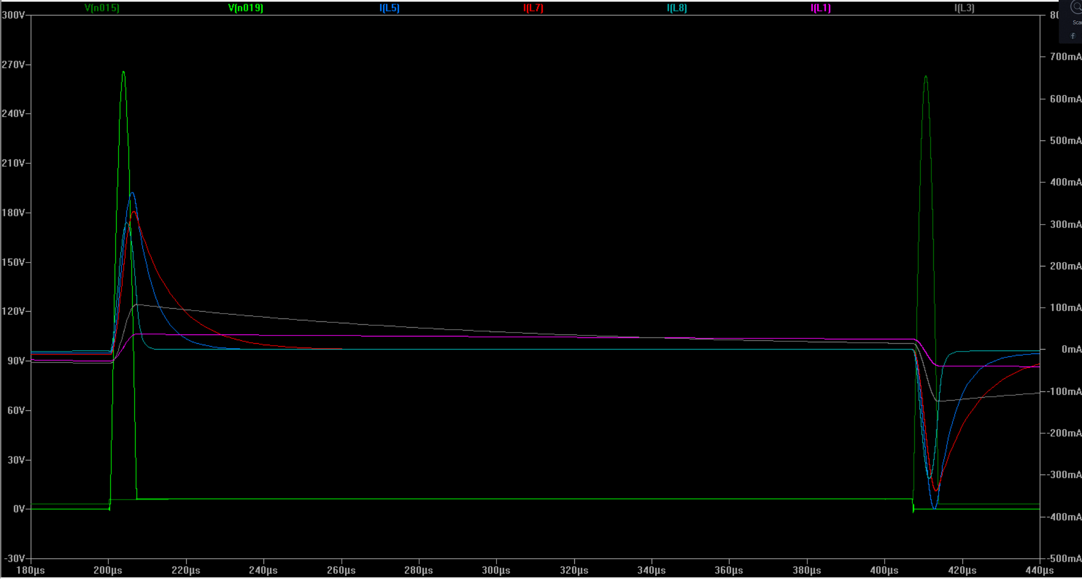

    The simulation shows Flyback at about 270V
    Target response:
    1=Tau 500us
    2= Tau 100us
    3= Tau 10us
    4=Tau 5us
    5=Tau 1us

          Is it a PI or not?
          Target response:
          1=Tau 500us
          2= Tau 100us
          3= Tau 10us
          4=Tau 5us
          5=Tau 1us
          Yes , the simulation looks real-like .... by the way , I already had watched such a pictures on my scope 2 years before this GPZ-7000 appeared

              Look at what I made in ~3 minutes. The current in between the spikes is forcibly constant by means of + and - 1.69V supplies. Either 1.69V or 200V sources must be regulated to maintain that current constant.

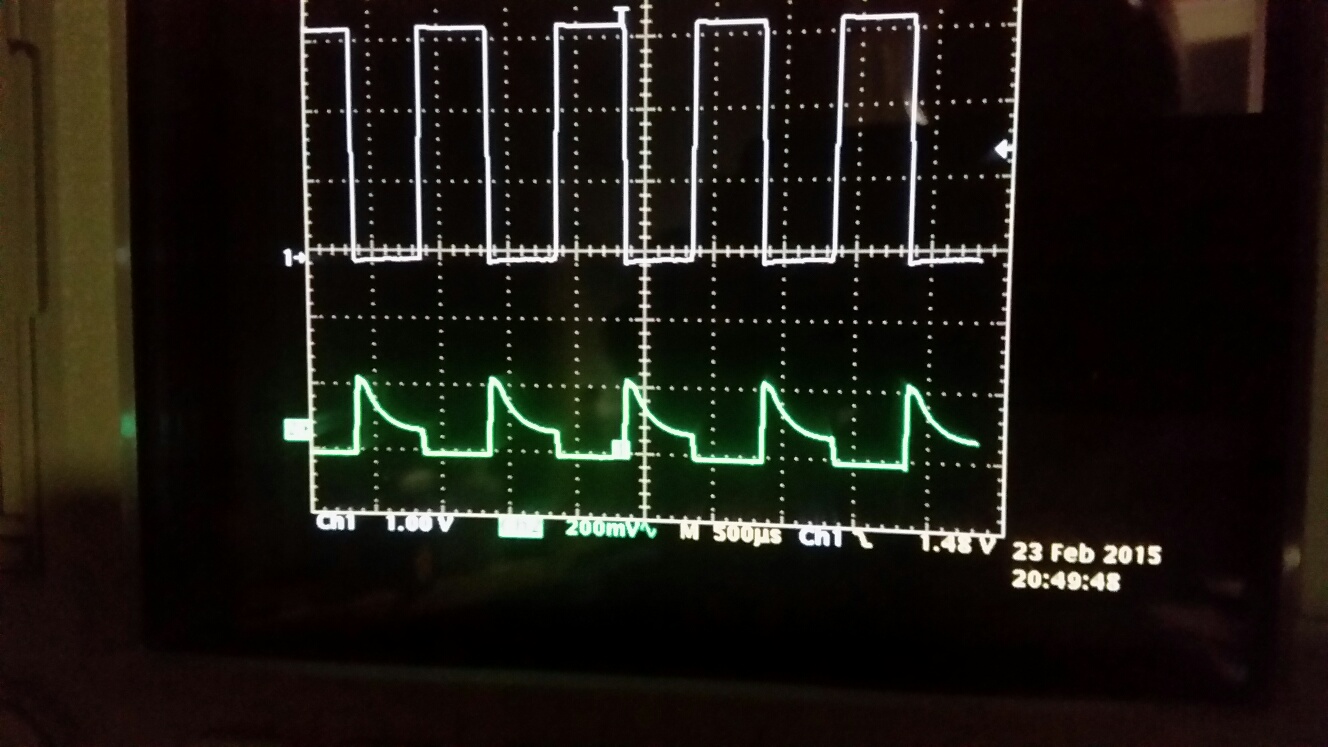

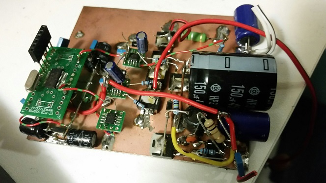

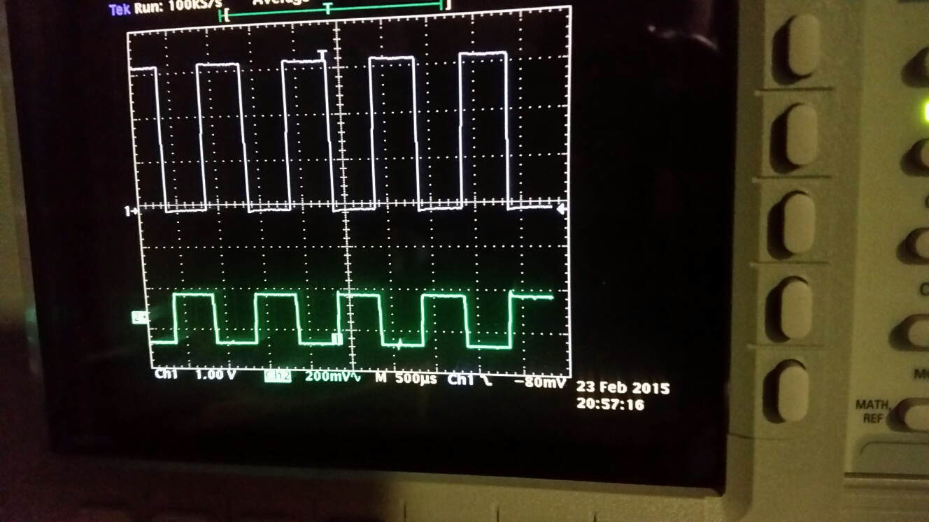

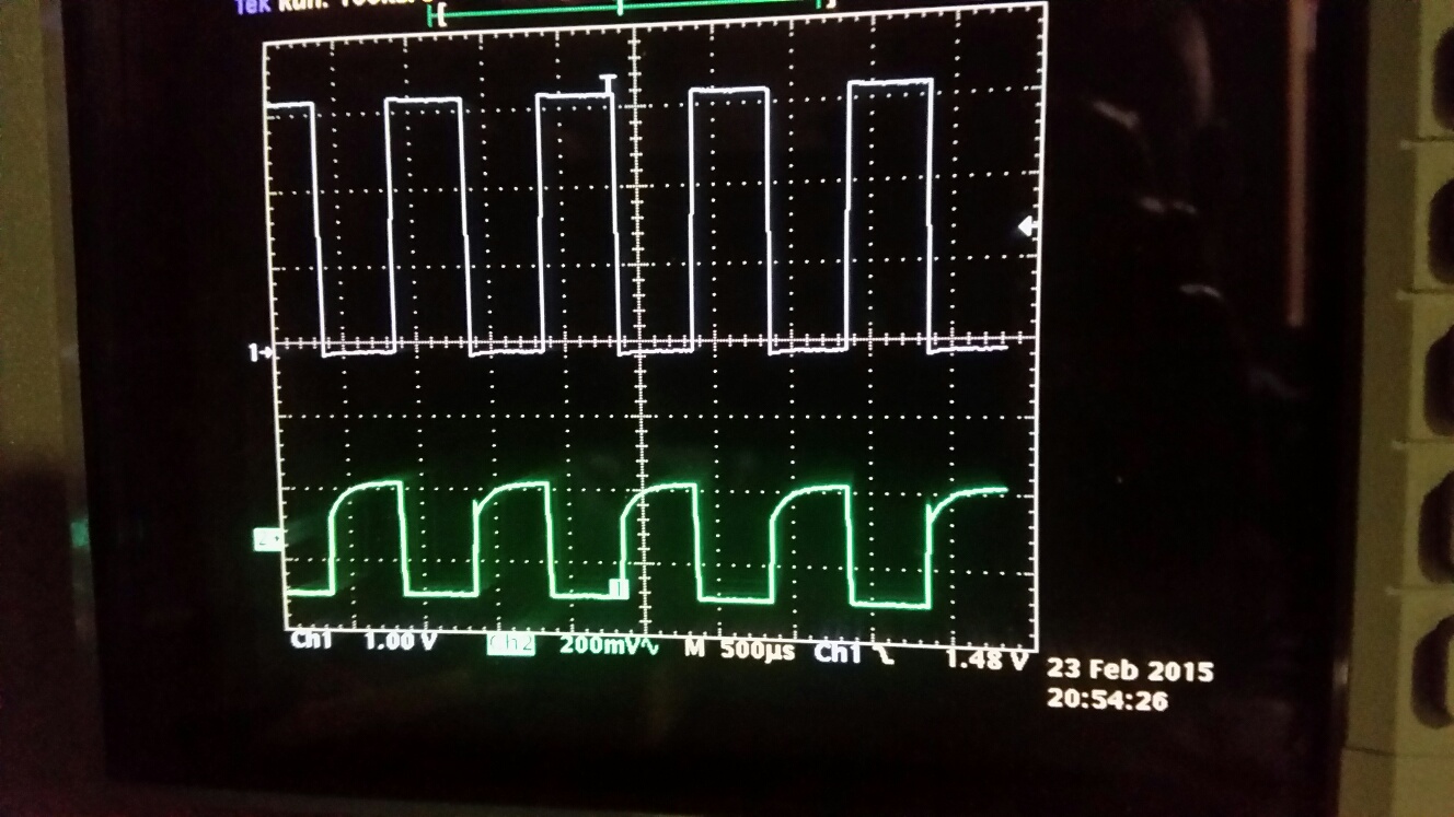

                  Here is an actual tx circuit ( built some months ago as a demo ) with auto "tilt" compensation based on US 4157579 ..
                  The green trace shows the effect of the tilt control on coil current too low , too high and just right. :-) .. there is no ringing and the current swings in the coil are 4.8 amps.
                      I'd be very surprised to see any ringing there. By PI criteria, the coil is terribly overdamped.
