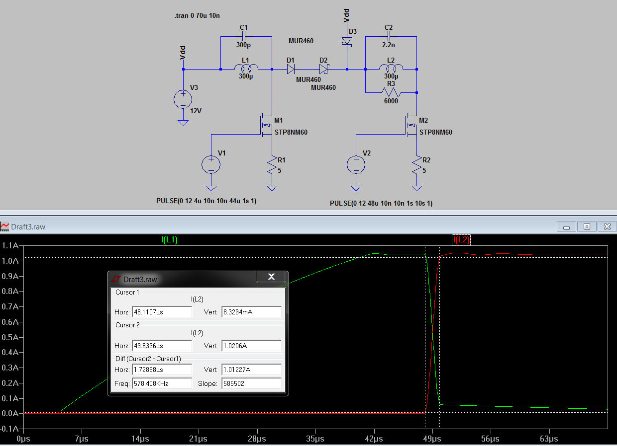

                • #83
                  In the chart above, L2 is the Tx coil and L1 is the auxilliary inductor. Rise time to 1A is a mere 300ns! that's a real kick to the target.

                      • #86
                        Yes but not only that, the GPZ 7000 also switches instantly, that is, the usual PI ramp-up is not there, the Tx current is reached very fast. To do this you need one of the following:
                        a) charge the Tx coil with the HV flyback of an auxilliar inductor (current source),
                        b) charge the Tx coil with a HV power source.
                        With any of these the Tx coil does not need a damping resistor, because once the coil reaches the desired I it stays there short circuited to a low impedance - recirculating (you can view it as being connected to a damping resistor of very low value).
                        Please can you post the LTSPICE files?
                        The forum accepts both zip and rar formats.
                        Thanks.
                        By the way, are you certain this is the method used in the GPZ 7000?

                        • #87

                          • #88
                            The relevant patent (I think) is this one -> Constant Current Metal Detector with Driven Transmit Coil
                            Yes, though it is concealed in the text it can be derived from some paragraphs, for example:
                            [0113] This is because, in this embodiment of the present invention, the transmit coil is driven at low impedance throughout the repeating transmit signal cycle without any damped decays immediately after the transition between the high-voltage period and the zero-voltage period.
                            The method they use is (b) in my former post (to charge the Tx coil with a high-voltage power source). The high-voltage source (+180V) is reference 55 (Fig. 1; paragraphs [0054] and [0066]). Higher voltage = faster charging of the coil. Next, once the desired I is achieved, they connect the coil to a low voltage-low impedante power source to hold the current. The key is always having the Tx coil in low impedance.
                            On paragraph [0059] they explain the details of such a power source. Instead of an auxilliary inductor, as in my simulation, they use a hv capacitor charged by a switch-mode power supply.
                            Cheers!
                            • #89
                              If your coil + other parasitic capacitances total a value of 2.2nF, you may as well throw it in the bin.
                              With this method, a bad coil is still highly usable, see simulation below:
                              L2 = Tx coil, 300uF and 2.2nF give a transient of 1.7us to 1A, which is not bad. R3 damps the ringing a bit.
