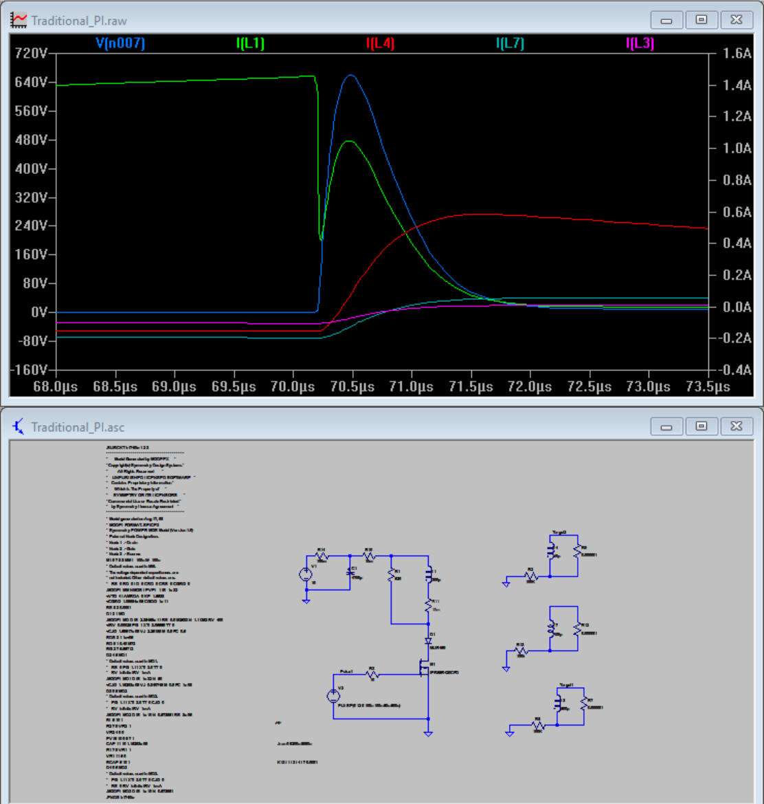

                            This is the TX and target response of a traditional PI.
                            The TX ON is 50us. This is better for short Tau targets. For long Tau targets it would be better using much longer TX times.
                            It could be interesting to compare the TX and target response of a GPZ 7000
                            • Originally posted by Tinkerer View Post
                              [ATTACH]33996[/ATTACH]
