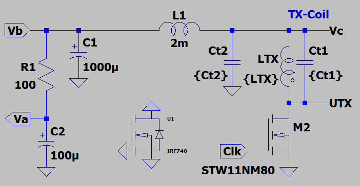

              This is the TEM2 transmitter I am thinking of:
              The capacitor Ct1 tunes the off-time period (high voltage high frequency response) and the Ct1+Ct2 the on-time (low voltage low frequency response). Parasitics don't taken into account. The AC voltage Vc will be taken for TX-side processing (a simple capacitor voltage divider is required to feed the signal into sound card input). It contains phase information (our reference), TX inductance change info, battery voltage detection and even diminishing supply voltage drift information. An All-in-one solution.
              Aziz

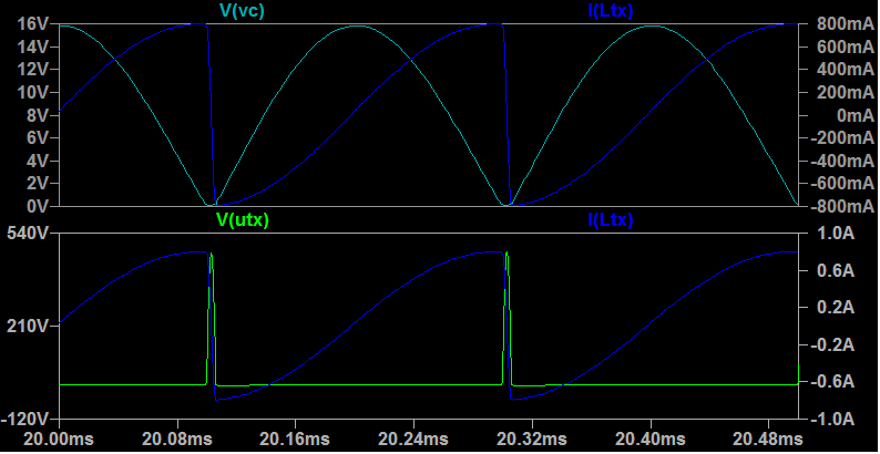

                  Hi all,
                  I did forget the voltage and current diagrams. Here it is:
                  Click image for larger version  Name:	TEM2 TX-UI.png Views:	0 Size:	23.0 KB ID:	444265
                  So the TX is resonating at two different frequencies. L (TX) and Ct1 forming the high frequency part. And L (TX) and Ct1+Ct2 forming the low frequency part. Only 1/2 period time long however. It is a sinusoid (or cosine) shape of course because it is a resonant circuit.
                  The pulse period ( T = 1/(pulse frequency) ) is divided into high frequency and low frequency part. The mosfet is switched on for the low frequency part and switched off for the high frequency part (flyback voltage part). So the mosfet is swithed on for the most of the time (coil energy recovery and coil charging mode). Current reversal happens during the switch-off period.
                  Ct1 is defined such, that the maximum voltage over coil should not exceed the avalanche voltage of the mosfet. And it is also determining the high frequency limit of the TX response.
                  The maximum voltage over the coil can be calculated easily by design process or simply use LTspice simulation.
                  Lets take 200 µs period time T (the pulse frequency is 5 kHz).
                  Let's define the off-period time with 5 µs and on-period time of 200-5 = 195 µs.
                  Let's assume we have 1 A maximum coil current at 1 mH TX coil inductance. So the coil current is swinging from +1 A down to -1 A (2 A span).
                  The expected voltage over coil is:
                  U = dI/dt * L * pi/2, where
                  dI = current span (delta I)
                  dt = time span (delta t, period of time for the current span change dI)
                  L = coil inductance
                  pi = 3.141592654
                  Let's take the values into the formula:
                  U(off): dI = 2 A, dt = 5 µs, L=1 mH
                  U(off) = (2 A / 5 µs) * (1 mH * pi / 2) = 628 V
                  U(on): dI = 2 A, dt = 195 µs, L=1 mH
                  U(on) = (2 A / 195 µs) * (1 mH * pi / 2) = 16.1 V
                  (Note: On the graph above, I have taken L=1.2 mH, T=200µs, dt (off) = 6.4 µs, I=+/- 0.8 A approx., Vb = 8*1.2 V = supply voltage).
                  The maximum coil current depends on supply voltage Vb, TX coil inductance L and pulse period T. Best making the design process in LTspice circuit simulation.
                  You usually define the pulse frequency first (and calculate the pulse period time T). Then define the off-time period with Ct1 (limitting max. flyback voltage and max. response frequency). Then define Ct2. It's optimal value is achieved, when the voltage at node Vc goes exactly to 0 V. This means, that the stored energy in the capacitor Ct2 is fully discharged. So fullfilling the exact 1/2 period of the low resonance frequency.
                  BTW, when dI/dt is constant (linear coil current ramp down or up), the voltage over coil would be U = dI/dt * L. As the coil current ramp down and up is 1/2 cosine or -cosine, the factor pi/2 comes into the calculation.
                  This is the TEM2. Simple but powerful.
                  Aziz
                  PS: The most important part of the TX circuit is of course the choke L1. It is fully decoupling the transmitter circuit from the power supply. Forgot this.
                    to be continued..
                    As the double tuned TEM is really critical tuned, any change of TX coil inductance will lead to change of voltage at node Vc. 1 % change of TX inductance will lead to 1 % change of voltage. Even more, if it is tuned different. Up to 1 % change seems quite low but enough for me to detect the changes and process it for a better ground balance procedure. Targets should not change the voltage as the ground effects really dominate.
                    We will see the so-called "DNA code" for the responses (frequency response). Then it is revealing itself how to process them. It's a simple math.
                    Aziz

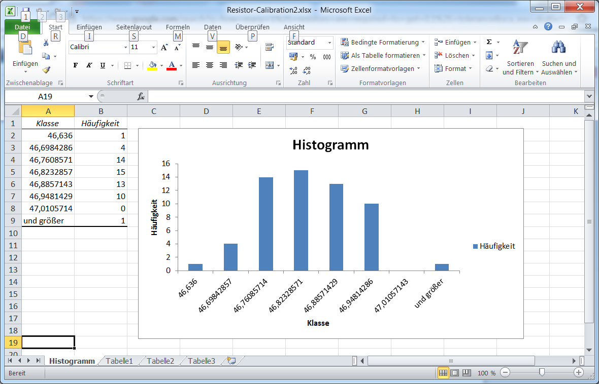

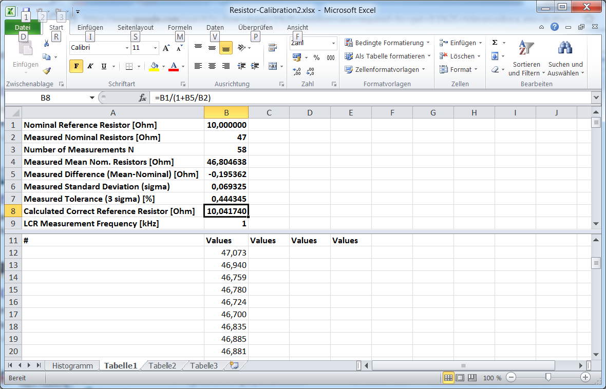

                        Hi all,
                        oh well, I can not find my precise resistor references (0.1% tolerance). Pity.
                        But I have managed using statistics calculation to calibrate my 10 Ohm reference resistor. I have found 58 47 Ohm resistors (all 1%) and have measured them with the uncalibrated 10 Ohm reference resistor. The measurement error has been calculated and I have corrected the value of my 10 Ohm reference resistor. It has obviously 10.042 Ohms. Looking at the histogram, it is acceptable and looks almost like a gaussian distribution. The accuracy of my sound card LCR meter should be enough I think.
