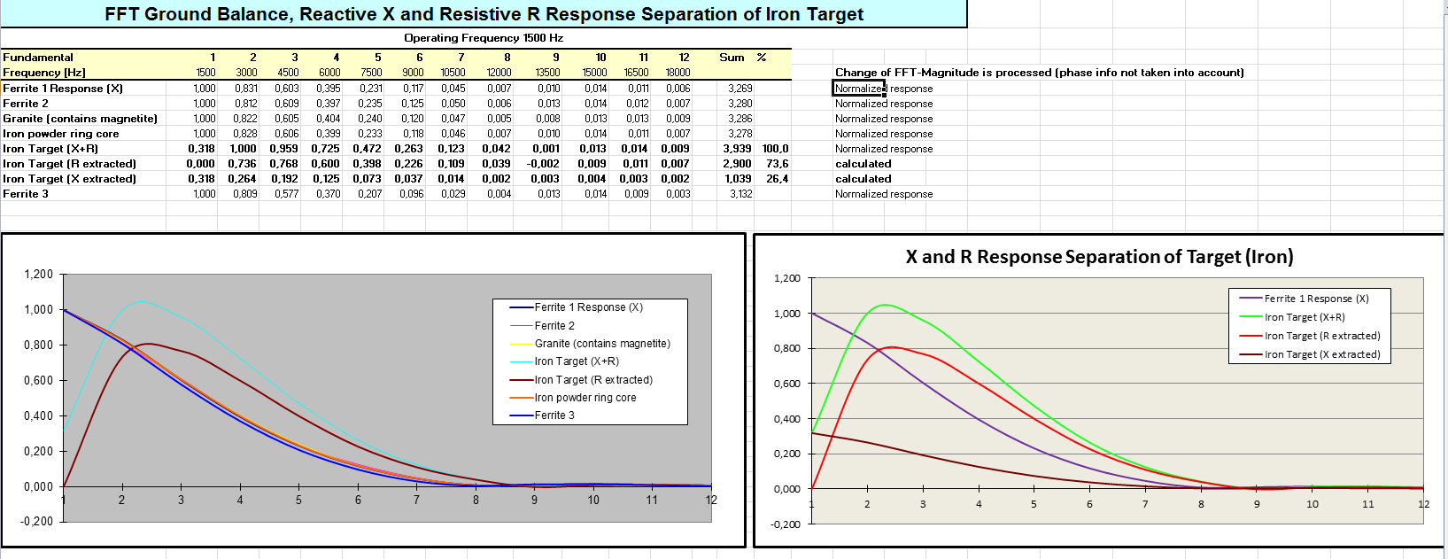

                Hi all,
                I did the iron response X and R separation many years ago. This was the part of the GB system in multi frequency analysis using only the FFT magnitude part. I have processed only the change of FFT magnitudes for frequencies up to 18 kHz. No phase info was required or was not available at that time (I had no reference from the TX coil).

                The typical pure X response (absent of any R-response) change curve in an IB system can be measured and normalized. You can see, that a mineralized ground has the most response at the lowest frequency. Targets may have higher response at higher frequencies depending on the TC of target. The special case iron produces both X and R. Now imagine, there is no iron in the ground but a gold nugget in high mineral ground. This will look like an iron target. And hence can not be really discriminated.
                Look at the Excel-Table, how I do the X/R - separation except for the fundamental frequency of 1500 Hz. I am assuming that the R-part of 1500 Hz response to be X-part too. So assuming all response of 1500 Hz is X response. Then calculating according to the pure normalized X-response the X and R part of the frequency. Integrating of the values gives the total X and R response.
                This is nothing different to solving the problem using the linear combination factors.
                Using only magnitude response will not solve the discrimination problem. You never know, whether there is iron on mild ground or gold nugget in mineralized ground.
                Note, that VRM effects and conducting grounds (salty ground) can not be solved as well. They will look like R-response. So you have to additionally manually ground balance too.
                Aziz
                  to be continued..
                  That's the reason for, why I am looking at response regions, where the X-response dominates over R-response. The X/R-separation will lose less target response. It's a GB subtraction method.
                  In the IB system measurement above, which is heavy band limitted to old sound cards (48 kHz SR) and TX response band width limitted too, I have the biggest X-response at the pulse frequency (1500 Hz) with lowest R-response in relation.
                  Pure R response has distinct frequency response. Once you have removed the X-part from the signal, the R-part remains.
                  And this could be a gold nugget in high mineral ground or iron in mild ground.
                  PS: The signal frequency response (curve) need not to be normalized of course. Plain signal frequency response change out of the RX coil.

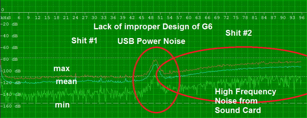

                            Hi all,
                            this is what makes me disappointing about the Creative's engineers on my G6:
                            Sh!t #1: Improper EMI filtering on USB bus power. All frequency spectrum concerning this issue.
                            Sh!t #2: The sound card is producing too much noise in the upper half of the frequency response.
                            This is after they low-pass filtering the analog input frond-end to hide their inability.
                            I for one would fire the analog engineers there.
