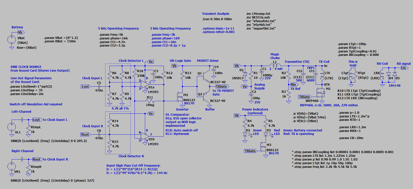

    Hi all,
    this is the preliminary detector controller for my sound card test interface for multi-frequency IB-system measurements soon. Left and right sound card output channels control the pulse frequency and the switch-on/off timing of the mosfet defined by phase shifting one of the output channels. They are pure sine waves. Pulse duty cycle is adjustable between 0.5 and almost 1.0 (allways on). If both clock signals are not present or zero, the clock detectors should switch off the mosfet to avoid excessive power draining through the TX coil. Some hysteresis is required to increase the noise immunity and wild switchings. The mosfet switches off hard (fast) and switches on soft (slow). This is perfect for us and the clock detectors are implemented as NOR logic and inverted then for the mosfet-driver ( NOT NOR = OR logic). Analog part needs power supply filtering (R1, C2). Choke L1 keeps the excessive current flow out of the transmitter away from the battery source and analog part. But it passes small amount of current to compensate the whole transmitter losses.
    This is the whole transmitter. What about receiver? Do we need a receiver? No, we can plug an RX-coil with protection diodes to the input of the sound card. The other input will be used to process the TX reference signal. That's it to start with soon.
    Schematics:
    Click image for larger version  Name:	TEM2-Transmitter-Controller1.png Views:	0 Size:	97.2 KB ID:	444399
    Aziz

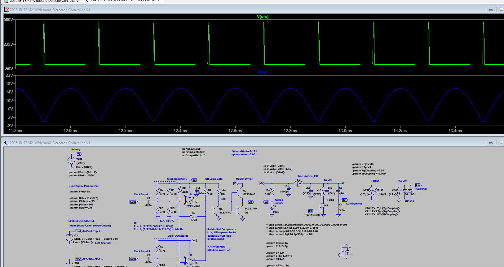

          Hey Aziz .. one side of your TX coil is all spiky and the other side is bouncing around like a yo-yo. Unless you integrate all the electronics in the coil head you cant really have that its not balanced.
          Ideally should have bipolar with one end grounded or symmetrical fully balanced.
            Hi Paul,
            I know, the transmitter isn't perfect. But it follows the KISS principle with minimum amount of parts and ease.
            That's not important to make some new measurements. I'm sure, you have the best bipolar rectangular transmitter available today.
            But I like the power efficiency of my design. And the ability to detect changing ground/target conditions on the TX side (effect less than 1%, typical less than 0.1%).
            But at least, I can check the battery voltage condition and take phase reference out of the transmitter if the expected effects are not big enough to process them.
            The TX will do enough I think. Unless you come up with a super-duper solution.
            Aziz
            PS: BTW, the TX coil current can be seen as bipolar current. It swings between + and - peaks. With different frequencies.

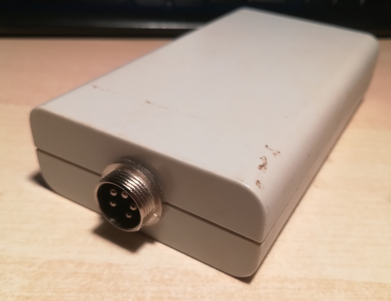

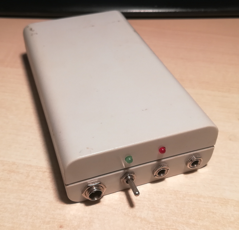

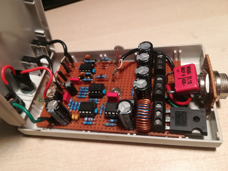

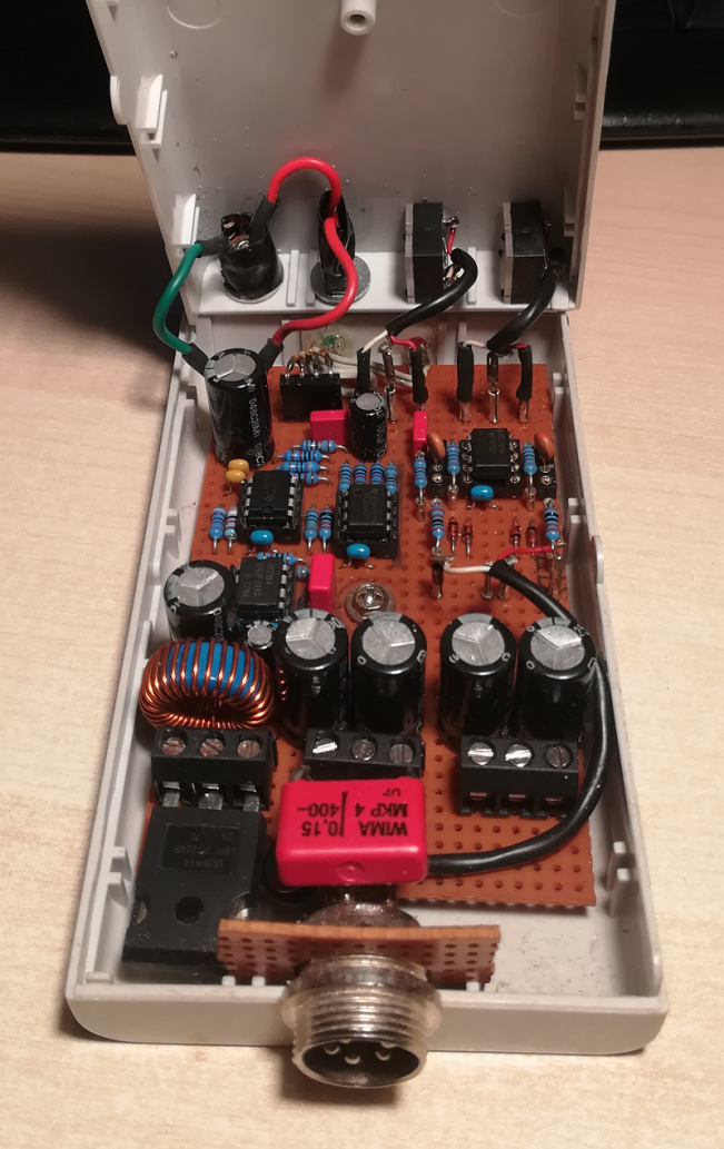

              Hi all,
              look what I have found. An early TEM (off-time tuned) detector controller. I don't want to modify the controller but I like the design. So the next published detector controller will look same with less parts in the box. Good for field testing moments.
              Aziz
                Hi all,
                the early detector controller uses obviously an half-bridge mosfet driver IR2184. I have obviously used the low-side part with single n-ch mosfet in this prototype (IRFP460, 500 V version). This prototype can be used for different configurations. But I don't know anymore for what.
                Modifying it makes no sense anymore. I'm going to build a new clean and simplified version based on the schematics published in this thread.
                I have realised, that there are many new n-ch mosfets with better specs available now. So the power efficiency can be increased further.
                Mosfet will stay cool. All parts will stay cool. And this is cool.
                Almost all of the battery power will be dissipated in the TX coil. The whole circuit will draw less than 0.5 W ( < 50 mA) at 9.6 V battery voltage (8 x 1.2 V NiMH cells).
                Small changes to the circuit are required. The capacitor voltage divider for the TX reference signal on the right input channel needs more capacitances due to input impedance of the sound card. I have increased the inductance of choke L1 to lower the ripple voltage at power supply. No, I have found a 5.4 mH choke in my part box.
                I have a big bag and boxes of parts to search for requied parts. Connectors, cables, housing, parts, soldering board, etc... I must have everything anywhere..
                Aziz

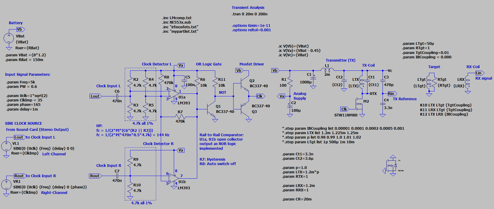

                      Hi all,
                      I have improved the TEM2 sound card detector controller now. This is the new schematics I am going to build soon:
                      Click image for larger version  Name:	TEM2-Transmitter-ControllerV1.1.png Views:	0 Size:	117.8 KB ID:	444519
                      I have decoupled the analog part from the rest of the circuit. So the mosfet switching timings should not be affected and clean. You can select either the 5 or 3 kHz operating frequency for circuit analysis (make one command and the other comment part). Below is the zipped LTspice circuit simulation files for your convenience.
                      My new USB hub came just.
                      Cheers

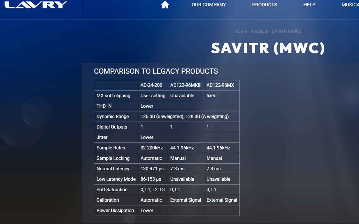

                          • #43
                            The real truth is always buried in the details.
                            If I take top model and its specifications as a reference; the first thing that catches my eye is the latency data, ha!
