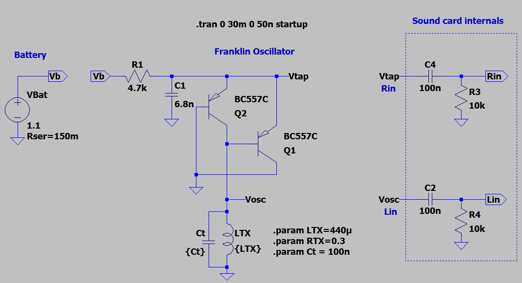

                      • #86
                        Hi all,
                        I was interested in the offf-resonance principle with a local LC oscillator. And how it is performing regard to noise generation and detection sensitivity. Want to check, whether the previous project makes sense or not.
                        This time, I'm using an ultra low power and ultra low voltage design. It is running from a single flat battery cell (0.7 .. 1 V). It's power consumption is approx. 140 µA.
                        The LC oscillator gives a nice sine wave form, which can be decoded on the left input channel of the sound card.
                        The right input channel is used as battery control. I'm already using flat batteries.
                        Well ok, this can be controlled up to the total battery flatness (approx. 0.7 V).
                        Below approx. 0.7 V, the oscillator stops running. This is the base-emitter voltage drop of the BJT transistor.
                        Just finished it. It's running.
                        Testing will be done next day or so.
                        Let's look, how much we can get out of the simple local LC oscillator.
                        The LC oscillator is a Franklin oscillator. Not well known type. But this is outperforming Hartley, Collpits, Clapp, .. It is known to be quite stable.
                        The circuit:
                        Cheers,
                        Aziz
                        • #87
                          Hi all,
                          I'm really really impressed.
                          This µPower free running LC oscillator in Off-Resonance mode works really good and nice.
                          I had to do a windowing to the samples to minimize the spectral leakage effect before decoding.
                          As the LC oscillator is running at its own frequency, I am not locked in to the signal to measure the faint amplitude changes.
                          So it locks in into the same signal. The reference is generated by the signal by phase shifting it 90 degree. Phase measurement is not important at the moment (it will be always 0 as I am locked in into the same signal).
                          SNR seems to be really good. At resonant frequency, the oscillator amplifies the EMI noise of course.
                          Frequency stability and change does not really matter. I am measurung pure its amplitude at any frequency.
                          The reactive response (X) is much lesser than resistive response (R).
                          Let's start the "hunger" games.
                          Increasing the impedance to the battery source so the amplitude change will be larger. Much larger.
                          Cheers,
                          Aziz
                          • #88
                            Hi all,
                            I am really impressed. It handles the X-response inherently very very well. Pure X-response is zero!
                            Only viscous remanent magnetic materials, which procude little R-response is detectable.
                            This can be realised by setting the detector threshold appropriate.
                            - No more ground balance issues (set the threshold for) !
                            - Mono coil design!
                            - Decent detection sensitivity!
                            - Simple detector! Simple DSP coding. Simple user handling. Simple ground balancing.
                            - Ultra low power! Single-cell battery (1.5 V, 3125 mAh) will last for more than two years! I'm going to put the 1.5 V battery into the detector housing.
                            I think I can optimize the detector further. Didn't do the changes yet.
                            Aziz
